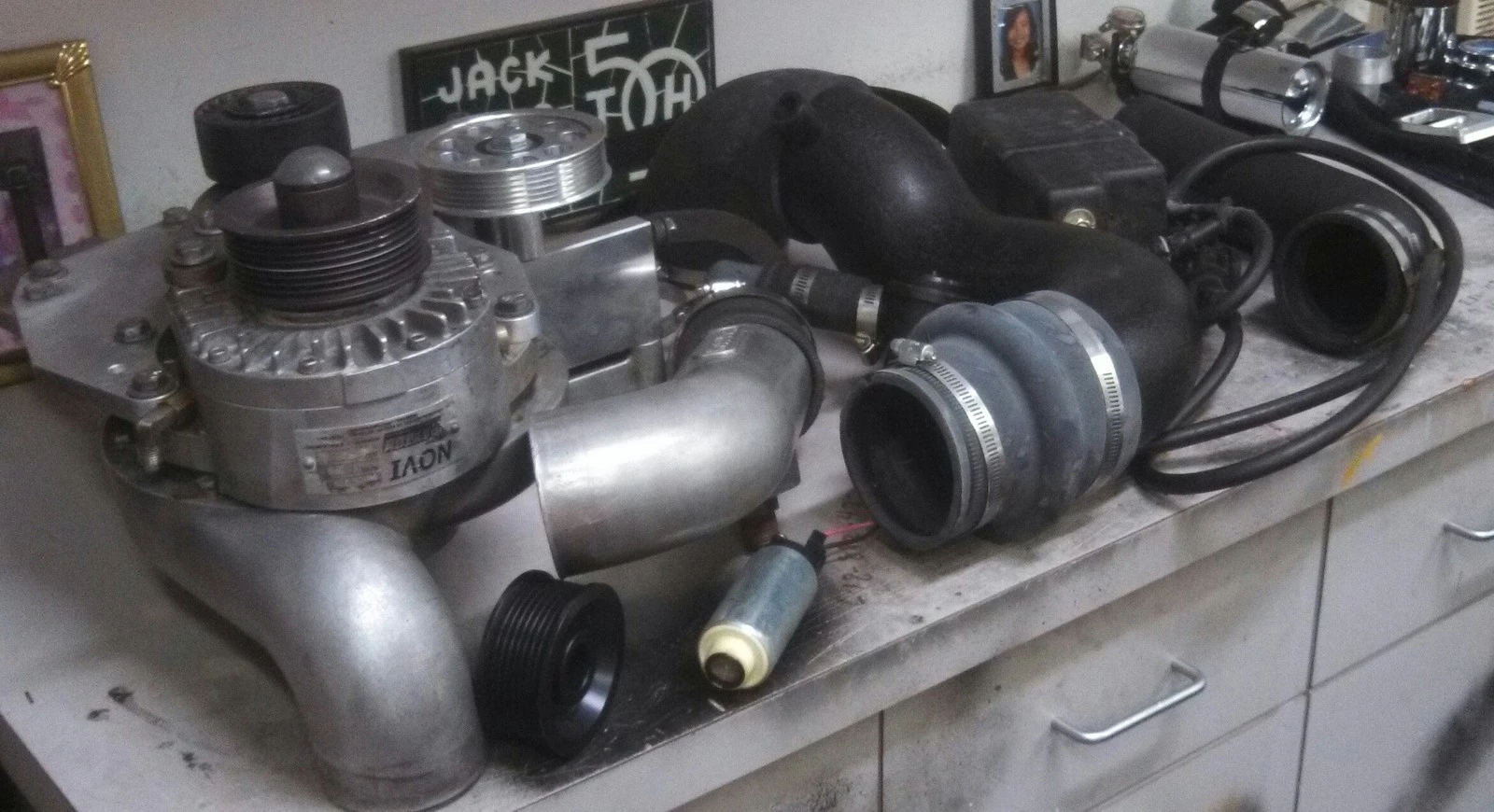

Update: Got more pieces of the puzzle today. Paxton/Novi 1000, UPR powerpipe, Anderson Mr.Freeze Methanol injection kit, 255lph high pressure pump, UPR smog pump eliminator pulley.
I also got a deal on 60lb injectors and a matching Pro M 80mm MAF meter that I'll be picking up tomorrow.

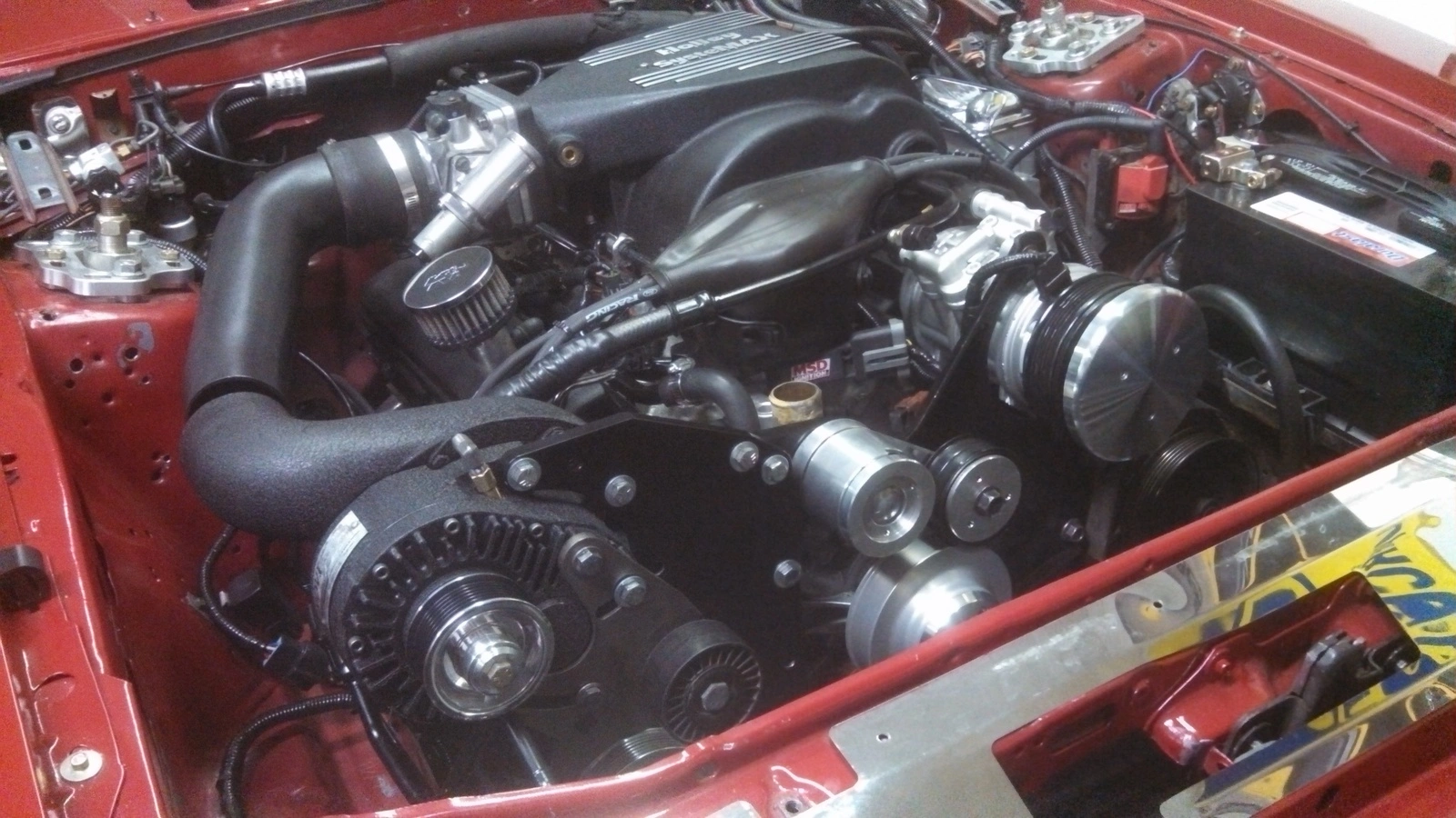

Making some slow progress on the supercharger install. Got busy at work so its taking longer than expected.
Anyway, its getting close. Still need to cut the inner fender for and install the powerpipe, maf, discharge tube and bypass valve, belts, and billet pulley covers.
Lastly install the meth injection kit and go to the dyno for tuning.

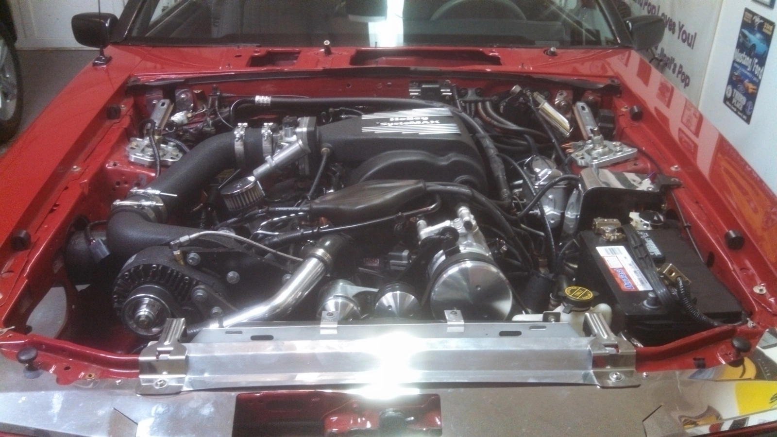

Here's where I am as of last night. Trying for a new look (for me) this time around. Backing off from the bling and going for a more newer stock blackened look. There is still polished items to accent the blackened theme.
Jeeeeez this is taking forever. LOL
Not much left to do. Just need to extend the MAF harness, install the fender liner, install the hood and cowl grill, cross my fingers and fire it up.
Then off to the dyno for a tune.
