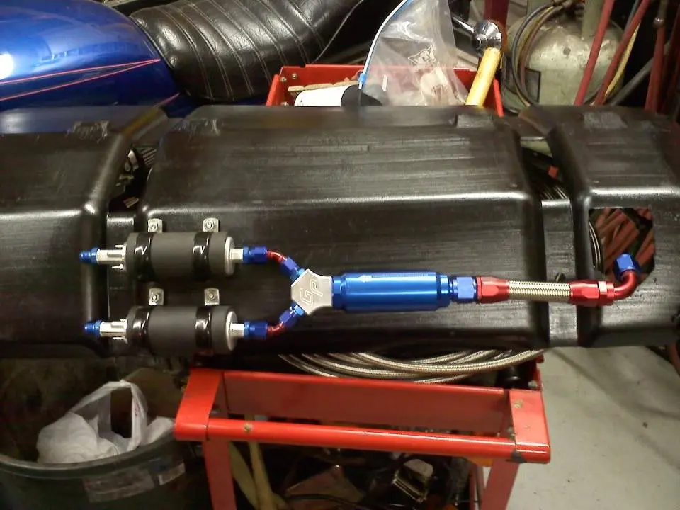

Worked with my son Jay til close to midnight last night... Got the pumps mounted to the tank cover... FYI... Washed and painted existing cover... was surprised how well the paint looks..
Got the new fuel regulator installed and the return line installed...
Pics later..

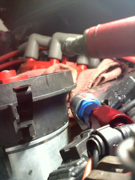

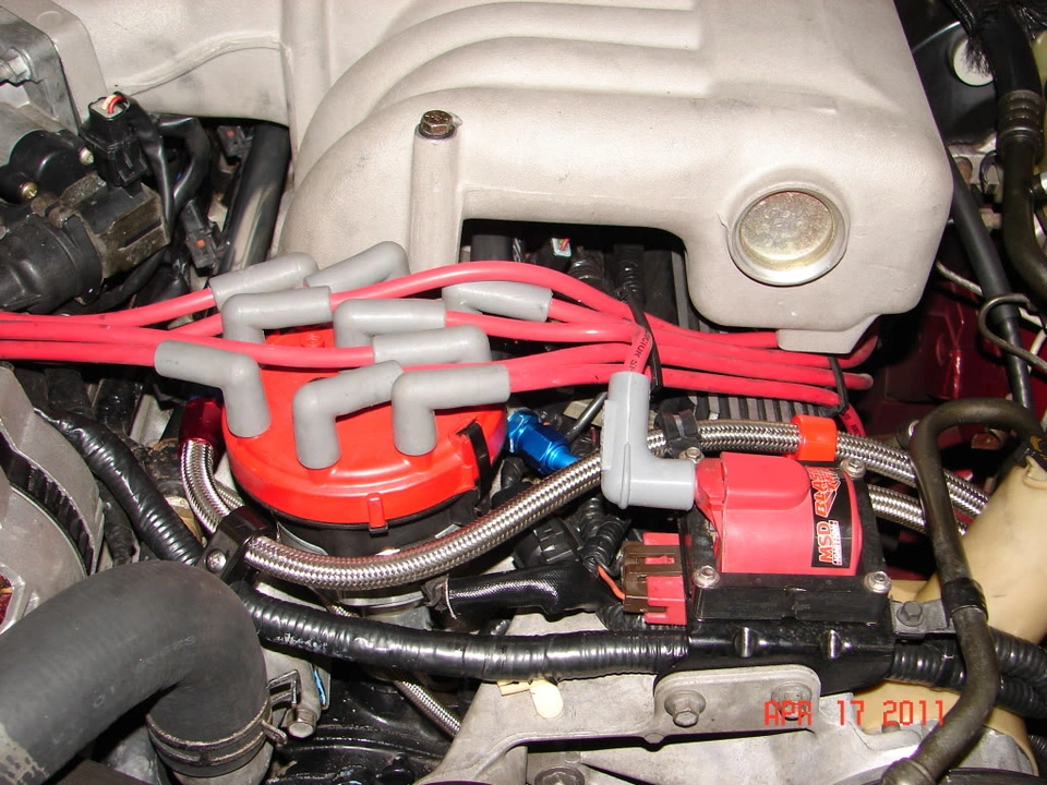

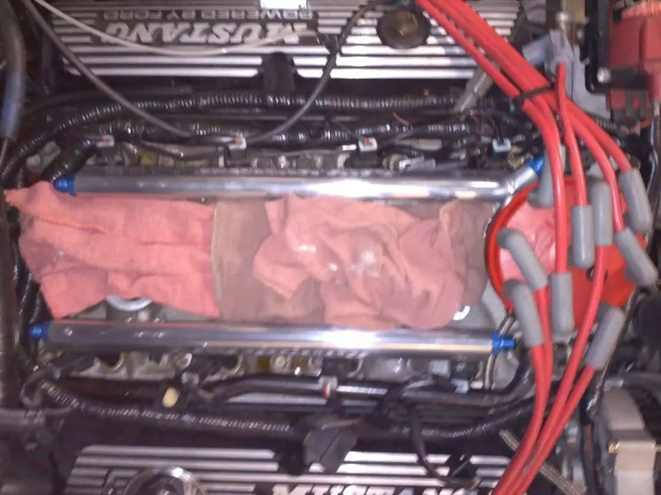

Installed the new rails.... already had Mallory rails nothing like doing things twice..:rolleyes:
They miss the MSD distributor easy... might need a 45 degree fitting to miss the coil..
They want the feed lines going up the drivers side that will be today's project.

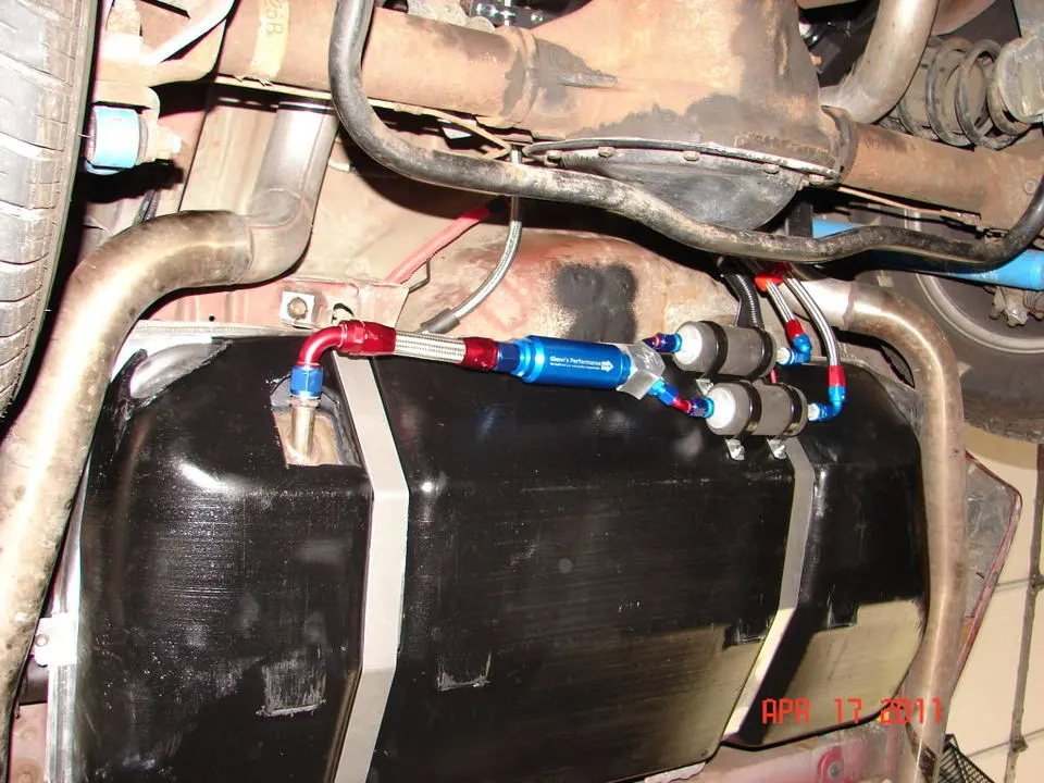

i'll take some photos of the tank hanging today... tired last night.
Finished Saturday and put 5 gallons of 93 into tank (20 something for 5 gallons eek) and it started up after turning off 5 or 6 times and setting fuel pressure to 38 with vacuum line off.
Underhood
Fuel system attached to fuel tank cover
