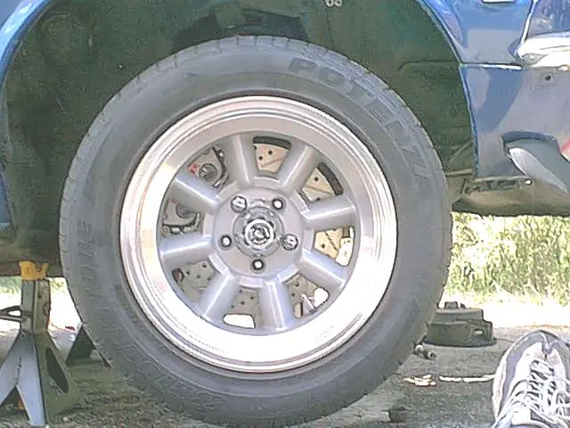

Alrighty, so far after 2 days and about 10 hours of work... I have two spiffy looking spindles mounted with 12" Baer sport package brakes... and a PITA distribution block that won't give up the lines :(
attachment.php
Here is the spindle with the mounting brackets for the PBR calipers. I wanted a little more color than plain black so I chose dark ford blue- just happens to match my car :nice:
attachment.php
This is of course the caliper and rotor all mounted together.
THe Swede
attachment.php
This is another shot of the whole assembly. Included in this one is the braided brake line included in the kit.
attachment.php
And this is what the finished product looks like behind the wheels I have. Gotta love V48s!!! :nice:
THe Swede
