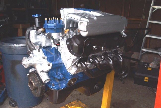

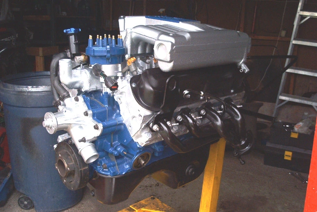

Yes it can be bolted to the header. No problem at all. Now this is with the stock engine, shorty headers pic. Same thing as longtubes...It goes in the same place.
