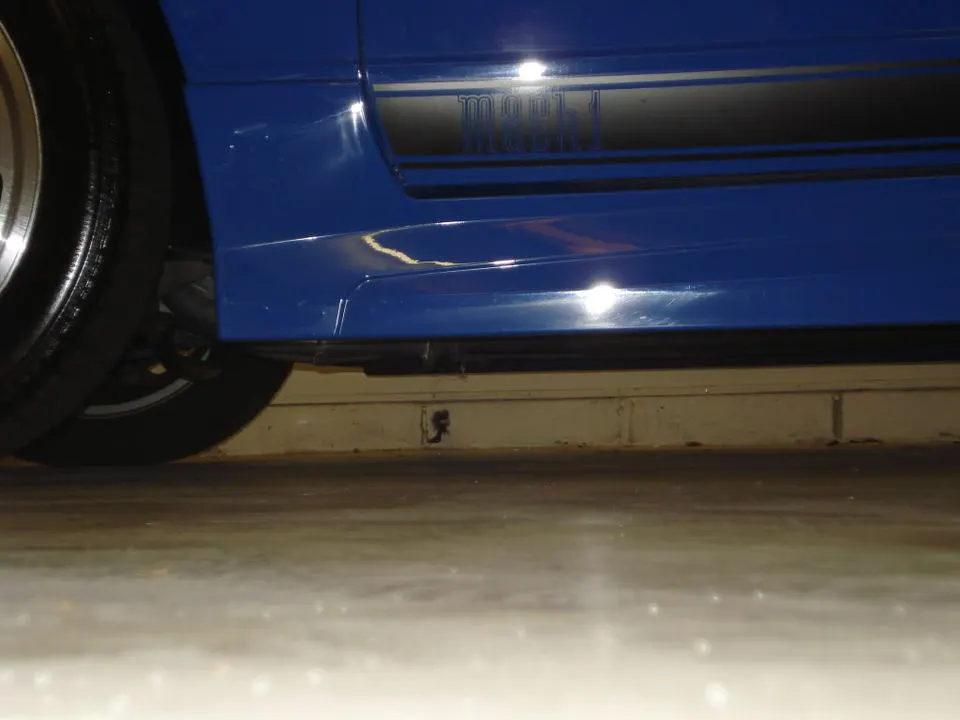

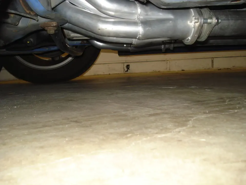

Blackone51 - Here are some pics... Not any lower than stock.
