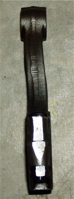

This used to be a rod rated over 700 HP. Now It's an expensive used chevy rod :lol: . Or a paper weight. Changed main body on holley to a proform and had a leak, I knew this. I did not realize it was bad enough to hydrolic a cylinder until I asked my wife for help. " Baby turn the key on and the fuel pump will come on by itself." Crank Crank Thunk Oh oh The motor was siezed after that. Should have seen the disgust on my face when I pull the head to see the #4 piston not coming all the way up. :barf: :jaw: The worst part is I didn't know who made it until a few days ago. NO ONE makes an I-Beam this heavy. That make it hard to find a replacement. But I found one. :nice:

The cylinder filled with gas. It doesn't compress. The piston came up, It said " Move, Here I come." The gas said " No you don't. " And the rod took the beating and went home crying. No wait, I did the crying. :bang:

for all reasonable purposes, liquids dont compress muchl...if at all. Basically, when the cylinder filled with liquid gasoline, it acted just like a block of iron would have in the cylinder. the rod just so happened to be the weakest link.
I thought about getting rid of her. But then it was my own damn fault. I should have told her to just turn the key left. None it would have happened. The piston is slightly scratched from the counterbalance of the crank. When the rod got bent it made the rod shorter and the piston hit the crank, but I'll have the new rod balanced to compensate for the missing weight.
