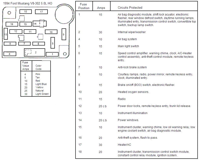

Thanks!!!This is sad I need to see where my fuses are.. I have been doing so much other stuff to the car. Is it a normal fuse for the airbag?

I checked the fuses, they are all fine. Theres a LOT of 30 amp fuses in my box??? Ugh!!

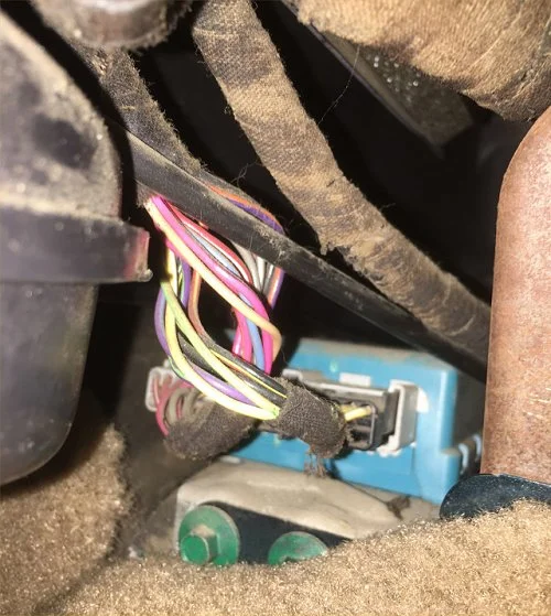

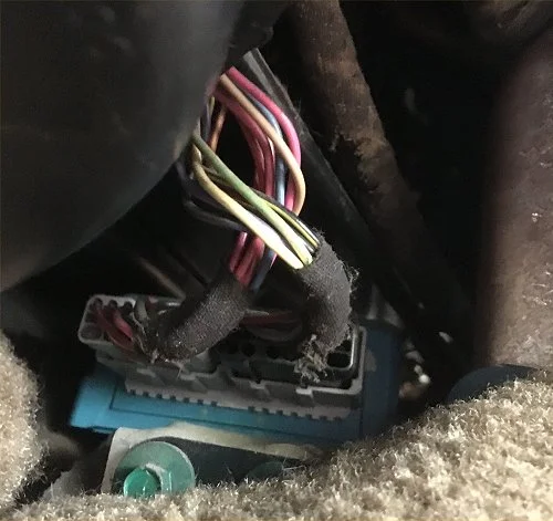

Anyhow, I used a stethescope and found the beeping blue box, the blue one behind the console.
I unplugged the two plugs in it, and the CEL stayed on when I started the car.

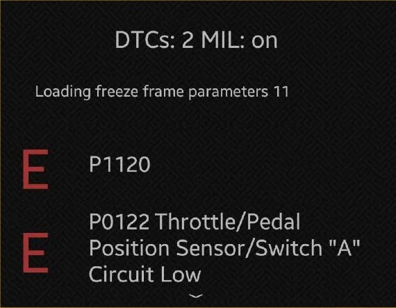

I scanned it, and it came up throttle positioning sensor. Quite odd! I don't have a CEL normally, and didn't have that code before. I cleared it with my scanner since this car does not have that issue normally.
Anyhow, I plugged the two plugs back in, and took the car for a ride. Light stayed out as usual, and the beeping is still there.

Here's a photo of the blue box thats beeping. I was hoping unplugging the two plugs would stop it from beeping. It may have, but the CEL comes on with a TPS code.

When I do unplug the blue control module box, my check engine light comes on and throws the throttle positioning sensor code. I can't figure that one out.
So I just plugged it back in and cleared the code.
I'll check that link shortly. I really didn't care too much about the airbag but was hoping to stop the noise it's making me crazy.
What puzzles me is disonnecting the blue box sets off a code for TPS? I cleared it back out. But that is odd.

You found the right module to disconnect (light blue with that two-bolt metal bracket), like you I have absolutely no idea why that would set a TPS code. The only even remote possibility I can think of is that your body grounds aren't in good shape, and that the ECU was borrowing some ground circuity from the Airbag connection. Try running a ground wire to that bracket (from battery) and see if that lets you disconnect without a TPS code.
You'll have a better time determining what to replace (sensor, bags, etc.) if you get that dash bulb situation sorted out so you can get the actual code, so it's probably early to be troubleshooting sensors. You can also pick your poison and determine if the bright light in the dash or the beeping is worse. I find the beeping worse -- hopefully addressing the ground situation will allow you to temporarily disconnect the module until you can get the rest of the system sorted..

I have to look at this fuse box though. They got a Ton of 30 amp fuses and I cannot figure out why. Or maybe I should just leave them alone I don't know. But the airbag one number 4 has a 10 amp in it there. just a bunch of 30,a in the rest for some reason.
