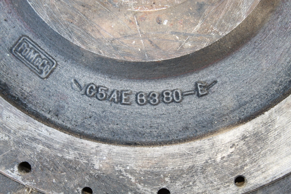

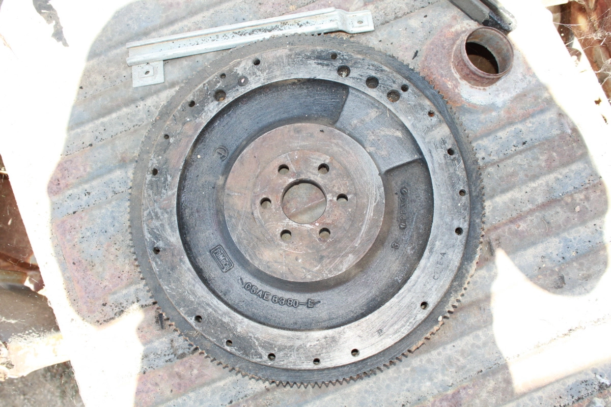

here are a couple of pics. of were the part # is located. this is a 65 fly wheel, as you as you can see by the C5 at the start of the part #. the 351 fly wheel is larger than the early wheels. they can have either the 10 1/2 inch pattern or 11 inch pattern so watch for that. some have both but are only threaded in one set of holes.
