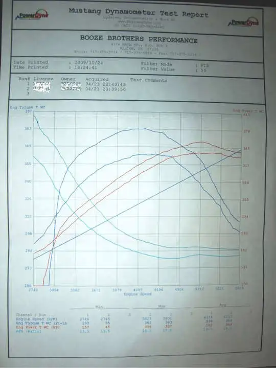

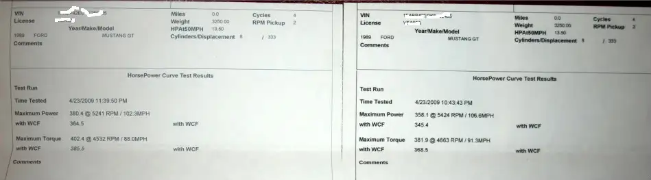

rick your memory is good i have longtubes tho not shorty headers heres the dyno readout
