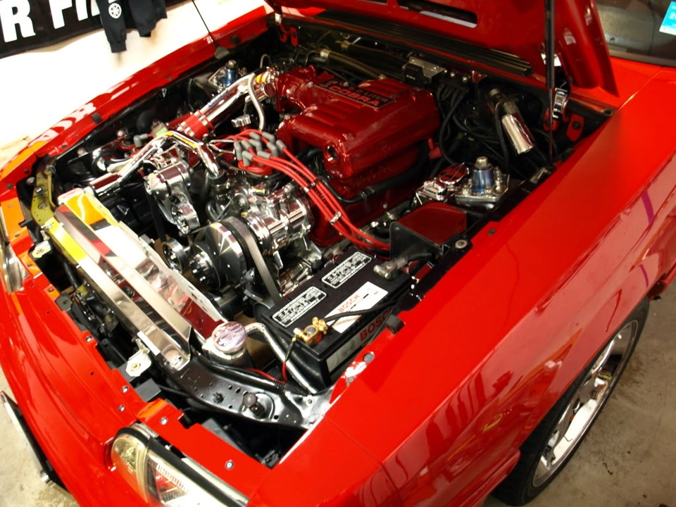

Here's a pic of John's beast, pretty ain't it :jaw:
That is a sexy engine, haha. One of the best powder coating jobs I've ever seen.
