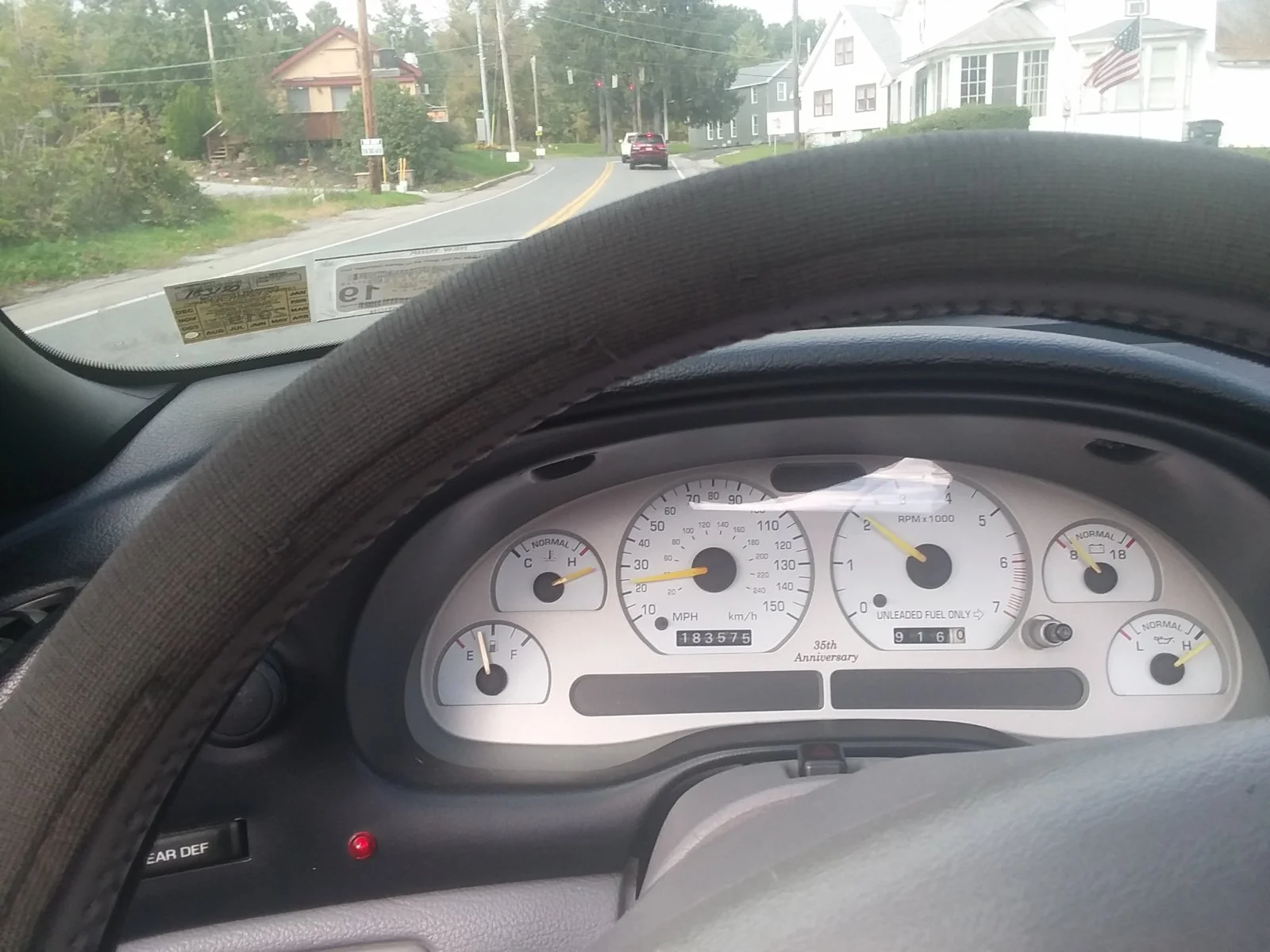

Grounds seem fine battery is 12.39 at rest I'm experiencing almost lie a brown out stereo flickers on and off ight go dim randomly
