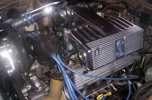

I agree.I got mine a couple of years ago ,and after the install,there was an actual difference you could feel.I converted the Explorer 65mm t-body for the Fox body setup.
