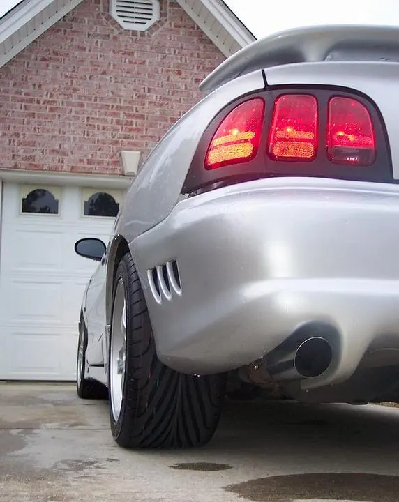

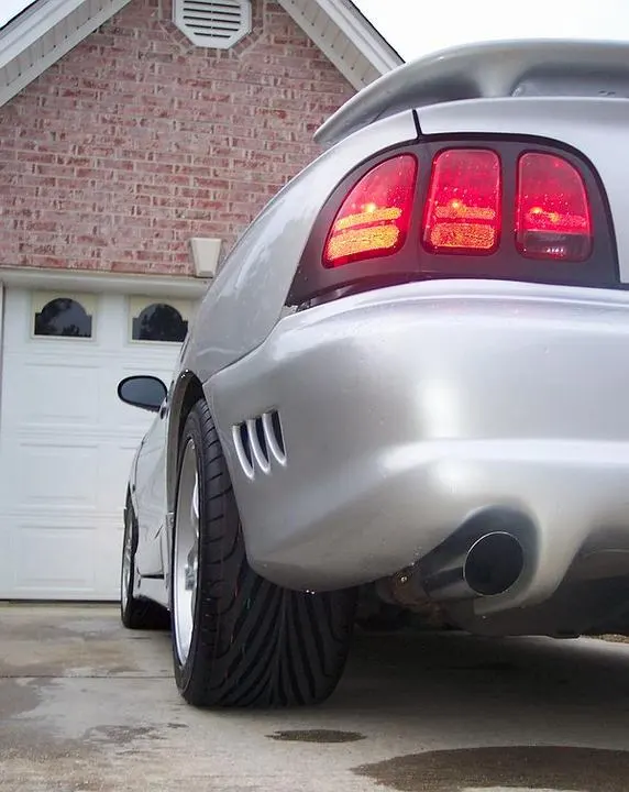

Most 275/40's are spec'd for up to an 11" wheel, so they should fit great on a 10.5". Here's a pic of my 285/40's on a 17x10.5 wheel...
How is the space between the tire and exhaust? any rubbing? I just got in my 17x9 black bullits and I am waiting on 10.5 to come in for the back.
Thanks
Manuel
Thanks
Manuel
The factory exhaust has a "dimple" right where there might be any tire rubbing, so I've never had any problems. If you've got an aftermarket exhaust, though, you might get some rubbing.

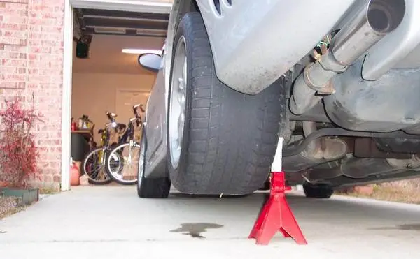

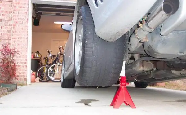

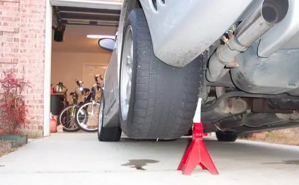

Here's the 15k mile 315/35 Sumi (note the wear concentrated around the center - not much of a contact patch)...
Here are the 285/40 Goodyear GSD3's. Perfect fit...
I see a red x for an image. But no matter, even without seeing the picture if a tire is worn more in the center than the outer edges, that's not a function of the tire being too wide for the rim, it's a function of the owner over inflating his tire.
If you lay a tape measure across a 10.5" wide wheel it will measure 11.5" wide outside edge to outside edge. 11.5" is equal to 292.1mm. Therefor the minimum tire that should be used on that wheel is a 292mm in width. No one makes that. 285 is too narrow. The wheel is wider than the tread surface. Since no one makes a 292/XX-17" tire the next size is 315. That's why 315 is the best size tire for a 10.5" wheel.
By your logic a 225 width tire on an 8" factory GT wheel would look best. As we all know the 245 that comes on them is almost too narrow.
It's not about buldging sidewalls or not. It's about proper fitment. And to some degree what looks best. In this case, the 315/35R17 fits best and looks best.

Regarding overinflation, I noticed the center wear pattern early on and took the tires down below 20 psi and they continued to wear straight down the middle.
A wheel's width is measured from inside lip to inside lip, not outside edges. You also have to take into account that 315mm is the nominal size. Every manufacturer is different, but the Sumitomos were just on the big side for a 10.5. Not all 285's may fit as well as the GSD3's. Take a look at the pics before you say what looks and fits best.
One thing is for sure, the 285 GSD3's had a ton more traction than the 315 Sumi's.

I agree that the sidewall bulge should match forward and back. I believe the GSD3 285 on the 17x10.5 matches the 245 on the 17x8 in the front.
Looking at the specs for these tires, the 285/40 GSD3 has a Section Width of 11.3" while the 315/35 Sumitomo has a Sect. Width of 12.6.
The recommended Rim Width range are as follows:
285 GSD3: 9.5 - 11"
315 Sumi: 10-12"
The 10.5" wheel is at the bottom end of the range for the 315 and at the top of the range for the 285. Arguing about which looks better is futile. Opinions are like... well, you know.
If you like a sidewall to bulge, go with the 315's. If you like a sidewall that is squared off, or with a slight inclination (like most European cars), go with the 285's.
