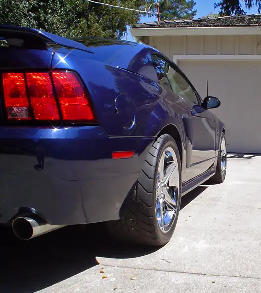

every one always tells me they look drag radial-ish.
^^ are those NT-01's? Aren't those road racing tires? Not drag radials. First time I've seen them on a mustang.

Yes they are :D
I'm not sure what is the difference between some BFG-DR and these road racing... they both have a tradewear of 100 and they stick like crazy :lol:
But every one gets impressed, that's for sure :nice:
