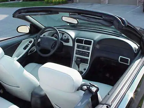

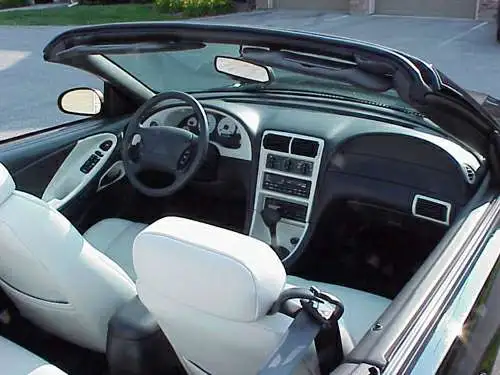

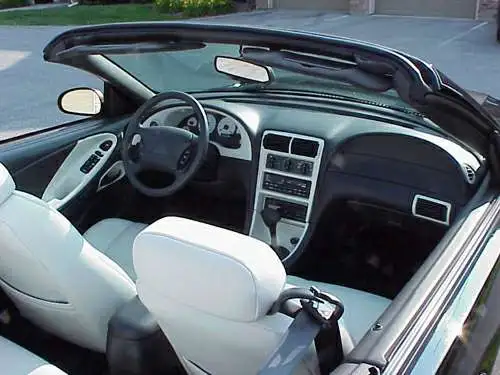

Yeah, it's so hard to get good interior shots of the car...how does the curvature on the bezel look?

That's a good idea with the outer A/C Vents...just paint the rims. NOW, on that car, the WHOLE shift bezel colored looks ok, but I think on mine, with the red, it would be too much...
Thanks for the pic.
