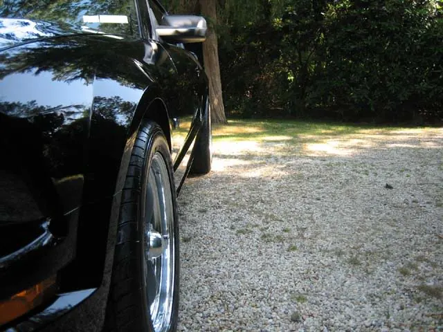

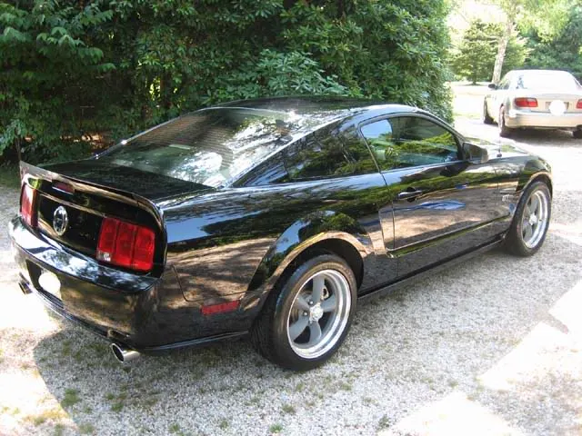

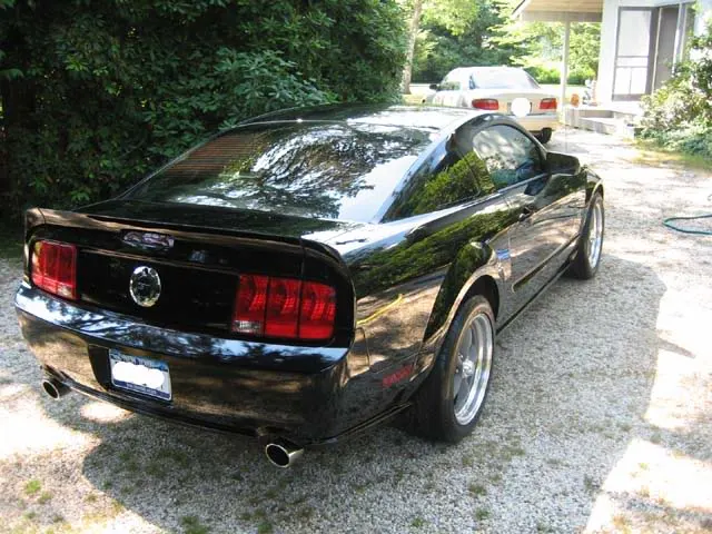

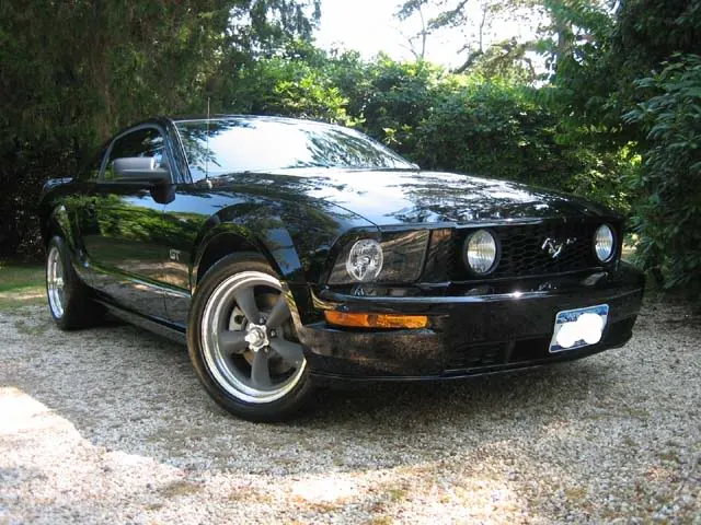

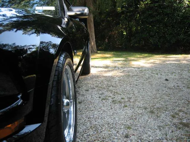

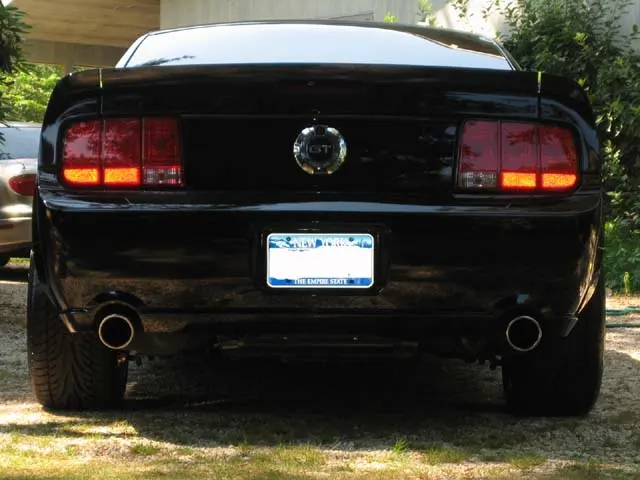

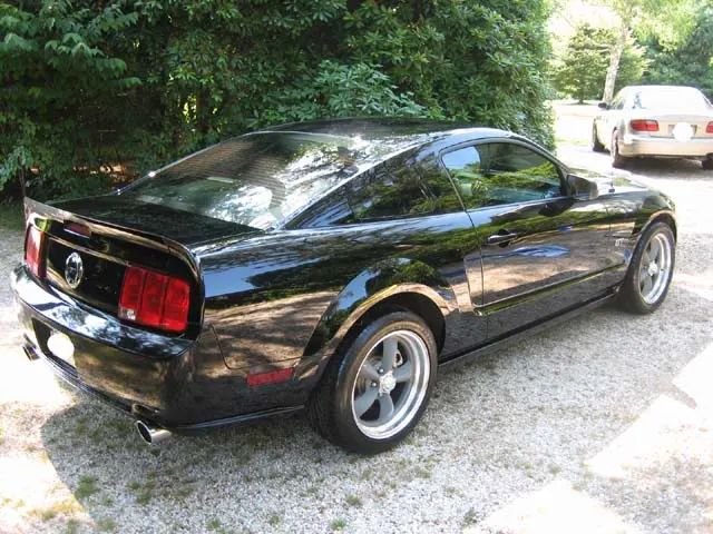

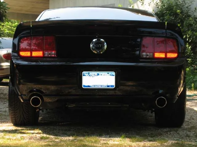

i went with 18s and i think im retro looking! 18x10 back 18x8 front. i wish i could slap 18x10s on the front tho, i saw a roush mustang which had 10s all around, but it prob had some kind of different front suspension.

Yes indeed you are very retro!
Hey Official_Style, yup, you have the retro look; you did select vintage looking rims (AR TorqueThrust) and in gray spoke no less. Very, very nice look; I'm looking into the AR 200s, gray spoke but the last time I checked there were only available in 15" and 17". (I'll check again tonight). If you aren't sure what the gray center 200s looks like take a look at the AR web site. Thanks for all the pics, my 06 black GT 5-speed w/parchment, spoiler delete is supposed to be at the dealer tomorrow or the next day. Doesn't look like you lowered any yet; do you plan to. I'm gonna put the rear ProKit and BMR adj panhard on the day I pick up the car. ...may not do the front.
Anyhow congrats on the awesome look you have achieved and I was wrong... you can look fully retro in 18's... enjoy and thanks, Jim
