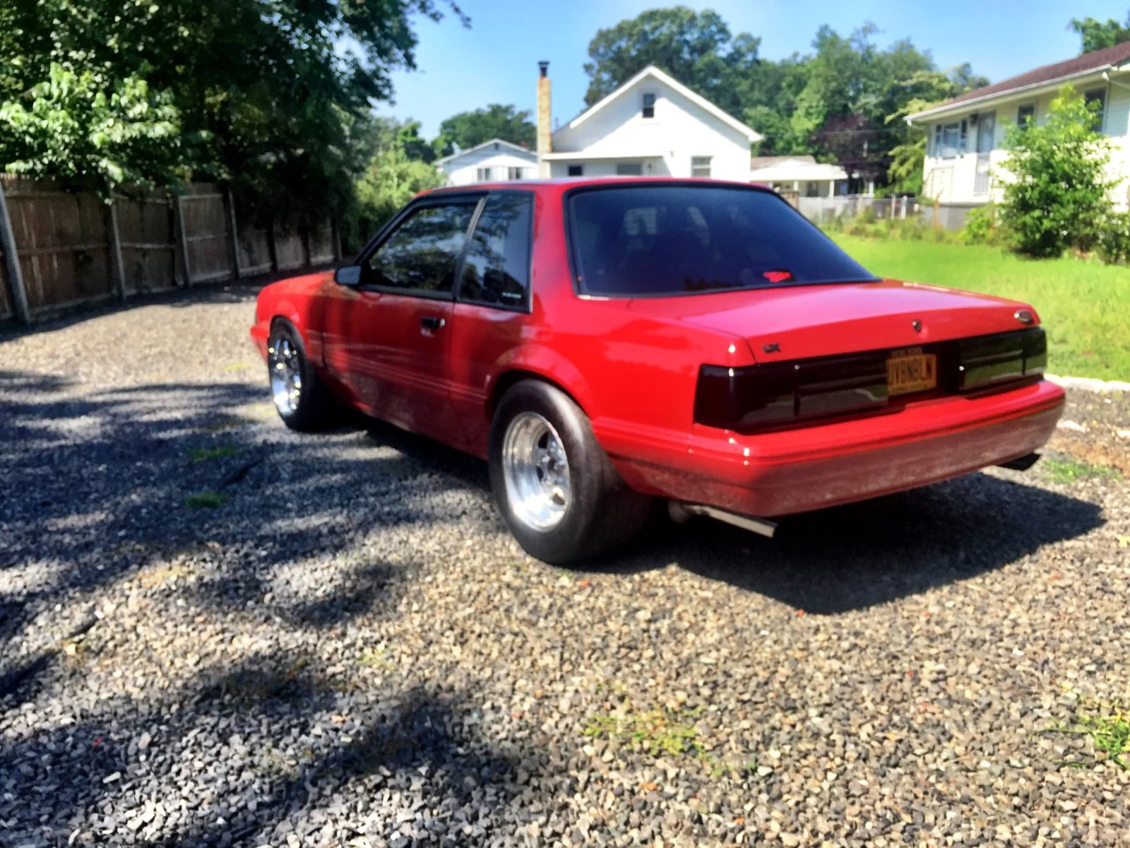

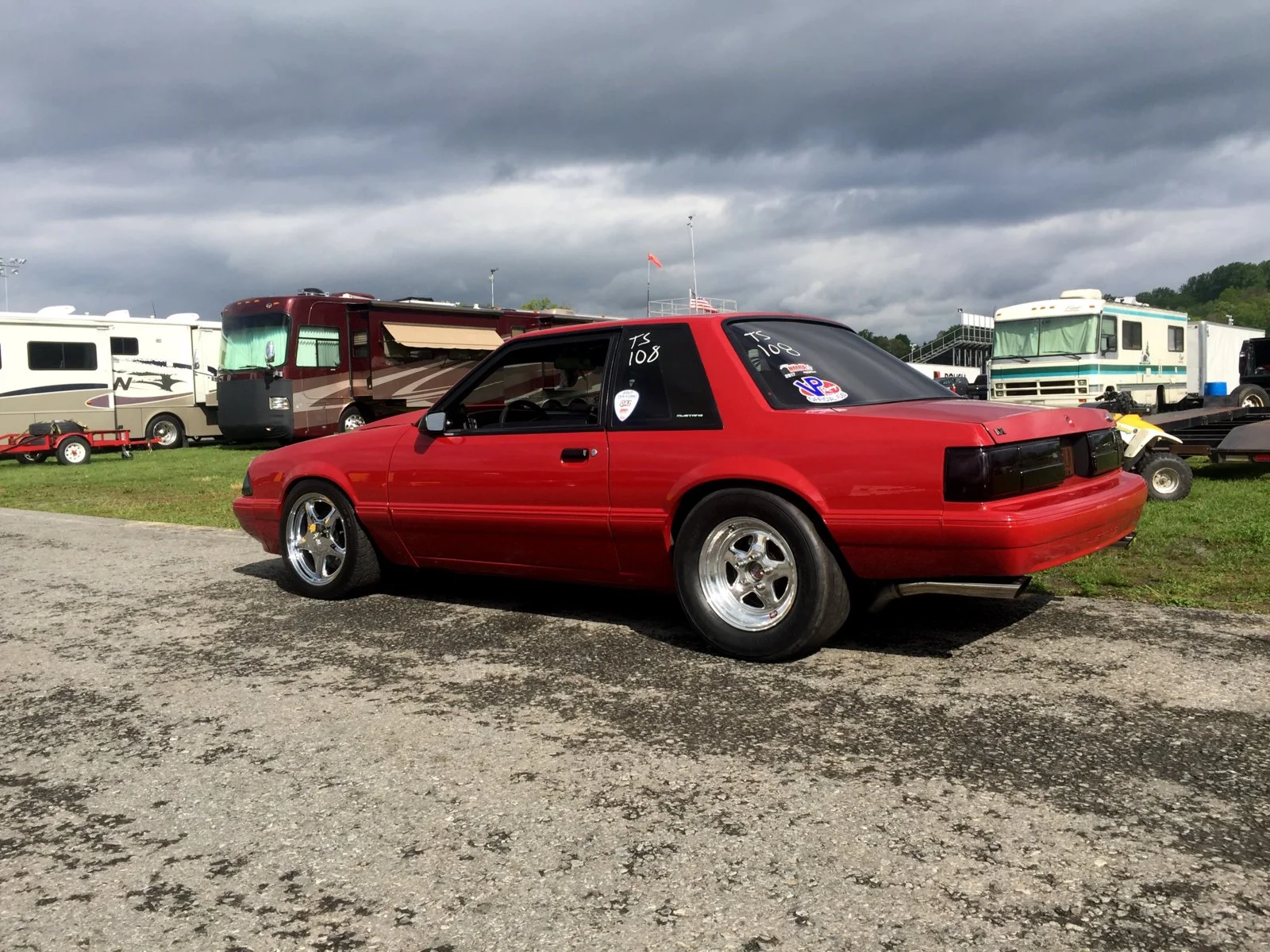

Another example:
15x8 5.5 backspacing 275/50/15
15x10 6.5 in bs 275/50/15
Zero issues .
