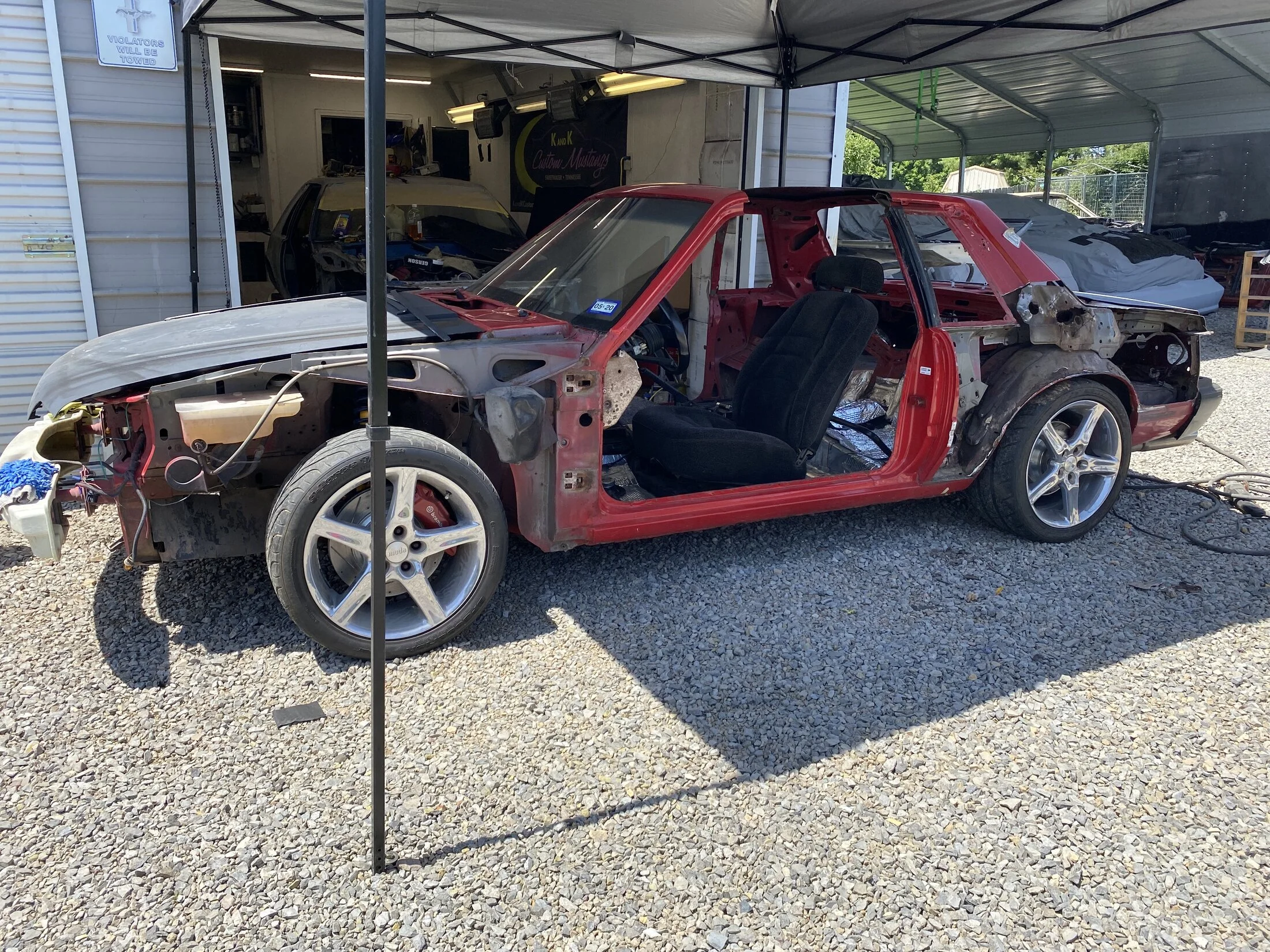

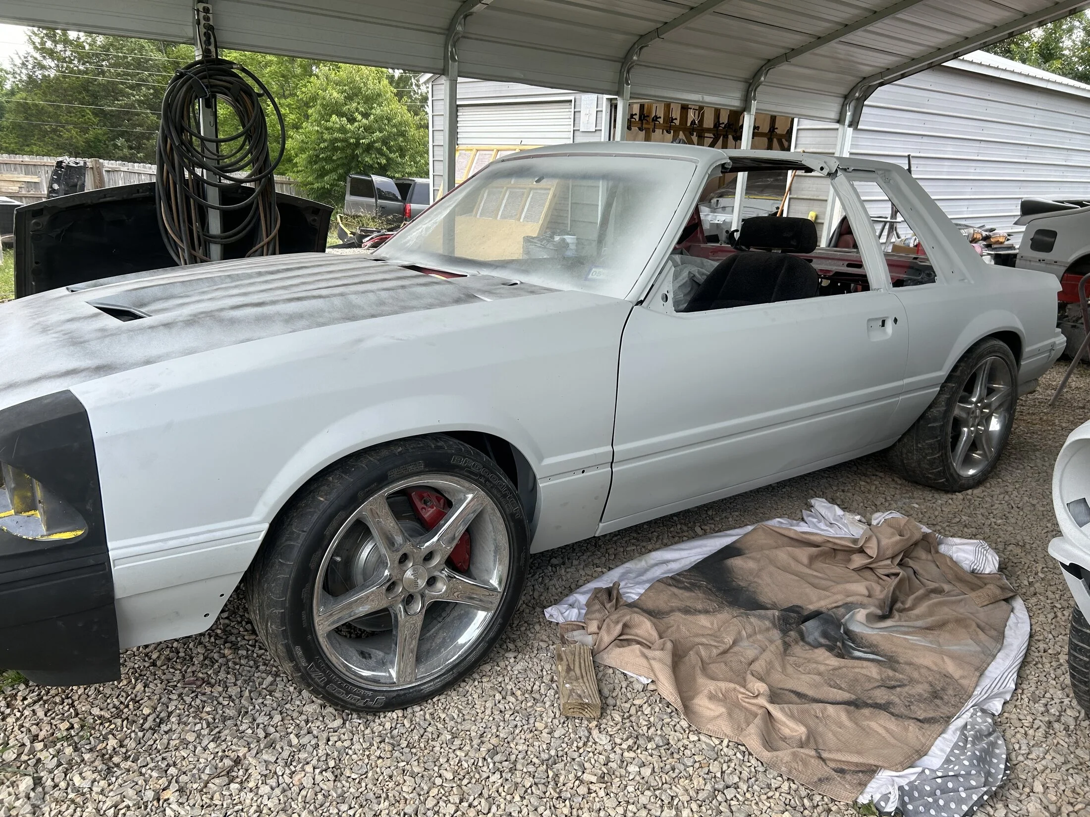

A while back when Kevin was working on the fender gaps and stuff, I told him how excited I will be to finally see the car back together in all one color. While it still has some guide coat in places and the bumper is not mine (I think as mine has already been primed), he surprised me by putting my wheels on there and sending these pics today.
Its come a long way. From no panels and roofing cement stuffed in it to measuing each gap down to 3/16th of an inch. Glad Nick has a car again
