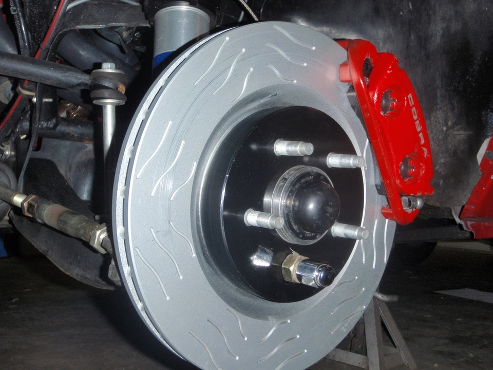

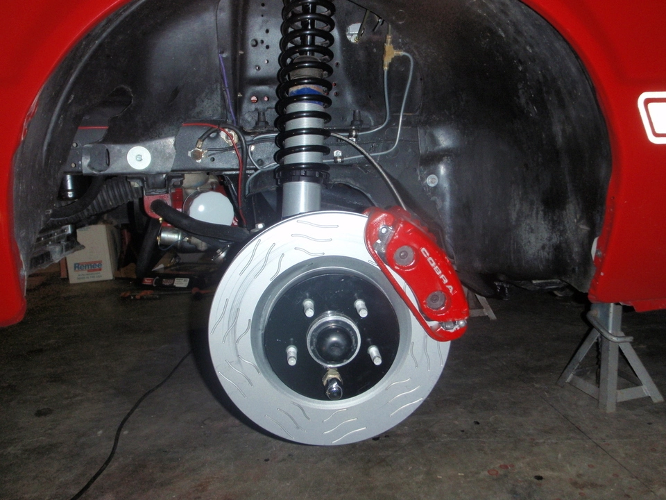

So I go back to AutoZone today W/ my chinee rotors and pads in hand at lunch.
I exchange my old stuff, pick up the new "American made" Raybestos Slotted rotors ($110.00 ea) only to find that I cannot make this a one stop shopping trip. The AutoZoner says the only pads they have is some iteration of the duralast brand. Sorry Jeeves I say, you'll have to give me my money back on the pads because after this last go round,...I ain't buyin' no Duralast pads.
So he does.
Off I go to Oreillys.
Dude there seems knowledgeable enough, and tells me that his information stipulates that Cobras actually came w/ a semi metallic pad,...and that despite the fact that there are ceramic pads at the top of the product line,..he suggests that I replace my old ceramic pads w/ the cheaper, semi metallic as called for by the OEM.
So who am I to argue?:shrug:
I pay the whopping 35.00 for the set, and come back home to install the stuff.
I get to looking at the box the rotors come in, and to my disgust I discover that even the 110.00 ea. Raybestos rotor have "Made in China" stamped on them.:dammit: But they were "finished" in the U.S.A.:banana:
Whadya gonna do? I put them on.
Now, I'm not gonna tell you how this story turns out, cause I still gotta fix the heater core and I am not gonna put the car back on the ground just yet.
But they look like they are gonna be quiet, so that'll have to do for now.....pig.
