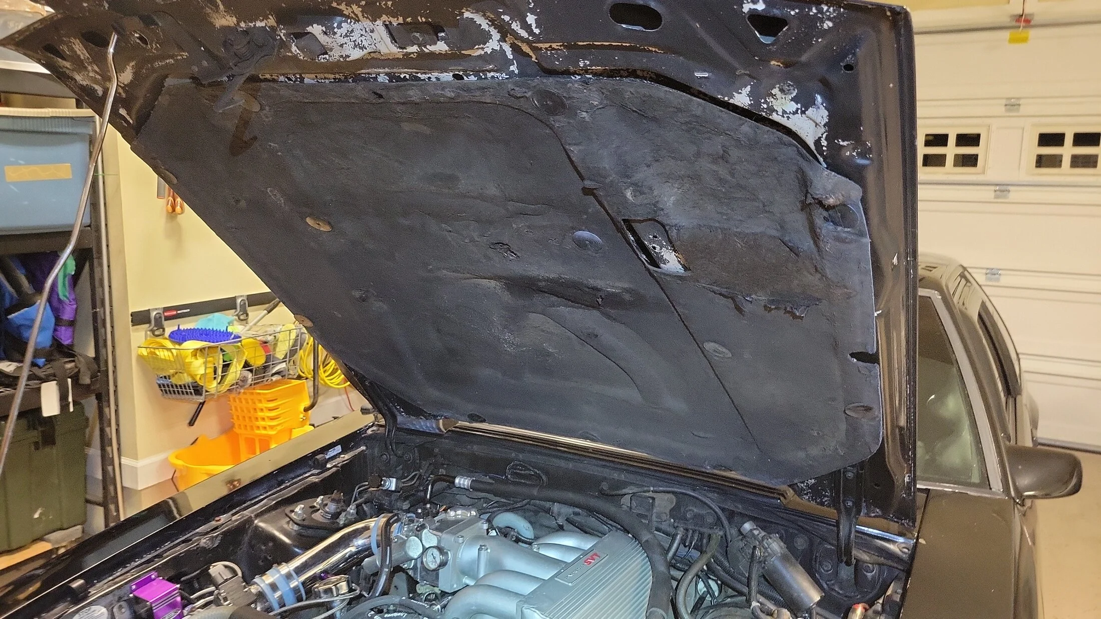

Made $$$ & got an upgrade out of it.
It's not sexy, but I bought a hood for $250, stripped the liner out of it, installed it in blackjack, and sold the hood for $300. I got a hood light with it, but I spend so much time under the hood, that I really don't want it installed, yet.

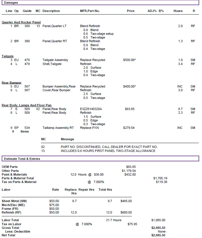

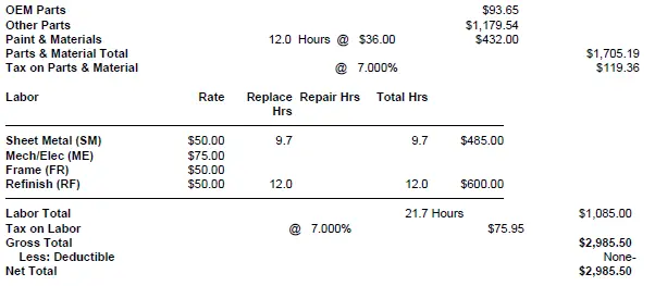

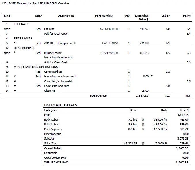

Following up on last week's fender bender:
I've got a couple of estimates from recommended body shops in my area:
Elite's Estimate:
Perry's estimate:
I think I'm in a good spot now to haggle with the USAA adjuster. Guys, this may be my first litigious action. If he/she lowballs me, or tries to 'total' the car, I'll pay for the repair, and take 'em to small claims. I'd rather a judge decide than a low balling adjuster. I feel like this is a pretty good spot to be in.

Thanks @FastDriver, those estimates vary quite a bit. The one from Elite looks more accurate, but I bet Perry’s is right that the rear body panel has “some” damage, not sure if the would have to really be replaced. I bet that can be pulled and repaired, which is what I would try to do, rather than cut it off and replace it. With your car being black, I doubt the blending of the quarter panels would be necessary as Perrys wrote.

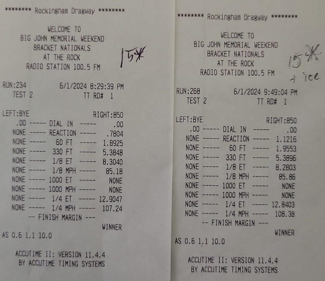

Rockingham Dragway 1JUN24: DA's ranged from ~ 1,600ft to 1,300, which was right in the same ballpark as the DA the last time I ran the car at the Mooresville 1/8 mi strip back at Foxtoberfest. Then, I ran a best of 8.36 ET and a best trap speed of 83.8mph on a 1.86 60'.
Since then, the changes off of the top of my head include (I think):
- Switched from BBK to Accufab 70mm TB (no expected HP gain -- just helped with the whistle)
- Went from 4.10s to 3.73s
- Added electric fan
- Put U/D crank & waterpump pullies & oversized alternator pulley
- TMOSS/MMOSS ported the lower intake
It was different track, different day so not the best scientific comparison, but today's best was:
[email protected] in the 1/8 on a 1.95 60'. To get there, I was launching off of the limiter that I set at 6,100 RPM and also shifting at the limiter.
This was, in fact, a 1/4 mile track, and that worked out to a [email protected], which is *technically* the fastest speed Black Jack has ever trapped, because with 4.10s it was gear limited. I say technically, because way back in the day it did run 86.47mph in the 1/8 when it wasn't full of Kilmat, didn't have the nitrous bottle, had 1/8 of a tank instead of 3/4 like tonight, didn't have the heavy T56, the wheels and tires weigh more, & it had the more efficient T5. That's at least 150 extra lbs, tonight. Plus I probably had better air at Kilkare. Something it will undoubtedly do again NA in better air. I definitely think it's making more power now than it ever has.
The interesting takeaway for me, tonight, was that Black Jack liked 15* of base timing best. I'm certain that back in the day it liked 18*. I wonder about that.
I did not get a chance to open up the bottle. I wanted to get a good baseline N/A again before doing that.
On the 2nd to last run, when I didn't ice the intake, & everything was at normal operating temps, it still went [email protected] & [email protected] in the 1/4 on a 1.89 60'.
It's hard to account for what impact the gear ratio change had on trap speed. I'm hitting the traps NA at ~5,300 RPM instead of at redline like with the 4.10s. So, that probably means peak power gains are probably a bit higher than that estimate. We'll see if that estimate was worth anything when I'm able to get it on the dyno, again.
Nitto 555RIIs and they're hooking well for a tire I can daily. I won't call it a 'dead hook', but if I go any more aggressively with the clutch, it's either bog or spin.
There's not much I can do NA. I'm launching flat-footed off of the limiter and aggressively slipping the clutch without wheel spin. I made some intentional decisions that I knew would put me in a spot off the line. 1st is just too tall.
It went from 4.10 * 3.35 = 13.7
to
3.73 * 2.66 = 9.92.
Makes for a nice driver/cruiser, but I had 38% more torque multiplication in 1st than I do, now. The reason it still 60's close is because I used to launch off of idle and now I'm launching at 6,100.
The solution here, I hope, will be the nitrous.
Not quite a fair comparison & power gain estimate:
One thing that makes it not directly comparable to the foxtoberfest night is that I did ice down the intake on the final run, which was the quickest & fastest. Still, on the 2nd to last run, when I didn't ice the intake, & everything was at normal operating temps, it still went [email protected] & [email protected] in the 1/4 on a 1.89 60'. Therefore, I estimate the 85.18 vs. the 83.8 at nearly identical DAs was worth at least ~17rwhp. Though it's hard to account for what impact the gear ratio change had on trap speed. I'm hitting the traps NA at ~5,300 RPM instead of at redline like with the 4.10s. So, that probably means peak power gains are probably a bit higher than that estimate. We'll see if that estimate was worth anything when I'm able to get it on the dyno, again.
