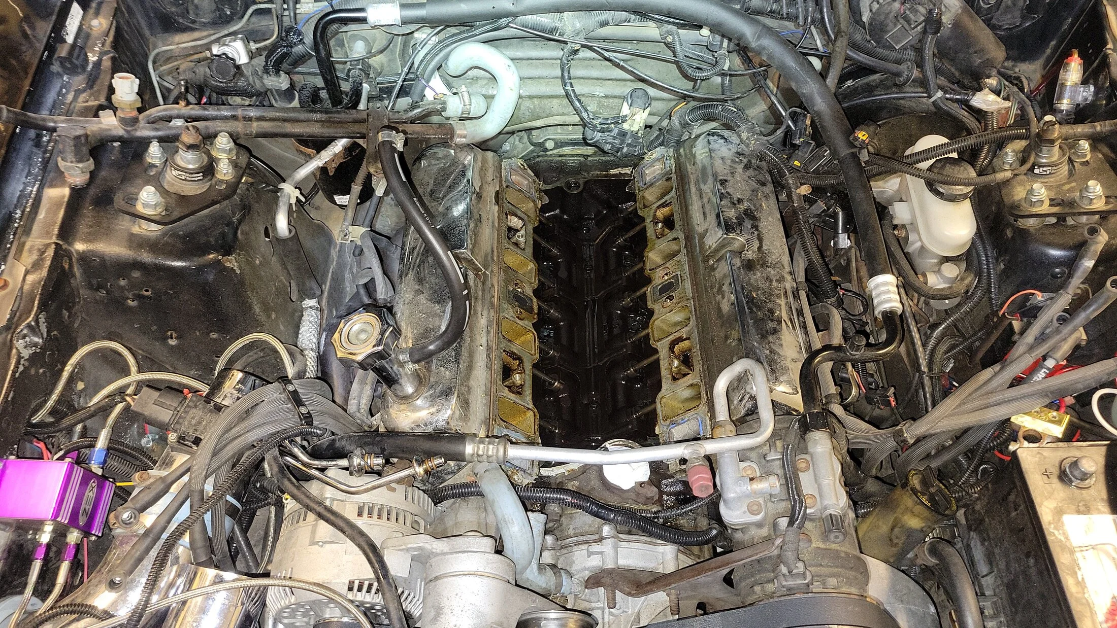

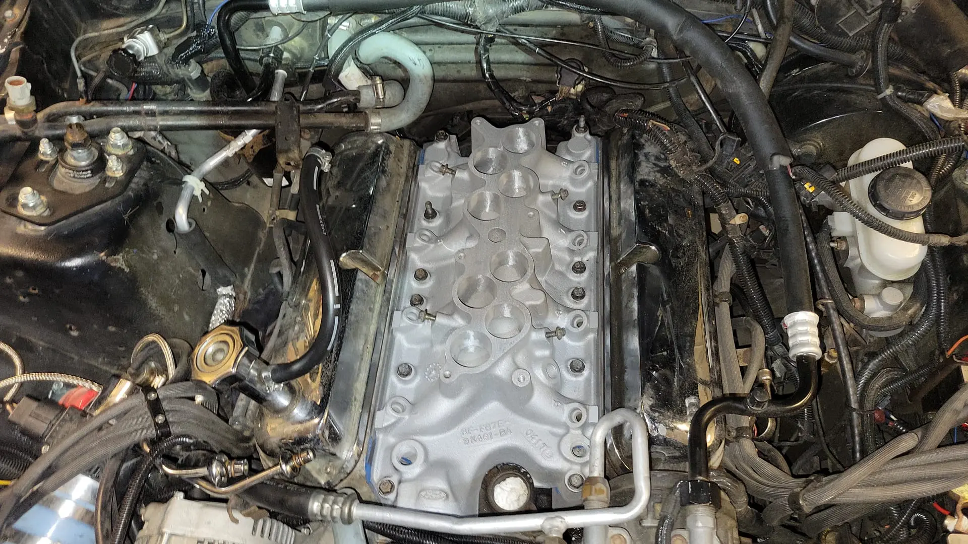

I hope to have the lower back on, tonight so I can let the silicone set. I hope the alignment is good. Gotta select the gaskets (1250 or 1250 S3 on the shelf) & trim them, set the intake up and check alignment with the bore scope, and then torque it down tonight. Will do the rest tomorrow.
I'm bothered by the amount of oil I see in the intake and some buildup on the backs of the valves. I need to rethink the PCV system. I've seen a design that apparently allows oil to drain back into the lower that I might copy, but for now, it's going back together, as is. Makes me wonder is this is what's killing O2 sensors. Before I go to the next combo, which I anticipate by the end of the year, I will address this issue.

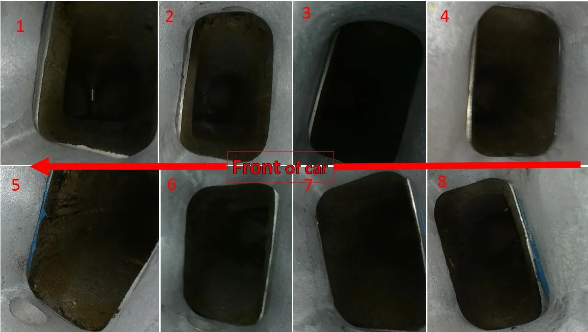

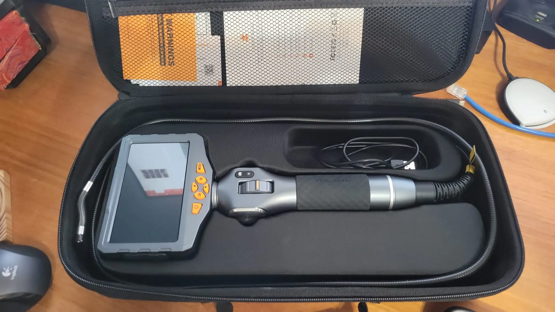

Took a little longer than I wanted, but I stopped to talk to TMOSS. Got to play with my new toy that I specifically got for this project. I wanted to see inside of the ports in order to align from top to bottom & had a .060 gasket (1250), and a .065 gasket (1250S3) on hand to adjust as needed.
Here's what I saw after the final torque down:
I thought top to bottom port alignment looked pretty good, and decided to stick with the standard Felpro-1250. But, left to right wasn't perfect. After talking to TMOSS, I think what's going on here is that the GT40X heads have ports that aren't spot on with a 1250 gasket, whereas the intake is pretty much perfect. The interesting thing to me, anal retentive as I am, is that even tweaking the intake forward or backwards in the bolt holes a bit can't improve from here, as the offset is the opposite direction on each side.
For what it's worth, I threw on my original intake back on to look at the alignment, which I still have because I bought one from the marketplace that Matt (TMOSS's son) ported. The original intake has no offset from the heads, but on the other hand, I'm positive that's because the ports on the original unported intake are smaller than the gasket & GT40X head. So, I slapped it together and will run it. Looking forward to testing it out.
All the silicone, including the T-stat housing is on and setting overnight. I'm ready for bed, and am looking forward to finishing up, tomorrow.

Nice video. I'd screw that up. Yeah, that lays out what I suspected. It's probably not unlocking all the potential with the "step" misalignment to the head, but I'll bet it still picks up decently over the stocker.
On the next combo, I already had Matt port the intake. If it is also not aligned, I think there's actually someone around here who can clean up the port match a little better, and can actually do the head to intake alignment together, as opposed to just the intake. I'm going to look to build that motor on a stand over time and so I won't be trying to put the car back together in a weekend. That said, I have a feelin that the 11R 170s are going to better match the gasket than the X heads do.

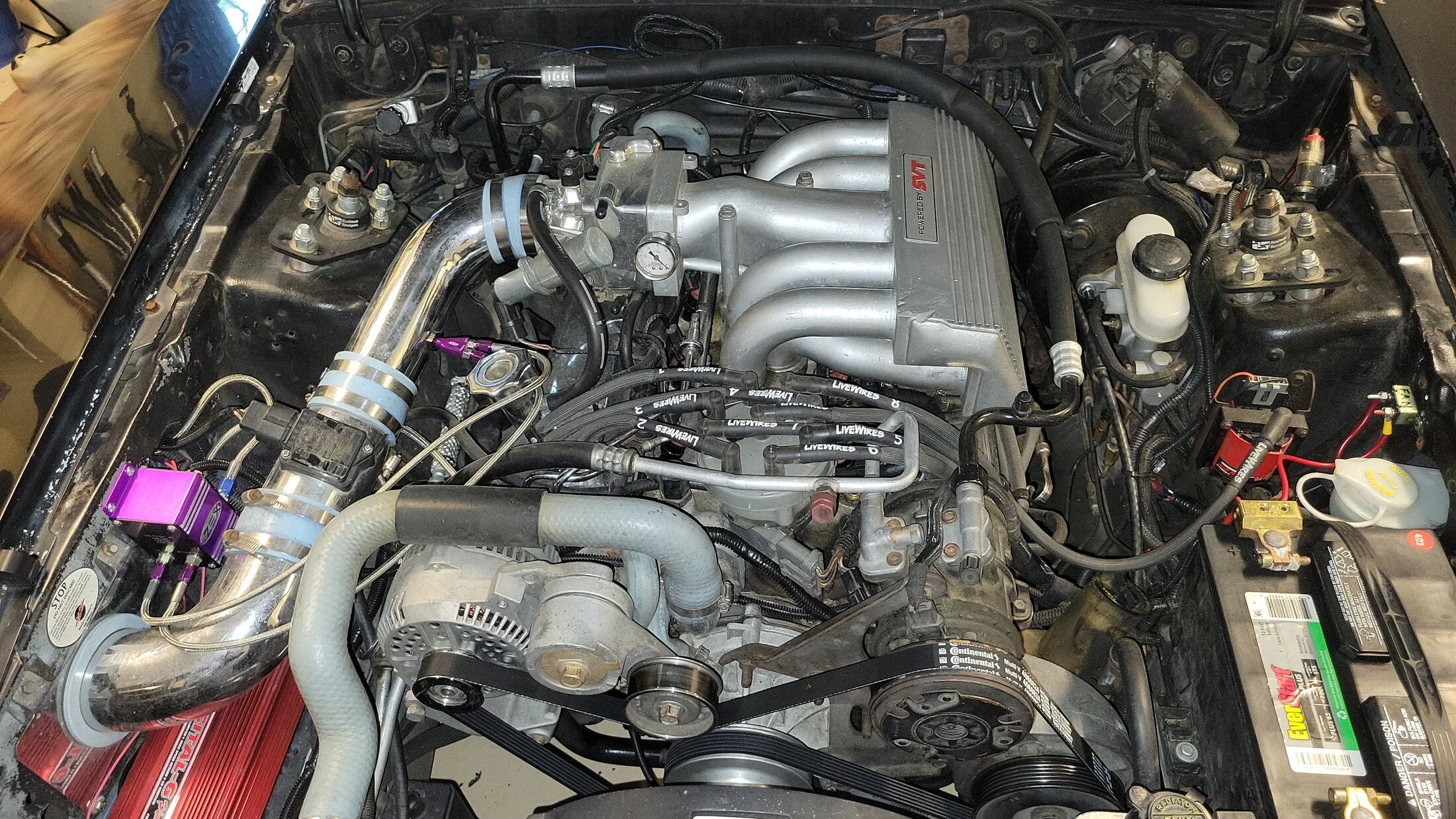

It's all back together again. Another change is that I removed the 1" phenolic spacer. I'll bet it was added because the vacuum port on the bottom of the upper manifold was hitting a couple injectors until I oriented them just right.
The test drive gave me a scare, because temps went from normal to pegging out the gauge the next time I looked. Pretty sure it was an air pocket. I should know better than to drive before burping the system, but I guess I was excited. When I got it home, I idled it and got the T-stat to open, and added about 1/2 - 1 gallon. Now, it's driving great.
