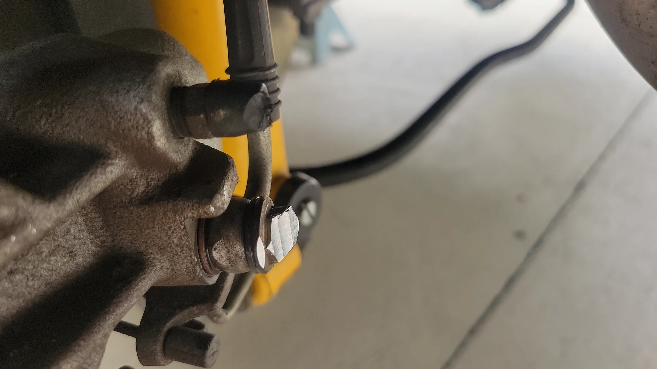

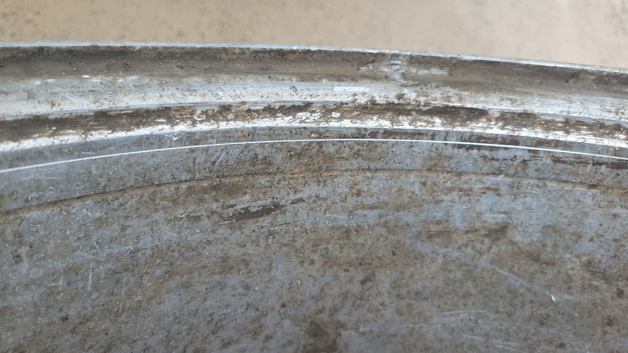

I tried to clearance the banjo bolt, but I'm afraid to go any further. I can still crack it loose, but if I take anymore off, I don't think I'll be able to service the brakes... It's very, very close but still contacting wheel.

What about a wheel spacer?

With the rear Cobra rotors being 11.65" in diameter and the V6/GT rear rotors being 10.5" you could swap to the V6/GT rear brake setup and they would clear no problem. About the best you can do with the V6/GT rear rotors is to get the drilled and vented ones as there are not vented units that I am aware of.

@Noobz347 The spacer idea may still be workable, but I discovered another issue while looking into it. These older Draglites use long shank-style lug nuts, and with the proper single washer the shanks protrude past the rear mounting surface of the wheel and bottom against the rotor before the wheel clamps. A spacer thick enough to address that and clear the banjo bolt would need to be properly made for the application, and I would also need longer wheel studs.
A 3/16-inch spacer might solve both clearance problems, but it would also move the slick outward by 3/16 inch. I have not purchased the slick yet, so I cannot mount the complete package and determine whether that new position will actually fit under the car. There is not much spare room with a 10-inch wheel under a Fox, and I do not want to order a custom spacer, longer studs, and tires only to discover that the combination rubs somewhere else.
At this point I am probably better off selling these for a little more than I paid and looking for a wheel that clears the banjo bolt, seats squarely without a spacer, has the correct lug hardware, and works with my existing roughly 1.5-inch studs. It may cost more up front, but I do not want to keep chasing custom solutions to make a $275 pair of wheels work. This definitely did not become the budget drag-wheel setup I imagined.

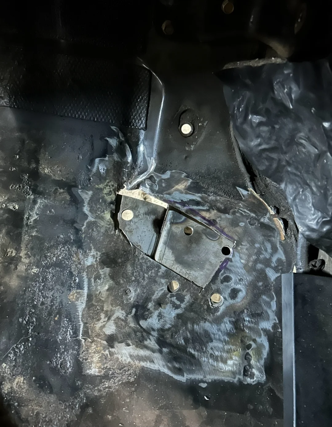

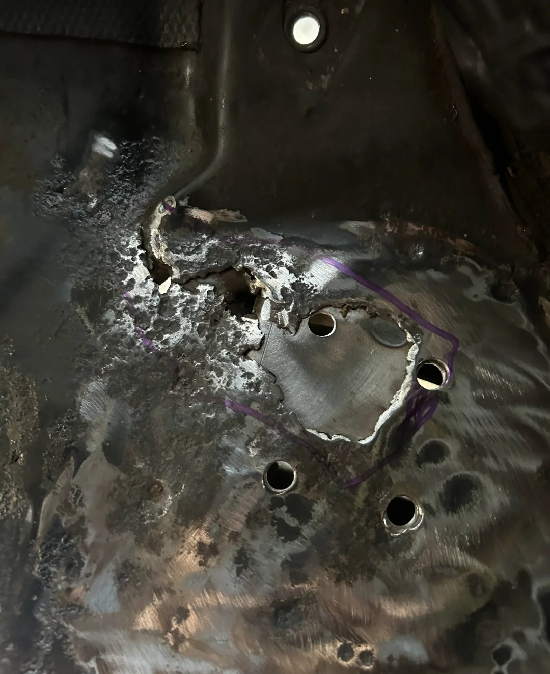

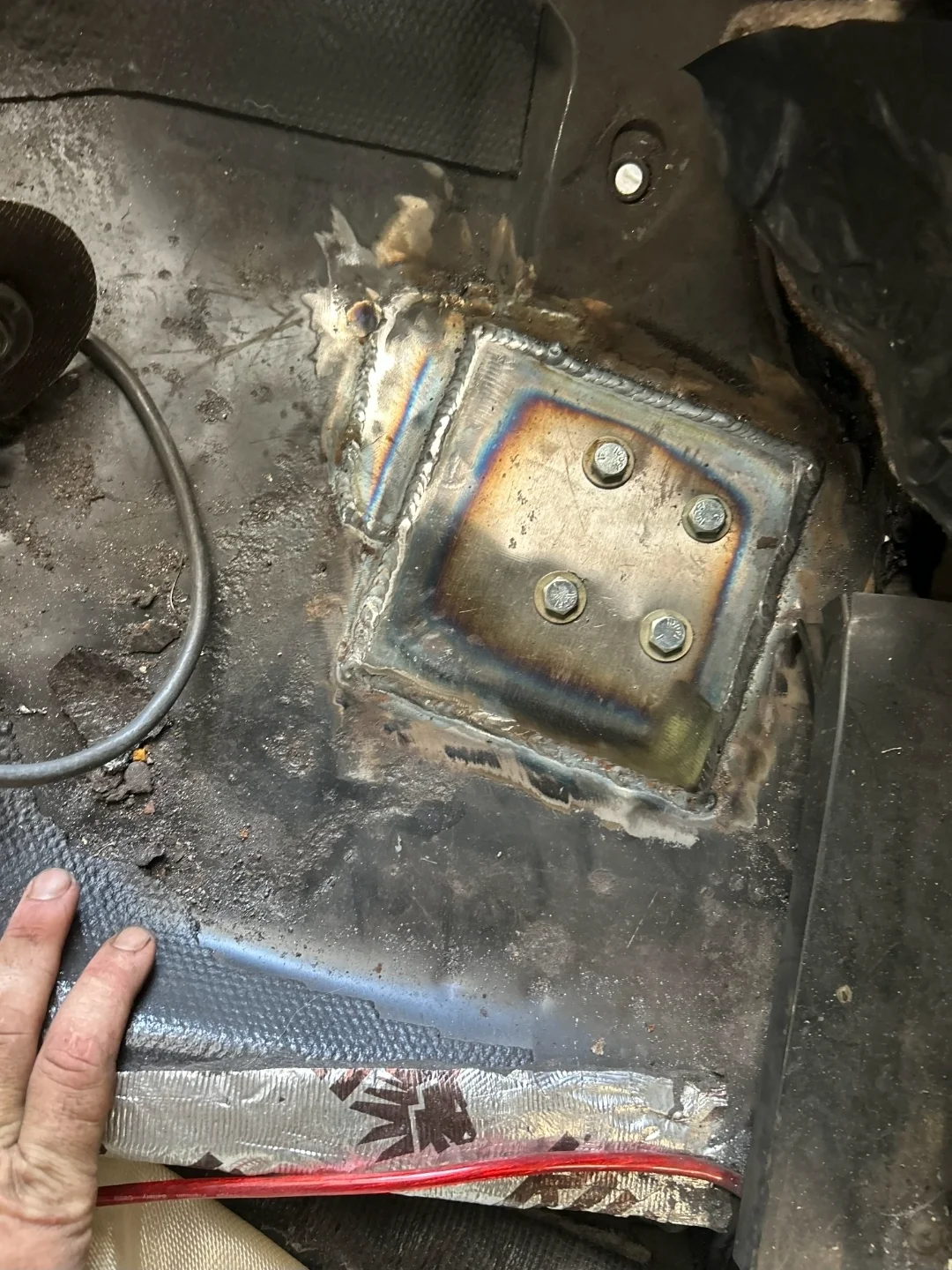

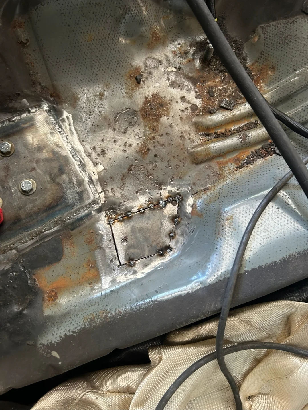

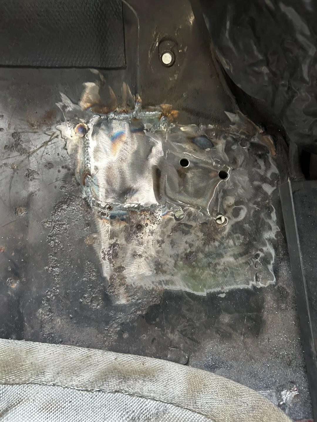

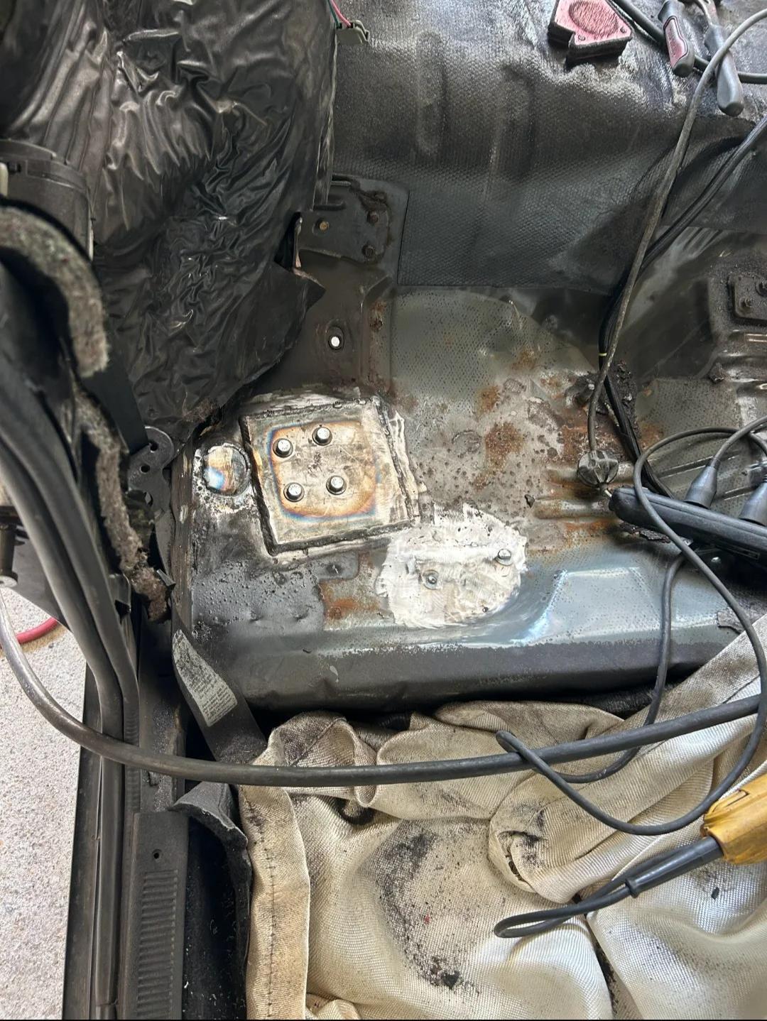

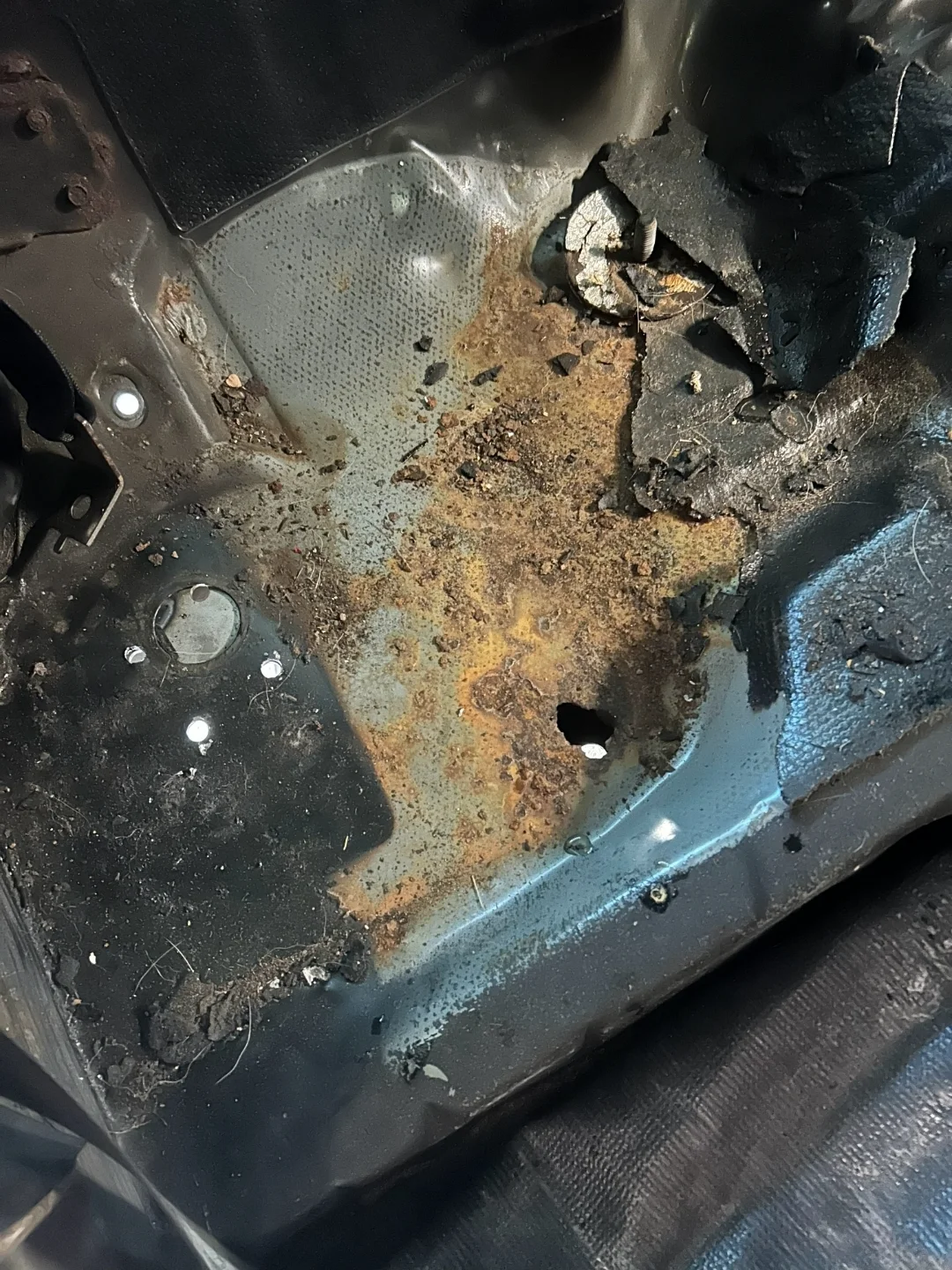

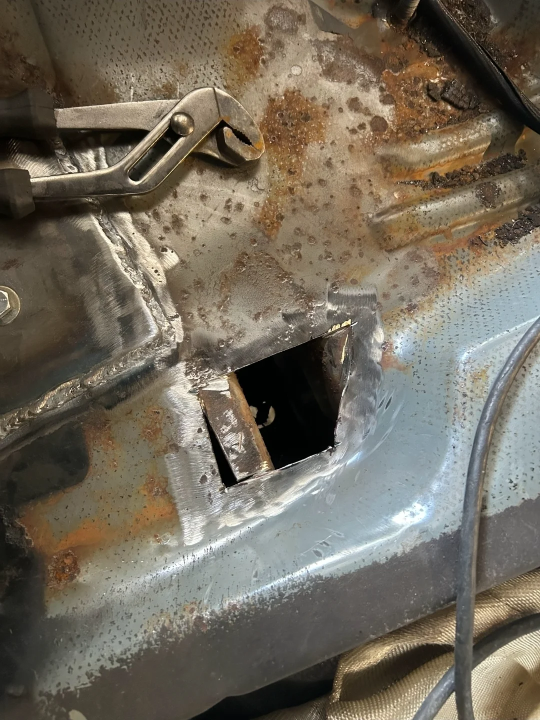

The good news: Black Jack is less of a rust bucket now, the shop that installed the torque boxes also cleaned up some rust holes in the rear floor pan, and now the Wild Rides "Battle boxes" are in, the axle tubes are welded up, & the Stifflers D/S safety loop is in. So, it's ready for slicks and driveline violence!
The bad news: It has a bad engine vibration above 2k RPM. This happened simultaneously with picking it up from the shop, but I think the problem is the stock balancer, as I *think* I can see alit wobble at idle. It needs a front main seal anyways. So, do any of you have a quality but affordable balancer or brand you prefer? I'm not looking to sink big money into this motor while I'm prepping to build another engine in another year or so, but I also don't want to install something cheap that may come with problems, either. Just a quality stock replacement would be nice.
Here's some of the floor pan work:

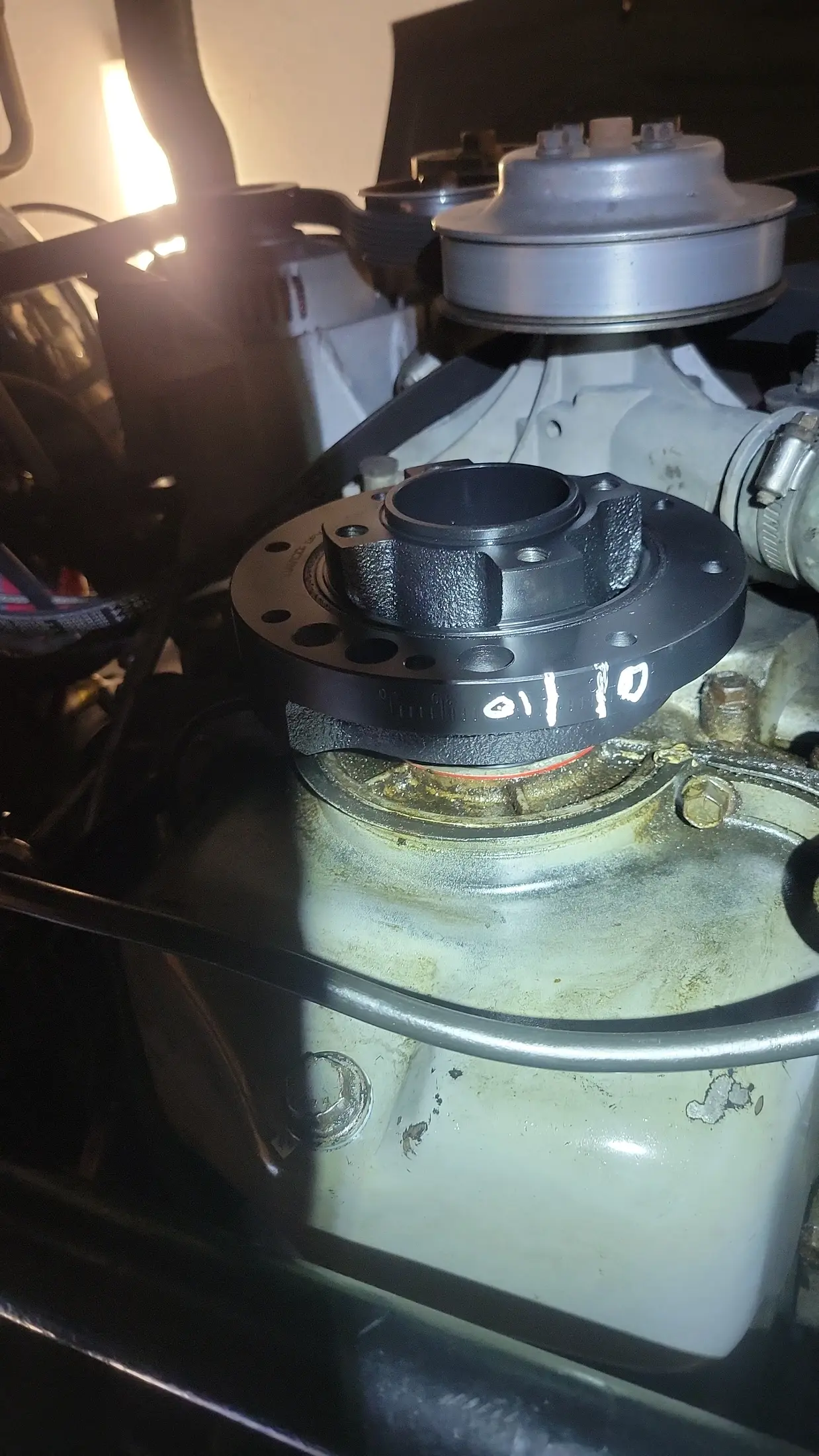

Got the new balancer and front main seal in. The vibration at 2k+ is still awful. I checked the clutch bolts through the clutch fork window and all are firmly in place. I guess this means I'm either wrong about the balance being the cause (maybe a misfire?), or it's time for a motor.
If it's a misfire, it isn't exhibiting any low speed, high load bucking that I usually look for. Still, it's been a while since a cap, rotor, and plugs. So, I'll swap em, try a spare coil, maybe a spare dizzy, and the spare A9L to see if anything has an impact. Could maybe be injectors, too, but that's less likely, I think, as AFRs are looking fine.

So did the vibration just start or has it been a progressively worse thing? Also, is it a consistent vibration or cyclical?

I don't recall if this car has a factory ECU but... Have you done a cylinder balance test?

When the car was at the shop to get the weld repairs and driveshaft loop, did they do anything to the driveshaft? (Drop it, dent it or do anything to change the pinion angle?)
