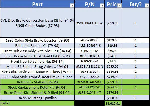

LMR has a step by step 5-lug + brake conversion part ordering process (link) and it looks like it's comprehensive:
I guess the only other thing I'd need is my R58 Cobra R wheels. So, I'd run down this list and compare to Mike's thread before I purchased, but does anything stick out to you guys as missing? The 94-95 spindles are not with LMR, but I found a nice black painted or powdercoated set for $300 on FB, this morning, and many more in the $400 shipped range.
Here's the list of parts from the Conversion base kit:
(1) 93 Cobra Master Cylinder, (1) Master Cylinder Adapter Kit, (1) Proportioning Valve Plug, (1) Adjustable Proportioning Valve, (2) J&M Stainless Front Brake Hoses, (4) Brake Caliper to Spindle Bolts, (1) Cobra Rear Brake Caliper Adapter Kit, (2) J&M Stainless Rear Brake Hoses, (1) J&M Stainless Rear Brake Center Hose, (2) Rear Brake Hose To Axle Mounting Bolts, (1) Adjustable Center Parking Brake Cable, (2) Parking Brake Cable Guides, (2) 87-92 Mustang Parking Brake Cables, (2) 93 Mustang Parking Brake Cables, (2) Parking Brake Cable E-Clips, (2) Disc Conversion Hard Lines, (10) Wheel Studs

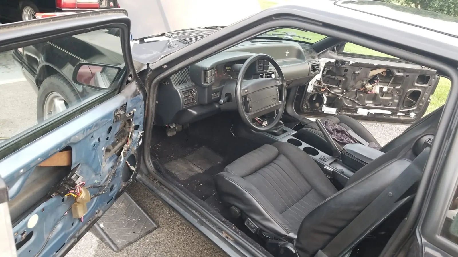

- door controls don't work.
- driver's door won't open from inside.

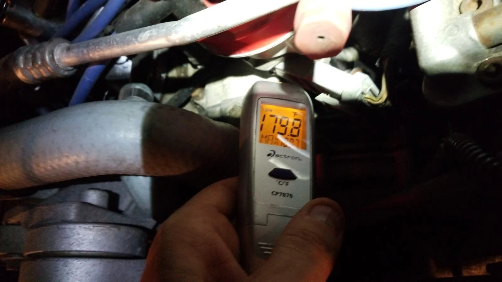

So... I spent all day today, and the better part of yesterday fighting the old fight. I thought I'd fixed the overheating issue, all those years ago. I have NEVER had a fox put up an overheating fight like this, and I'm starting to think that one of the coolant ports has a blockage, if one of the head gaskets isn't turned around.
During a 96 degree day, I was able to cruise about 15 miles, but not with the A/C on. The temp gauge stayed near the top of the gauge, pointed at the "N", which seemed to be in the 195-210 range using an infrared sensor on the T-stat housing. Later the T-stat housing went as high as 230* before I heard what I thought was detonation and shut it down. I swapped the stock water pump pulley back on in place of the U/D pulley that was on it. Then I drained the coolant, pulled out the radiator. The Ron Davis Radiator's fins were clean as a whistle, both inside and out as far as I could tell, and the fluid was beautiful, though probably a 50/50 mix. Pulled the T-stat out -- wanted to ensure there were no air bubble or T-stat shenanigans. Refilled with water only, though there was still coolant in the block. I let it idle with the A/C on and the temps pushed over 195*, this evening while it was 84* outside. It was still climbing. When I shut the A/C off, it stabilized and dropped to the 193 range. Then I spun the motor a little faster @ 1,500 RPMs and the temps dropped quite a bit. That tells me pretty clearly that the U/D crank pulley has got to go, and the stocker will go back on tomorrow.
This one is a bit of a stumper. I think I'll bring timing back down to stock to protect the motor when it's hot if the stock crank pulley doesn't get rid of the issue.

Overheating - what fan is on the car? Stock or electric? Tstat getting stuck? UD pulley is a definite no no. Im no expert, but I did get my turbo car to behave with the AC on in 100° heat.

Stock fan & shroud. No thermostat. I removed it to guarantee there were no shenanigans with air bubbles or the replacement thermostat I put in it.
Look, ya'll:
Black Jack's first wheelie:

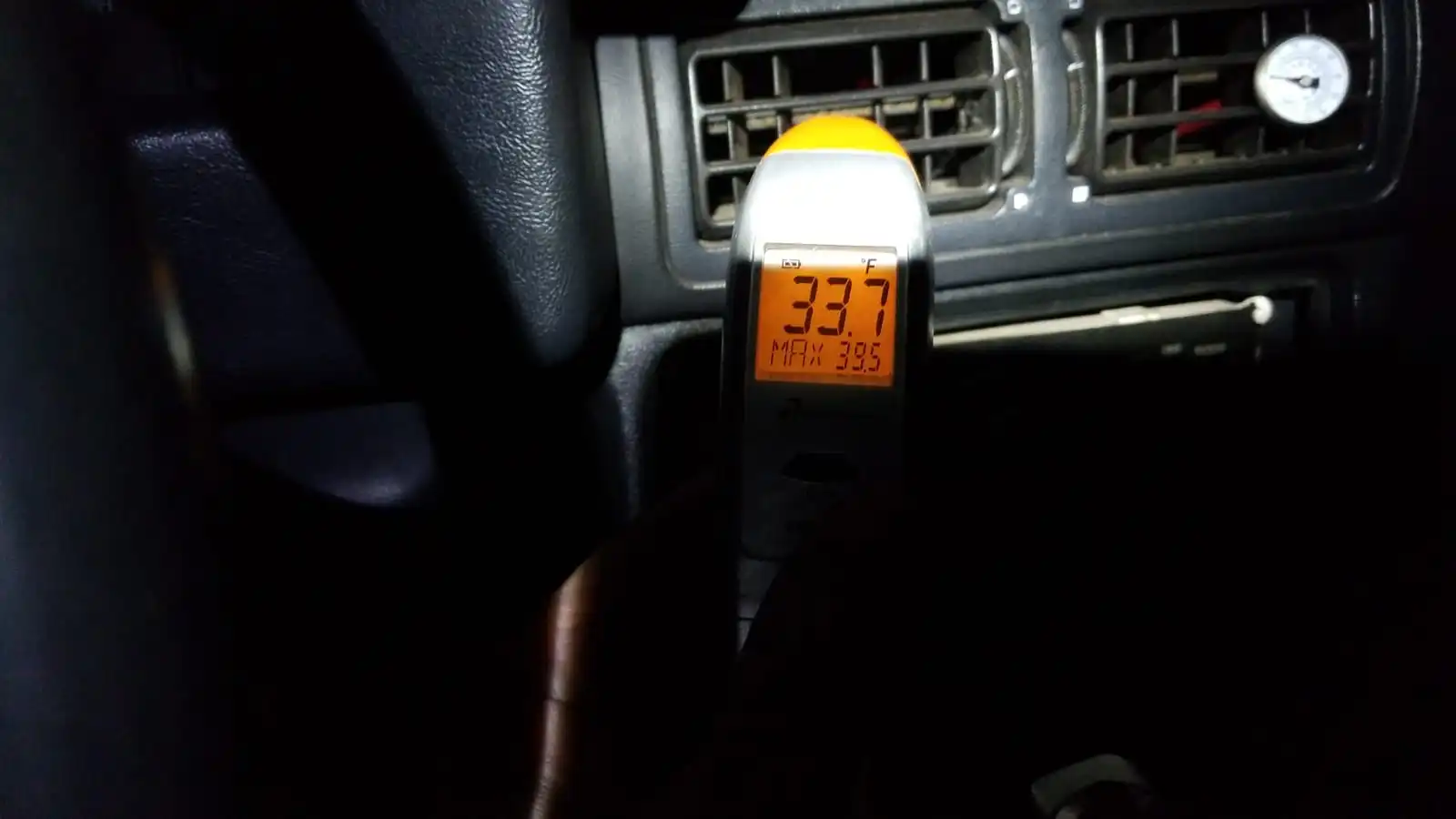

So, anyways, I swapped on a new Steeda Clutch cable. I also put the stock crank pulley back on. In 75* ambient temps with the A/C blowing ice-cold, the t-stat housing temps never exceeded 190*, which I was very happy with. I can live with 220* or so in 100*+ ambient. So, we'll see how it does on the next hot day.
And that was with this coming out of the vents:
So, maybe I won't have to spring for a new radiator and a tear down after all. I will say that replacement fan clutch seems too aggressive, and it really is spinning the S#$% out of the fan. It is REALLY moving some air. I'll keep an eye out for stress cracks, and if they appear, I'll find a contour or Mark VIII fan.
I've got the door panels off, and noticed there are NO door lock actuators. So, I'll be getting to work on that soon. I also swapped over to one of those Daniel Carpenter center consoles with cup holders. The registration's in the mail to Florida. Gonna keep making progress.
There lots of places you can save money on that list, for starters that booster can be found for as little as $60 from the same manufacturer skp...

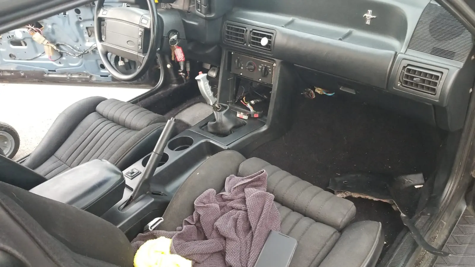

New center console, Tightened Shifter, tracking down what may have caused the line lock to be inop, door panels off and waiting for lock actuators & inner handles to arrive. Swapping A/C control location with the head unit, soon. Hoping ignition switch helps out on a lot of the electrical gremlins I'm chasing.
Took a look at Rock Auto and saw what you mentioned. I'll start checking Rock Auto for more of the big ticket items I buy. LMR is so damn convenient though, I must say. If I do the brake and lug swap, I will see how much more I can save.

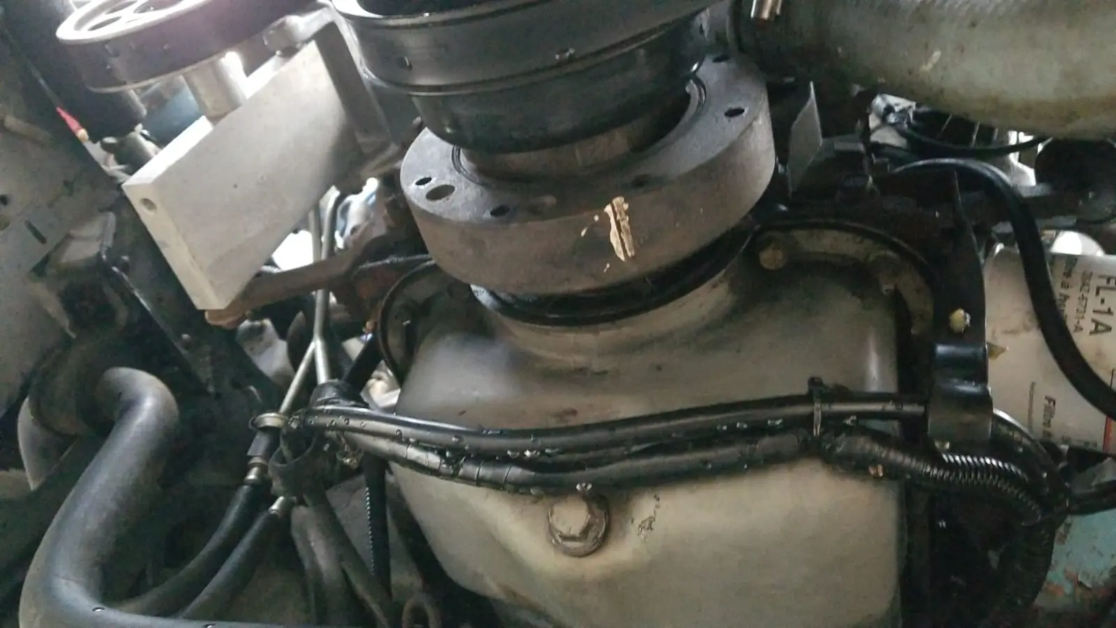

I dont get why do people still buy delete pulleys lol, I can understand with blower brackets that where designed around them but never under stood how they sold those vs just buying a new $20 belt and removing the old pump and bracket. Whole lot cheaper and cleaner
As for the rock auto/ parts store stuff vs specifically shops I get there in it for profit and its convenient, but damn the mark ups are getting a bit high for some parts. I still like my old school draglites so my last 5 lug swap so I did the "gt" brakes, most expensive thing was the custom axles since I did 9" ends but was still no where near 2k in parts redoing the whole system.
Ha! You noticed the pulley. Yeah, I agree. I never understood that one, either. Maybe it's so you can do an alternator delete, too :O_o:

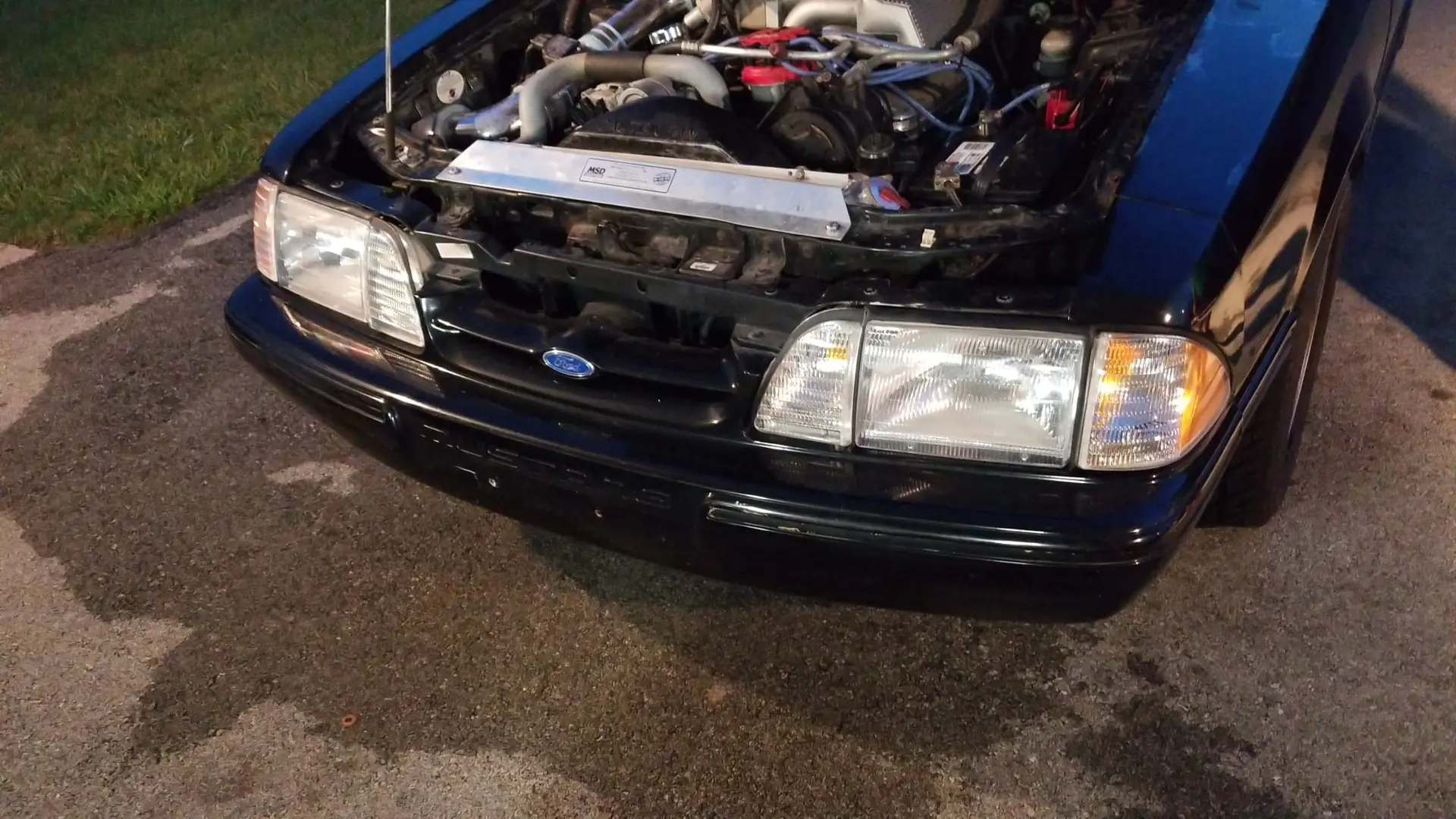

New headlight finishing (trim & backplates) kit:

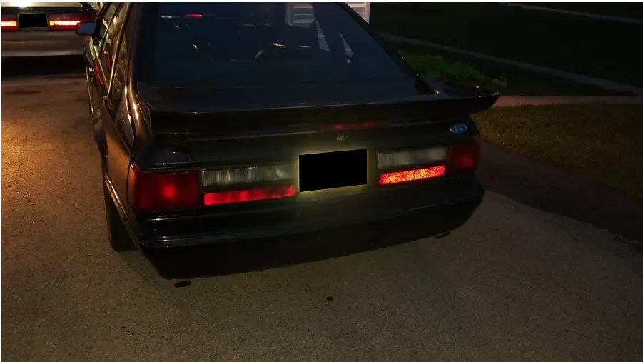

New left rear tail light assembly:
