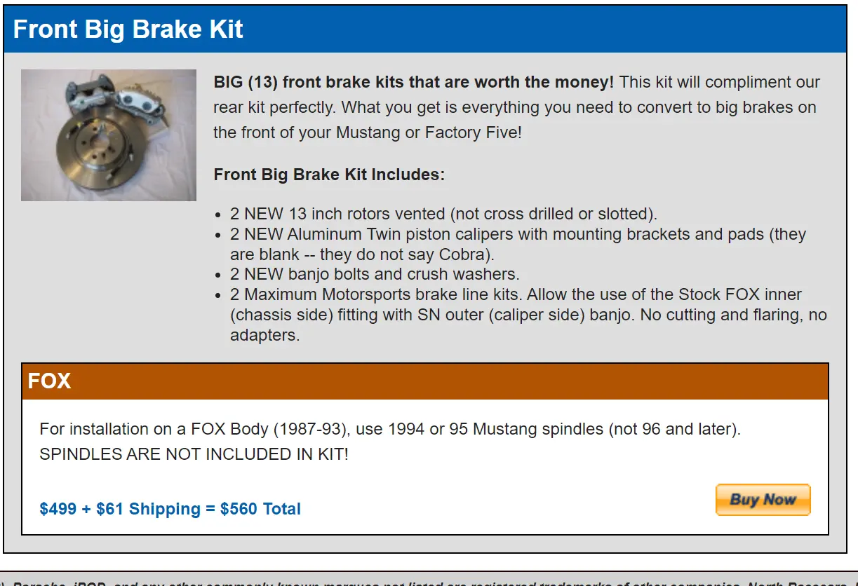

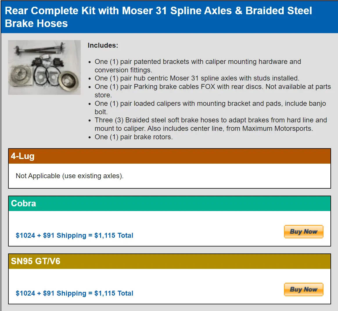

Just saw North Racecars's 5-lug conversion & Cobra brake kit in this Powernation video.
https://northracecars.com/c-clip_brakes.html
I guess he basically came up with his 'patented' bracket, brings 3rd party parts together, and gives it a small markup. I wanna follow up and compare this to my previous 5-lug swap list post, but coming in at less than $1,700 shipped seems pretty reasonable.

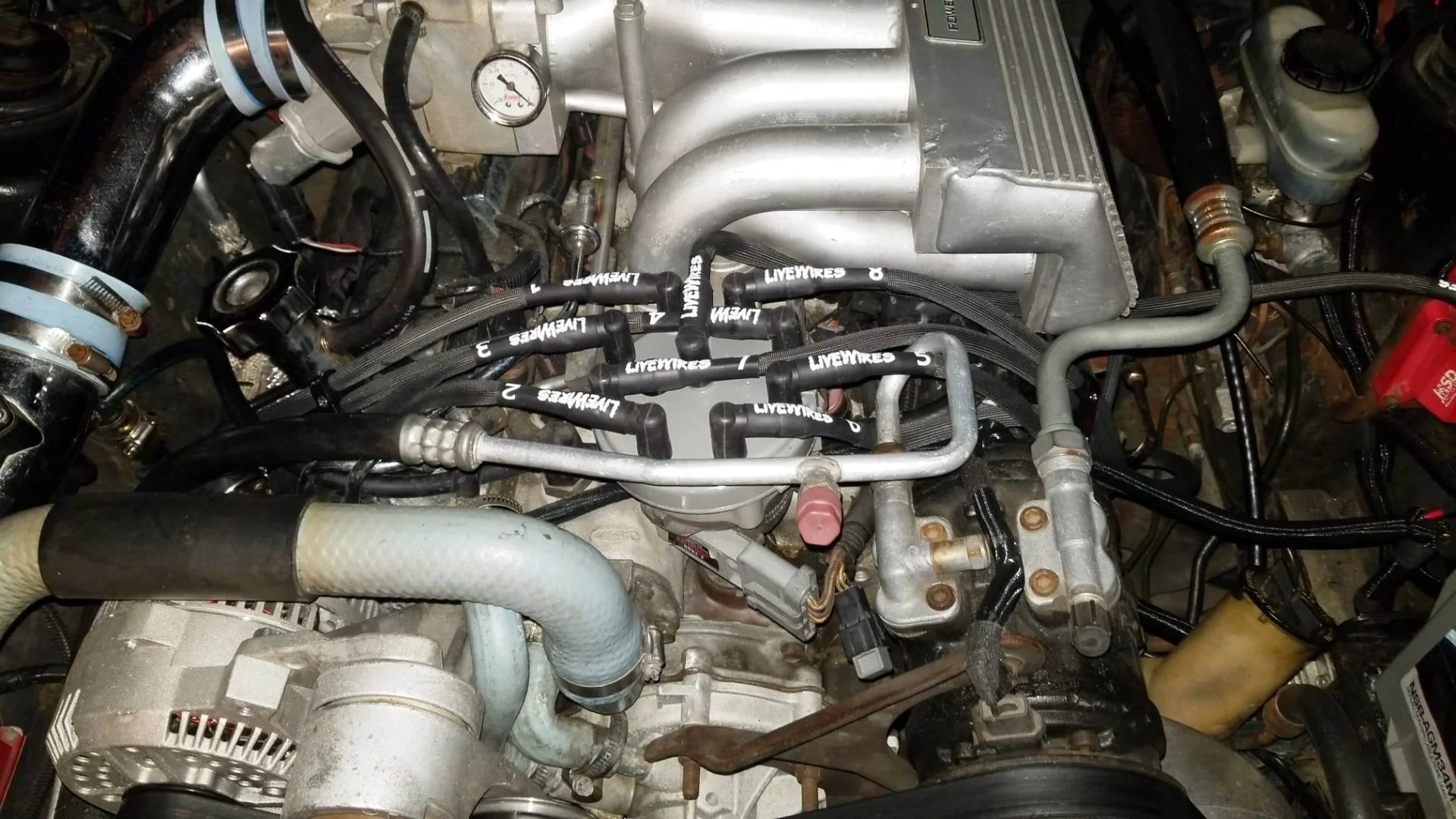

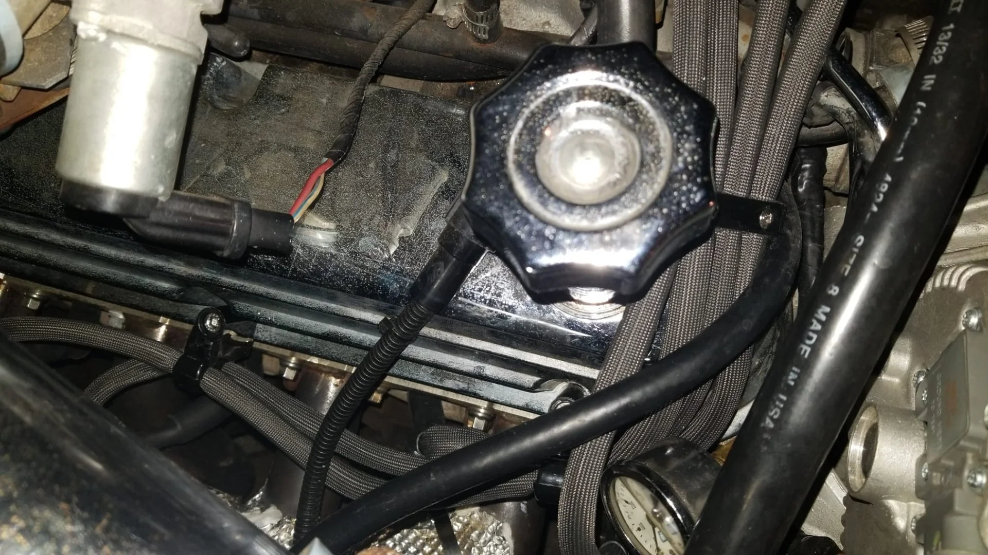

Not much of an update, but the only thing I've done on the car since Foxtoberfest '22 was this swap of plugs (Autolite 3924's), wires (LiveWires), cap (Motorcraft) and rotor (Motorcraft) swap. I chose the wires I saw on a few cars at the show that stood out. I've only ever ruined wires by #1 melting a wire that laid onto a header, and #2 melting the boot in a tight turbo exhaust engine bay. The Accel 9000 series wires took care of #2, and I think these will be the ticket to preventing #1. The full-length wire sleeves are apparently good for up to 1,400 degrees.

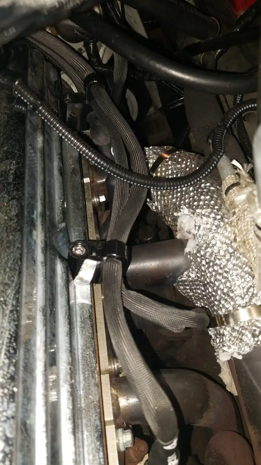

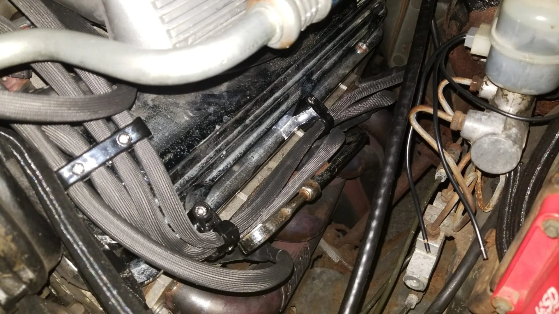

Of note: I've never before used the Taylor 10.4mm Vertical Wire Loom Kit that sends the wires straight down the valve covers to their respective plugs. It didn't turn out as sexy as intended, but at least it looks like it was organized intentionally, and gives me piece of mind that everything should stay put:
Reverse view on passenger side looking towards the front of the engine bay:
I figured it wasn't a bad thing to do on the car, given the age of the previous parts, and maybe, just maybe it might explain why there's this light ticking sound at light load, usually between 1,500-2,500 RPM, that almost sounds like it could be errant sparking, but that did not turn out to be the case.
I found this rotor, pads, and rebuilt caliper kit on Prime for under $200... The MM hoses are under $100
I'd like to get that 5-lug & brake parts list down from the $3,000 I originally posted to less than 2,000, and preferably down to 1500 bucks. At that point it's pretty much a no-brainer.

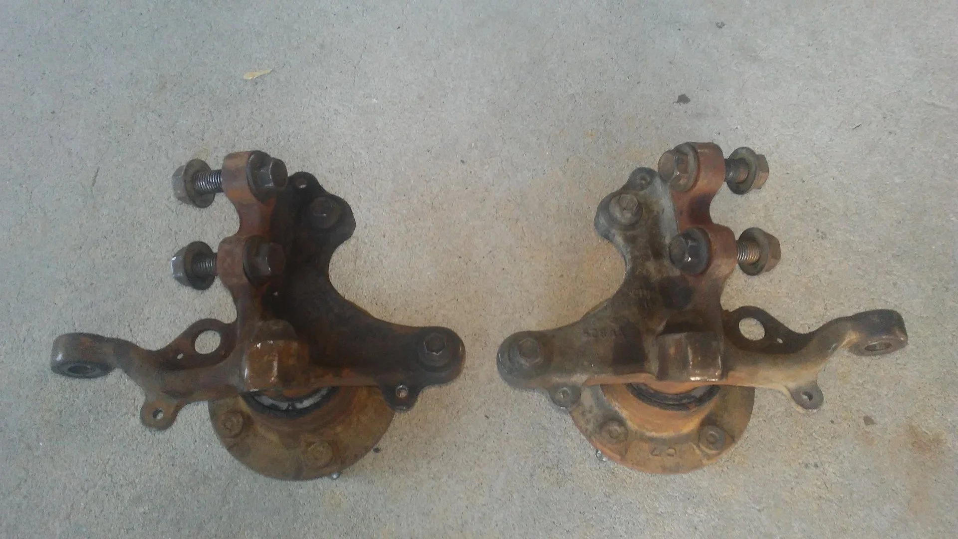

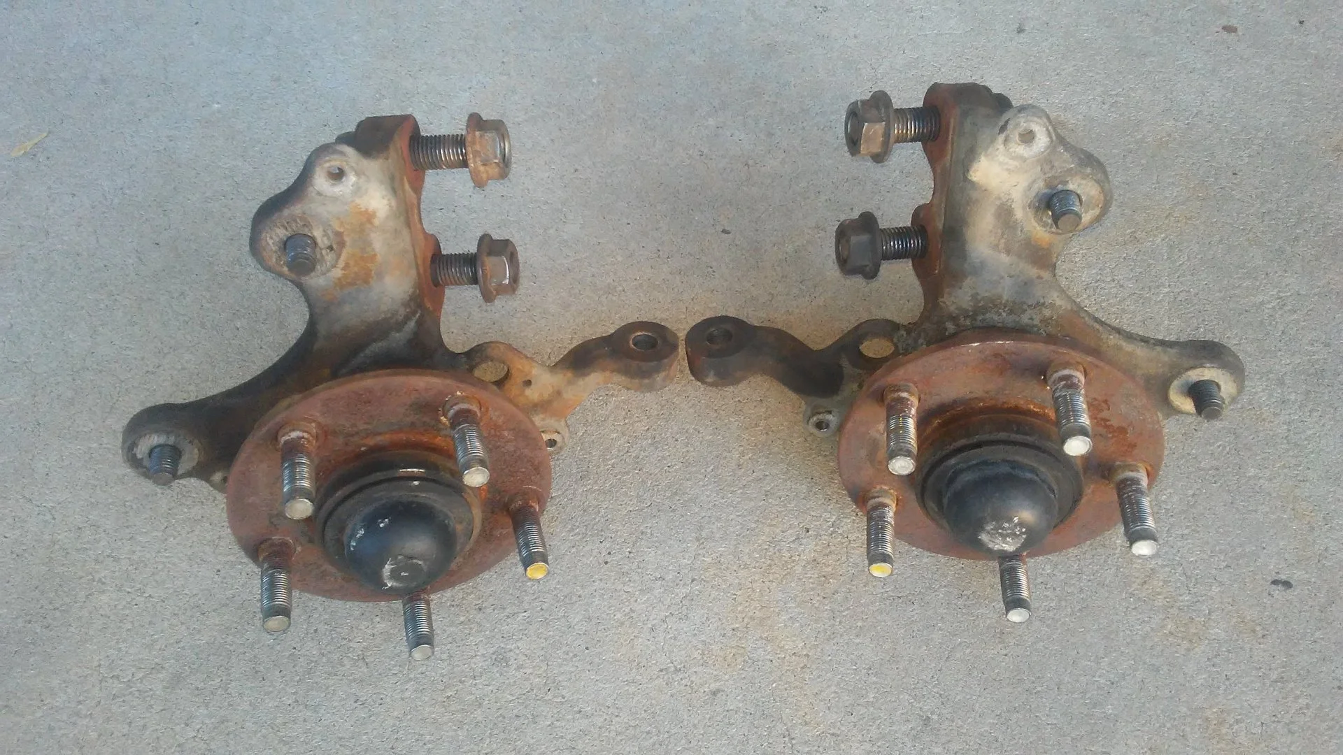

Do you already have the spindles?(I know it’s prob in previous pages somewhere) They’ve definitely gone way up in price over the past few years.
Reactions: jsgif99
You can run the 96+ spindles but you will need a bumpsteer kit. I ran the 96+ spindles on my Coupe with a factory k-member for a couple of years before going with a MM k-member but I planned it that way. This is the bumpsteer kit I got:
When I swapped to the MM k-member I just called MM and got the spacers and through bolts to covert the tapered to the through bolt which you need if the car is in lowered very much hich both of my cars are. Might be 1/4" from the top of the tire to the fender lip.
You have to drill the spindles out with a reamer to get the bolt through so that is another added expense.
So if you are going to keep the factory k-member I would just run the 94/95 spindles. If you are going to swap to a tubular k-member later down the road (most are designed off the 96+ spindles but you need to verify) then you may want to go ahead and get the 96+ spindles now.

Pretty sure I have 96 spindles on one of my foxes already. Works fine. But like you and @Mustang5L5 have said, this is a stock k-member. In any case, I just got a PM with these pics and a $250 shipped offer on corral. Unless something seems off to anyone, I'llpull the trigger on em:
Alright... So, that deal is complete. 1 set of spindles down, rest of the list to go. Man... I've got this vision of a Black Jack with 5-Lugs, Cobra or better discs front and back, a T-56 with the 2.66 1st and .5 6th to tame the 4.10s, and a 150 shot wet kit. It feels pretty good! What a fun little street car!
$250 is a good price for the 94-95 as i've been seeing them go for $400+.
I still have my set but holding on them for a potential future project given how spendy they have gotten. I went 96+ when i swapped to MM k-member, but i measured my bumpsteer and I could have gotten away with the 94-95 but the spacer stack would have been huge. Not really an issue for cruising down to the local car show.
