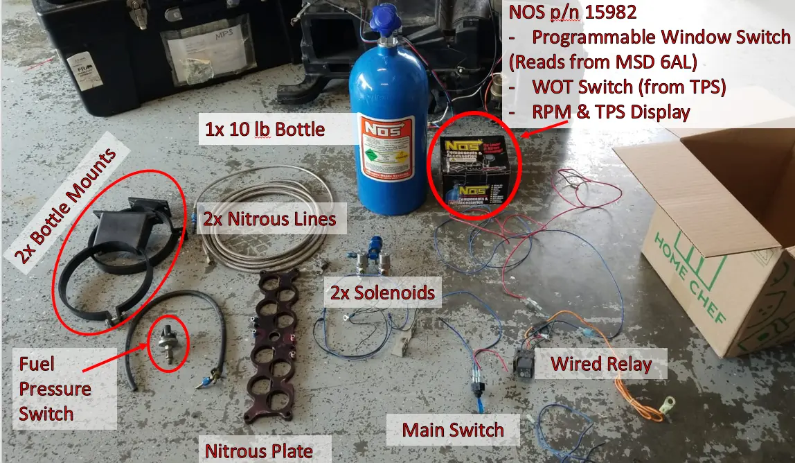

Here's what I currently have:
What I have:
- Nitrous Bottle (10 lbs)
- Bottle Mounts (These little plastic ones are safe in an accident?)
- Hobbes Switch
- WOT & Window Switch
- Arming Switch
- Relay
- Nitrous solenoids x2
- GT40 intake nitrous plate
- Nitrous lines braided steel
- vacuum hose and couple fittings
- manual WOT switch (not labeled)
What I may or may not need (will be edited as I learn & figure this out):
- Fuel solenoids (If I want a wet kit)
- Braided steel fuel lines
- Appropriate jets for fuel and nitrous
- appropriate wiring
- GT40 intake gaskets
- Probably a different Hobbes Switch (dry kit is supposed to vastly increase fuel pressure, whereas wet kit should keep FP @ base pressure of ~40psi, right?)
- GT Light/fog-light switch (Fog light switch will serve as my main nitrous arming switch)
- bottle heater/blanket?
- electronic bottle opener (necessary?)
- timing retard box?
- bottle pressure gauge
Goal:
- I'd like a ~150-200 shot range. Don't wanna blow the motor and would like to keep the power block-safe (max 500hp).
- Not dead-set on a wet kit, but am under the impression this is safer for the fuel system, as it doesn't require high fuel pressure (overtaxed 30 lbs injectors & old fuel pump) as the primary driver of fuel delivery. Also, since fuel pressure can stay at base pressure, I won't need to swap a high-pressure pump for the current old-school Walbro 255 LPH pump & the hobbes switch can be set just below the base FP setting without worrying about the variable dry-kit FPs.
So, I'd appreciate feedback from any of you nitrous guys, but here's my starting point to do research from.

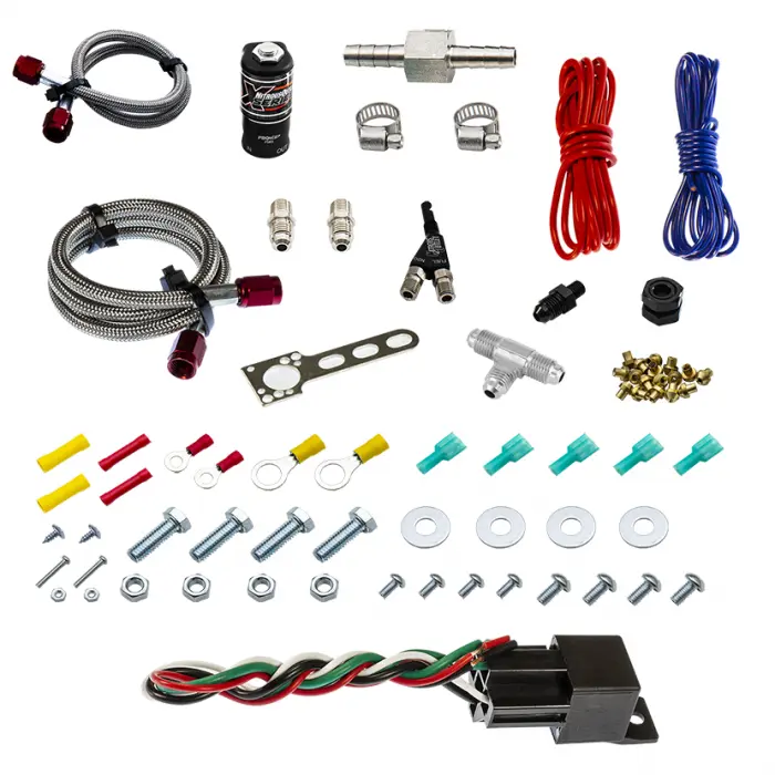

NitrousOutlet makes this dry-to-wet nitrous conversion kit:
Includes:
- 200 HP fuel solenoid,
- 200 HP 1/16" NPT wet nozzle,
- nozzle adapter,
- fuel T fitting and fuel rail adapter, hoses, hardware pack,
- solenoid bracket
- jetting for 35-50-75-100-150-200 HP.
This might be all I need to convert from Dry to Wet.

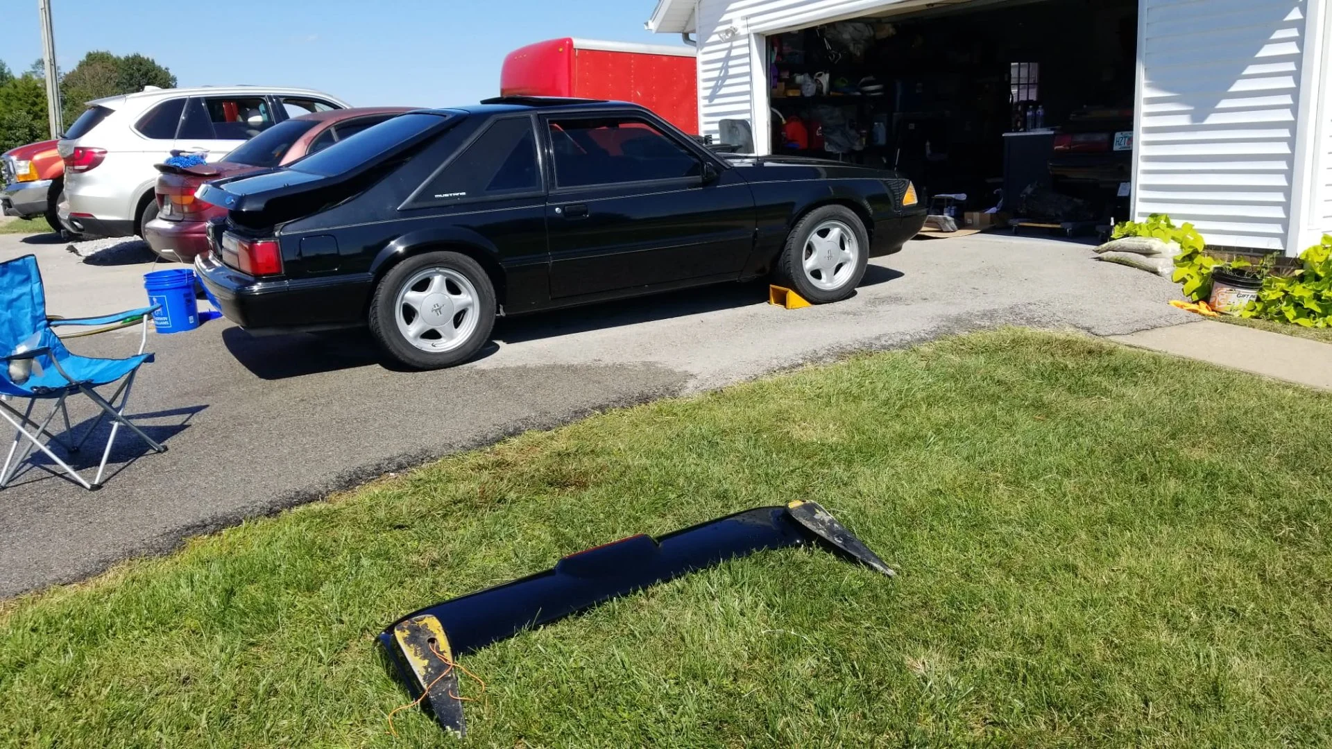

Hated the whale tail so much, that...
I took the damned thing off, even after realizing I'd have to break out the bolts holding it together... and... we'll just have to see how this goes, inspite of my lack of body-work experience:

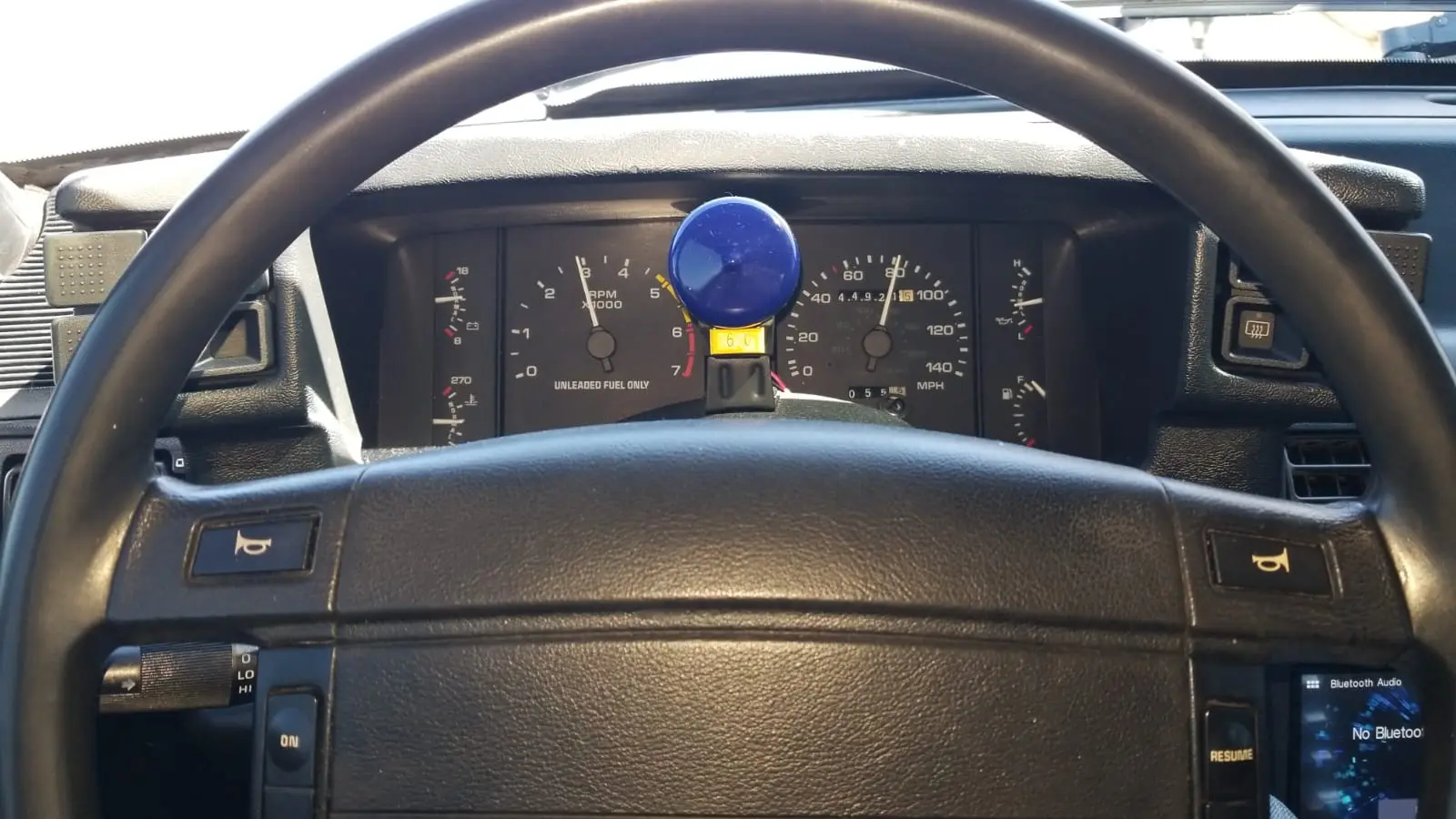

This is probably a dumb question, but I'll ask nevertheless to provoke thought that may be helpful. Is this oil gauge a little low?
Gauge Cluster pic/ Low Oil pressure? / Tick (valvetrain?):
Oil Pressure w/ 10-30:
The pic is just for informational purposes to show that the oil seems a little on the low side of things to me at near 3k RPM. Today, I swapped the oil out for 0W-40 because I hoped it would, and I think did, bring the pressure back up at warm cruise. This pic was taken 2 days ago on a 160 mile round trip. So, the oil temps were nice a warm.
I am getting a ticking sound at light load between 1,500-2,500 RPM, where I hear it the most. It doesn't seem to happen while cold. It's coming from the passenger side firewall/fender area. I think it *might* be valvetrain. I hoped going to 0W-40 would bring the pressure up and alleviate any valvetrain tick, but that didn't happen. The tick still happens while stopped A/C & blower off, but I can't hear it from the engine bay, even while my buddy in the car could still hear it. I'll try a mechanic's stethoscope next time, but I'm starting to wonder if its really something in the cabin.
Gauge Cluster:
Other notes from the pic, I seem to remember my old cars being lower on the temp gauge with a 185* T-stat, but this is where this car stays consistently and it is reading right at the T-stat housing with an IR temp gauge. The voltage gauge reads very comfortably where you can see it and puts out something like 14.5-14.8 IIRC. Now, with the 3G alternator, it doesn't care whether all electrical systems are at full load. It stays put right where you see it.

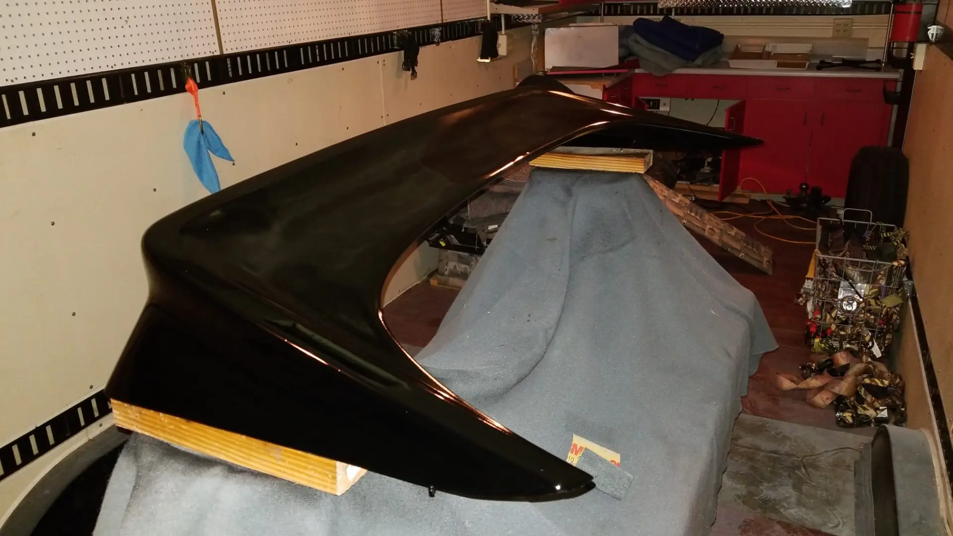

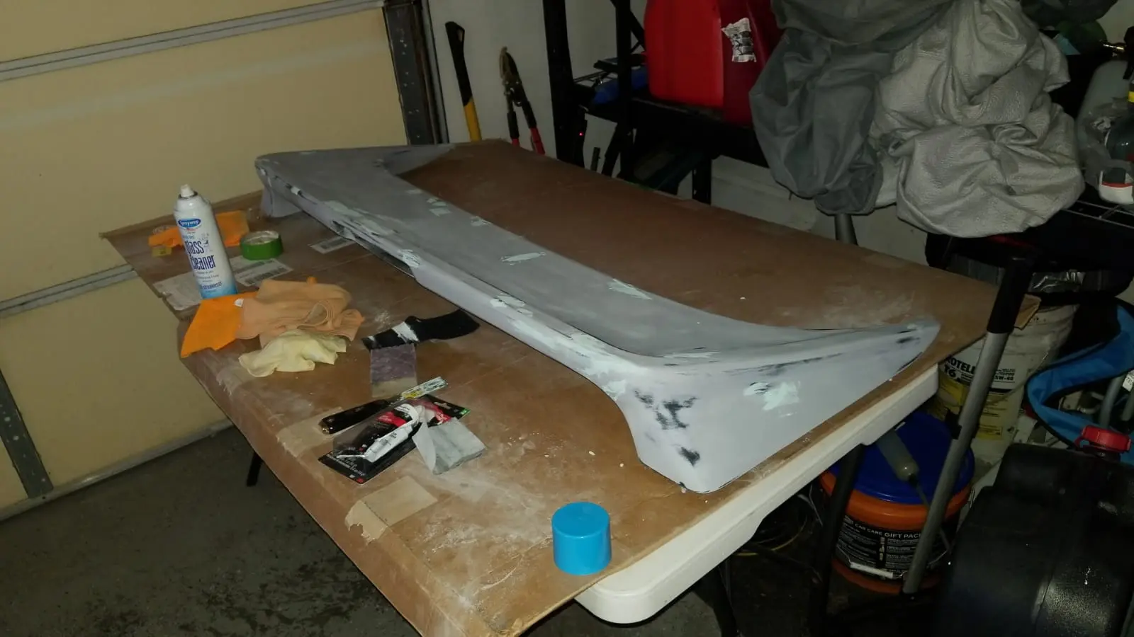

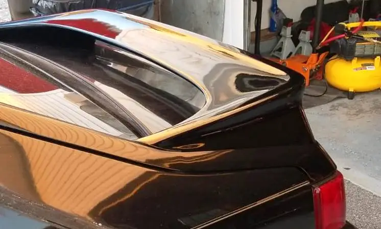

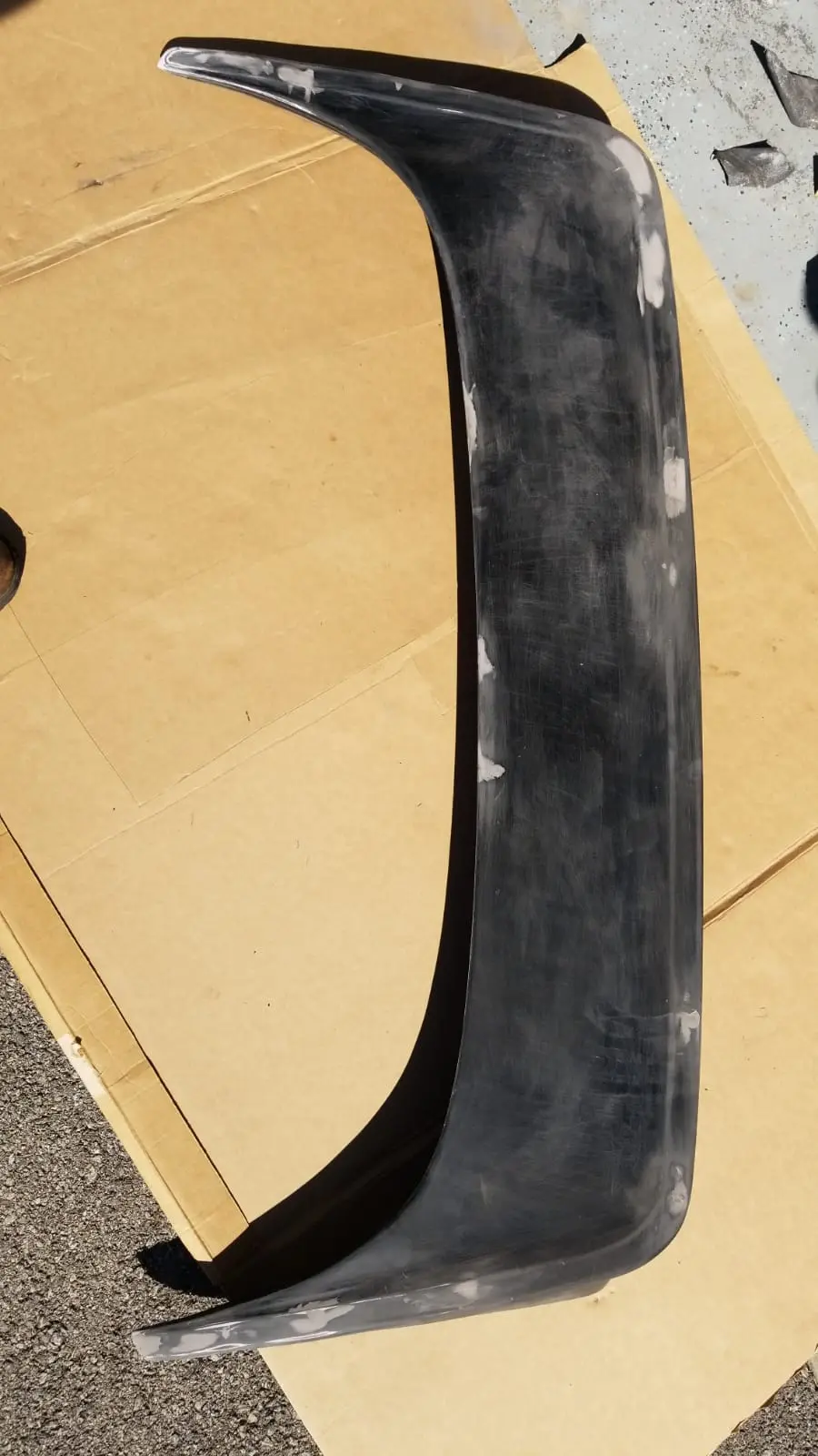

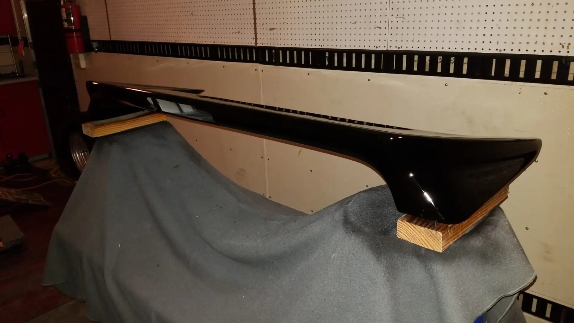

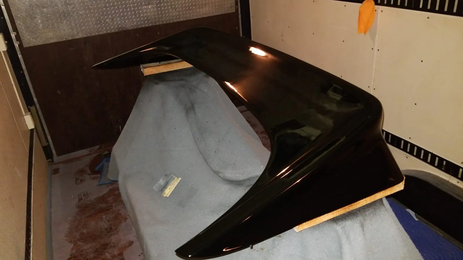

Pics of the rattle can sprayed GT spoiler installed on car coming, hopefully, tomorrow. Finished paint today. Just need to figure out how I want to seal and mount it. I think it turned out well for a guy in his garage using a $40 used spoiler with a bit of fiberglass damage & $20 cans of paint, but I wonder how bad it will stand out against the faded black of the rest of the car. I looked at it in the sun a couple hours after paint next to the car and I'm hoping for the best! I could have left it primered and it still would have been an improvement over the Saleen Whale Tail.
You can see how the spoiler looked before primer/filler in post #150 above. Since then, here it is after primer/filler and then paint:
No
The 90-93 oil pressure sender is a switch. As long as the oil pressure is in a proper range, it points somewhat in the middle and barely moves unless extreme.
The pre-90 sender is an actual sender than can show slight fluctuations. I've seen mine move from L to N. Apparently that makes people nervous, so Ford went to the dummy switch.
Along the way, people replace them with the wrong year. Do you have the pre-90 larger unit that looks like a bell? Or the later slimmer switch?
At idle on a hot engine, my oil pressure gauge points to the L. On my mechanical gauge, that was still 30-40psi, which is plenty for idle.

Careful with the 0 weight oil. I would stay 10W-40, 10W-30, if you really need thin oil in colder north 5W-30. These pushrod Windsor don't like any of that new thin stuff.
I also have noticed fluctuations in my gauge on my 92 with the "bell" style sender.
Reactions: FastDriver
0W-40 oil is thicker than 10W-30 weight oil at cold startup or in winter, even the 0W variety. I researched and wrote this all up years ago. I wanna say it's thicker than 30 weight all the way down to -30*F, give or take. It stays thicker all the way up through operating temps.
