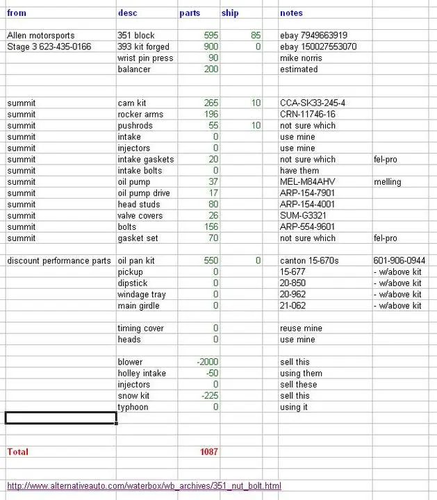

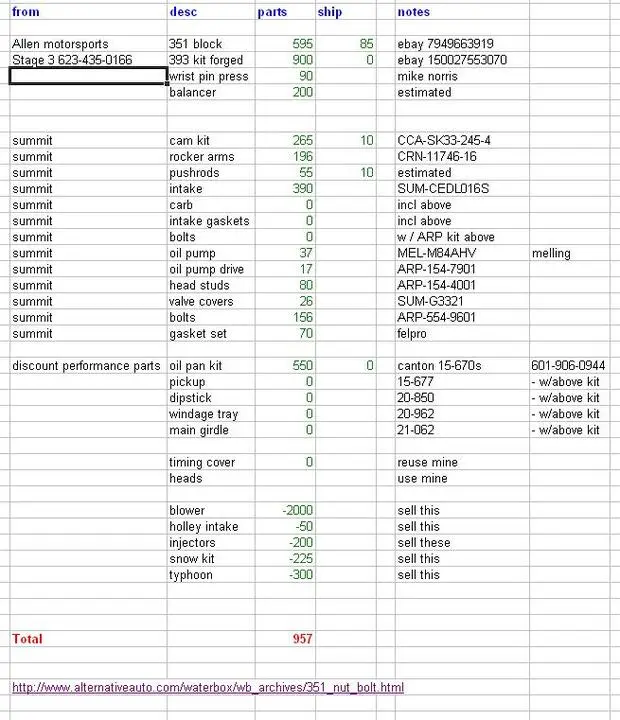

Why are the 351s getting a full oil pan kit with a windage tray/girdle and the 331 gets nothing? Thats a BIG chunk of change in the difference in the 2 builds, im not sure if u have a special reasoning for this but for layout purposes, u gotta build them with "equal" parts to compare the prices. Thats kinda like comparing a quality build to a economy build...ofcourse the economy looks cheaper.
And are u gonna have the 331 balanced to 50oz? Cause im assuming u're gonna be using the same balancer for that build, what about flywheels? I dont know enough about strokers but it seems that most go with 28oz. if not less on the imbalance.
Other than that, those were just the couple things that jumped out to me. I hate making these kind of decisions cause it always seems like u cant make a 100% positive decision on one route....GOOD LUCK! :nice:
the main reason is that i need a pan anyway and this is a kit for it. 5.0 wndage trays are like $50, but a stroker main cap girdle is like $325. but like you said, to be "fair", i should add them
i dunno, i was kinda hoping i could use my current balancer (it was just replaced), but thinking about it, probably not. :shrug:

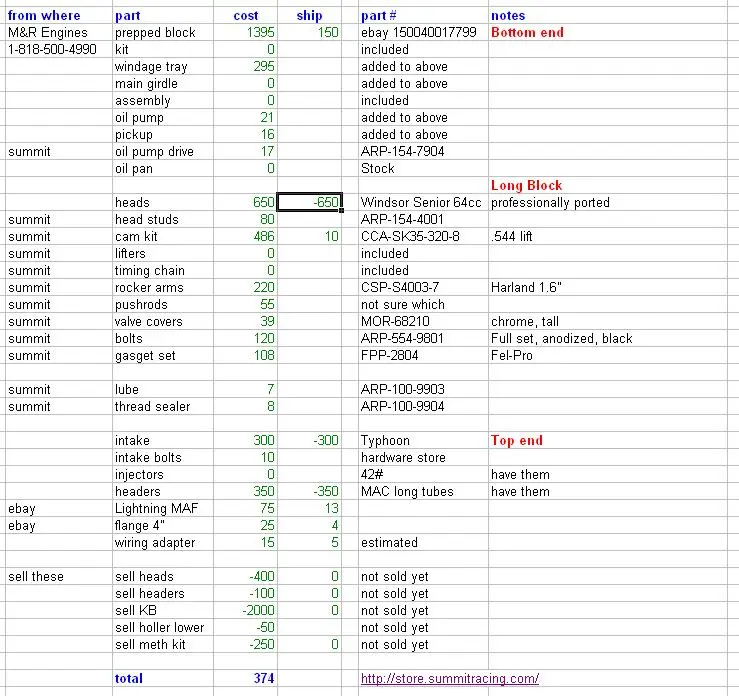

I called M&R and the guy said can include both the girdle and tray when they put the shortblock together, for $295 :nice:
they can also put the oil pump and pickup on at that time as well, also for less than the cost of the parts from summit
