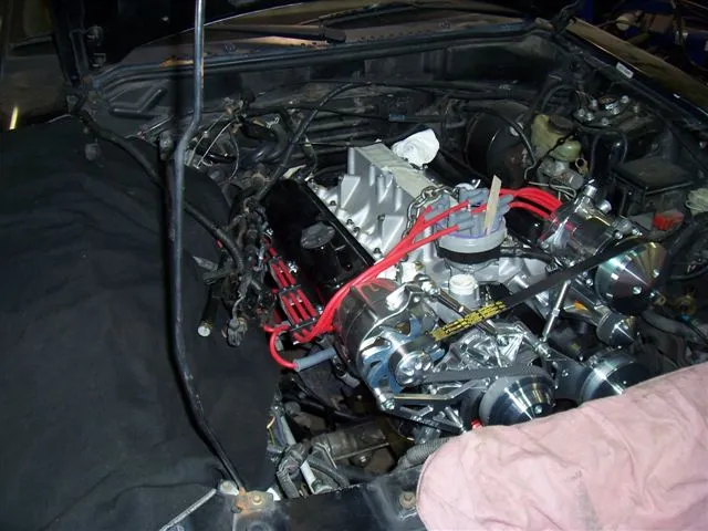

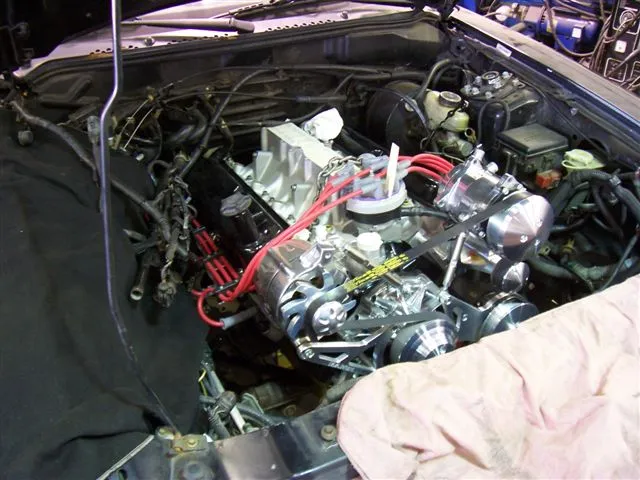

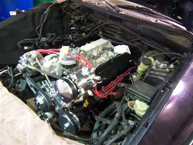

a few pics of it in the bay ...
Its good to be seeing some progress :nice:

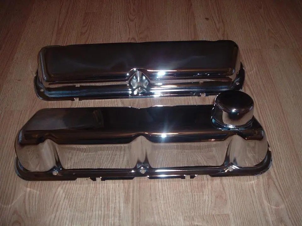

I forget if you previously mentioned it but are you going to be using the polished tall valve covers that were on the engine like in your avatar pic? Looks real good now, I can't wait to see it with everything buttoned-up.
the tall ones were too tall and hit the intake, and i don't want to use a spacer because i am already worried about getting it under my hood. but stock height valve covers clear the rockers (thank god!), so i got some stock height chrome covers.

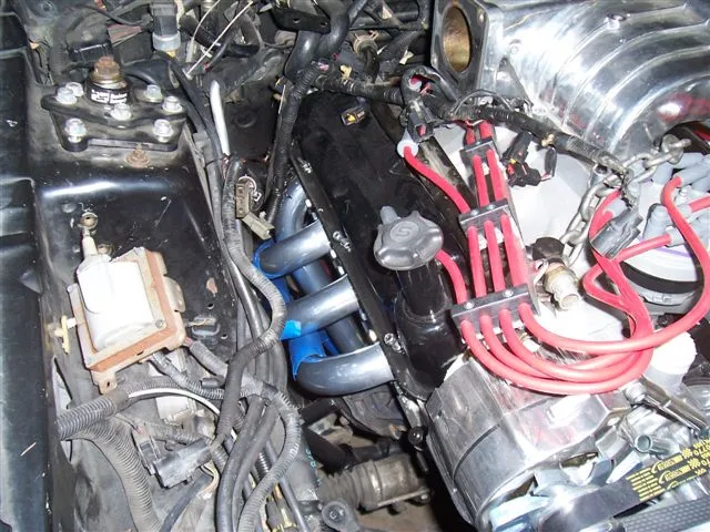

with the intake and long tubes ... the blue stuff is just tape to protect the headers during installation. my mechanic says they fit great and he didn't have to do anything to them at all as far as making them not hit anything.
he also said that it does fit under the hood; the only place that is sort of close is the front corner of the a/c compressor, which is about 1/2" from the hood.

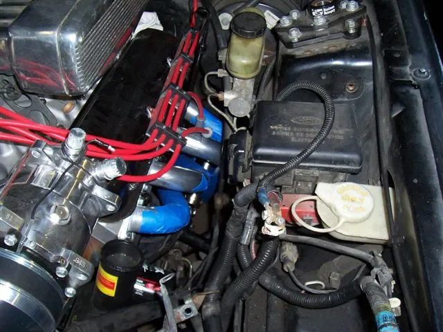

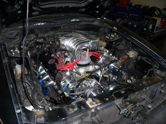

I was wondering if I could use my existing headers if I stay with my Trick Flow heads. I re-iterated to Rick (the guy that is building the engine) that I want to be as close to 400rwhp or over if I can with passing emissions in MD and without too much "rock and roll" from the cam. I know he can't guarantee any of that but as long as we are in the ballpark I will be cool. I assume he will let me knw if we can't do it.

they are kooks headers. :nice:
i think the problem with 302 headers on a 351 is not how the headers fit with the heads, it is down below re clearance issues with the k-member and the other stuff down there.
