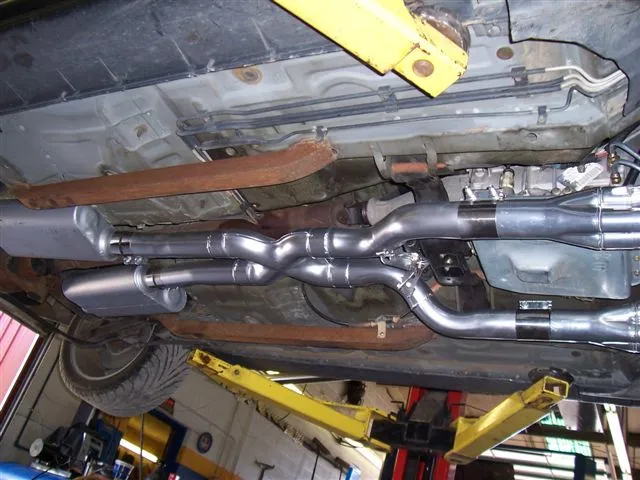

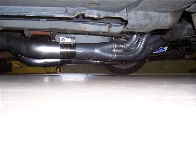

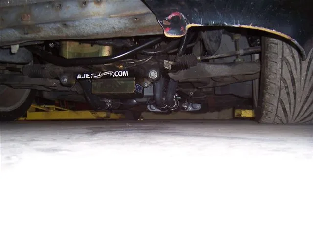

update ... it is running! he started it up over the weekend. sounds awesome, but too loud for my tastes. it has 3" collectors,
3" magnaflow x-pipe, 3" mufflers (flowmaster delta 50s). it goes down to 2 1/2" over the axles and out. i am worried about how
low the headers hang though. i wonder if it is possible to use different motor mounts to raise the motor up 1/2" or so ... that
would raise the headers up too. or i can adjust the coil-overs to raise it up higher too, but i don't want to look like a 4x4 again.
here's some pics of the exhaust:
The Kooks headers make good power
and
They are built with good quality
I've never understood why they don't hug the floor pan tight
for maximum ground clearance
like plain ole store bought Mac & BBk LT's

It is not much worse (ground clearance) than those of use with the darn vert brace...
Although I would rather have this hit than my exhaust OR my oil pan... Have you thought about making some sort of skidplate?

when i heard it, it was like below in the picture ... through the mufflers, but no tail pipes. it was pretty loud, but it was also over the phone, so i don't really know. with the drop down to 2 1/2" and the bending around the axle housing, it should be much quieter.
if it is still louder than i like, i have the option of putting some flo-pro twisters (http://www.flopro.com/Twister.htm) after the bends, like this guy:
http://www.superstang.com/Exhaust/index.html

1TallMF said:
Sorry I had to point that out.
Looks good man, but yeah exhaust hanging that low would make me nervous too. I guess maybe raising the car 1/2" wouldn't be so bad, just avoid speed bumps like the plague.
i only get cheap hookers
problem is, they are speed bump obsessed in my area. this might really suck ...
what about raising the motor at the motor mounts? that would also raise the exhaust, wouldn't it?

i just got off the phone with "leezure" (he has a 351 stroker too with kooks) and he looked at my clearance pics. he's a really nice guy. he said they look like there is alot more clearance on mine than there was on his. for his, he machined some spacers for the motor mounts which lifted the motor up about 3/8" and that helped alot. so that is another option. so long as it stays under the hood.
or if i need to, i guess i can get another hood and stop whining about it ...

Your headers look to be about where mine were with the stock k-member and sportlines. They would drag occasionally, but not too bad. I would definitely raise either the car or engine about a 1/2", because it's better to have a not-so-perfect stance than to trash $1000 headers. Mine are pretty flat on the bottom now
