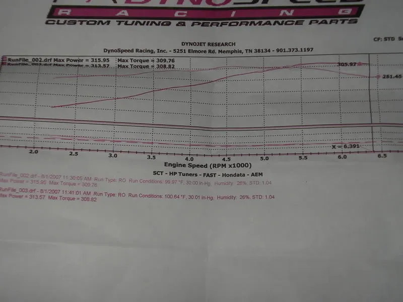

Scott@VTengines recommended Crower stage 2 blower cams for my N/a setup. He stated that they make just as good if not better power than there Stage 2 N/a cams. Ive been happy with these cams as I made 316rwhp and 309rwtq with them. This was on a 101 degree shop temp as well. here is a pic of my dynosheet

They look to make power up top. See his peak torque is @4600RPMs, but with my VT stg 1s I made peak torque around 4K if I recal correctly. I made 292RWHP/308RWTQ SAE.
the above graph is in STD, that bumps power by 10RWHP in every comparison I have seen. Still great #s though, but I think you will need his setup to see that sortof power out of those cams. Any blower cam will hurt while N/A vs N/A cams though. VT stg1s seem to work pretty well with blowers...stangman on here put down 440RWHP @ 8PSI and 14*s timing NON intercooled. So yea they work pretty good if you find a good deal on them...otherwise go straight for blower cams if buying new.

My cars Tq curve was literally flat at the peak from 3800 - 4800 RPM with the Crower Stg 2 Cams. My N/A car found the limits of airflow of the plastic PI intake. I hope to have that rectified at some point. I have a plan in place.
