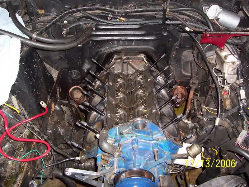

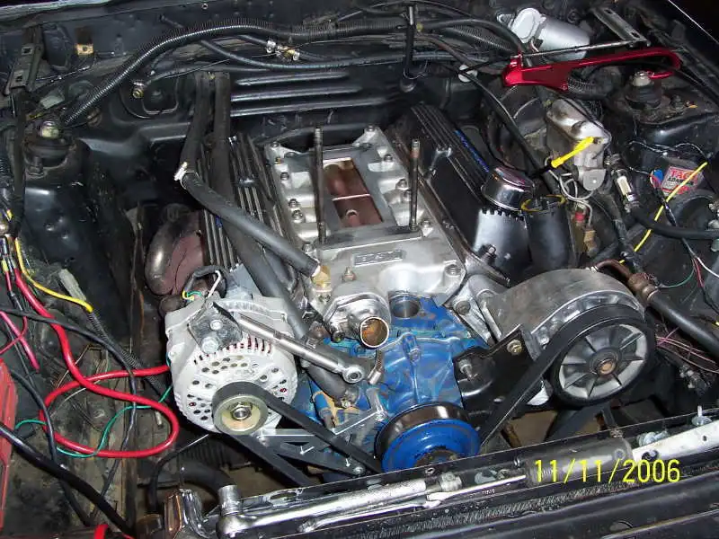

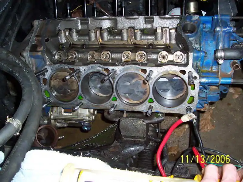

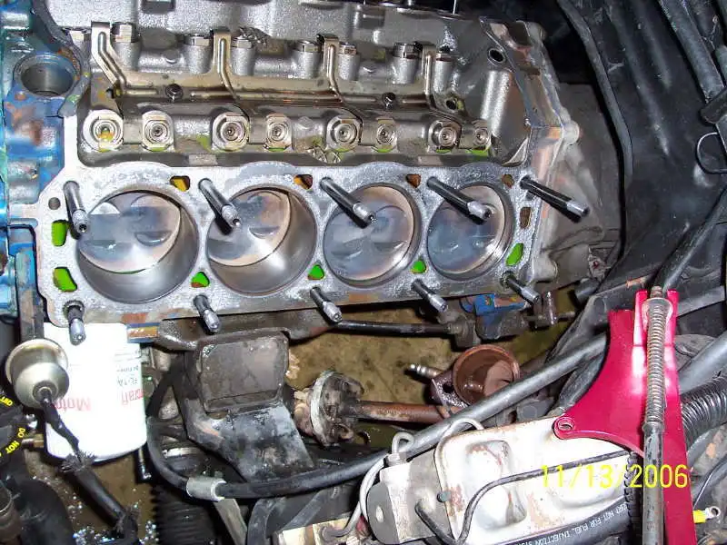

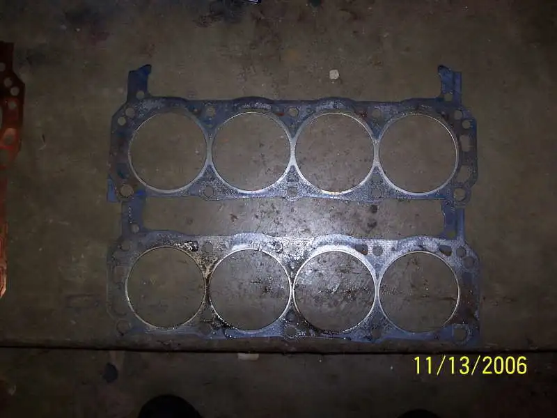

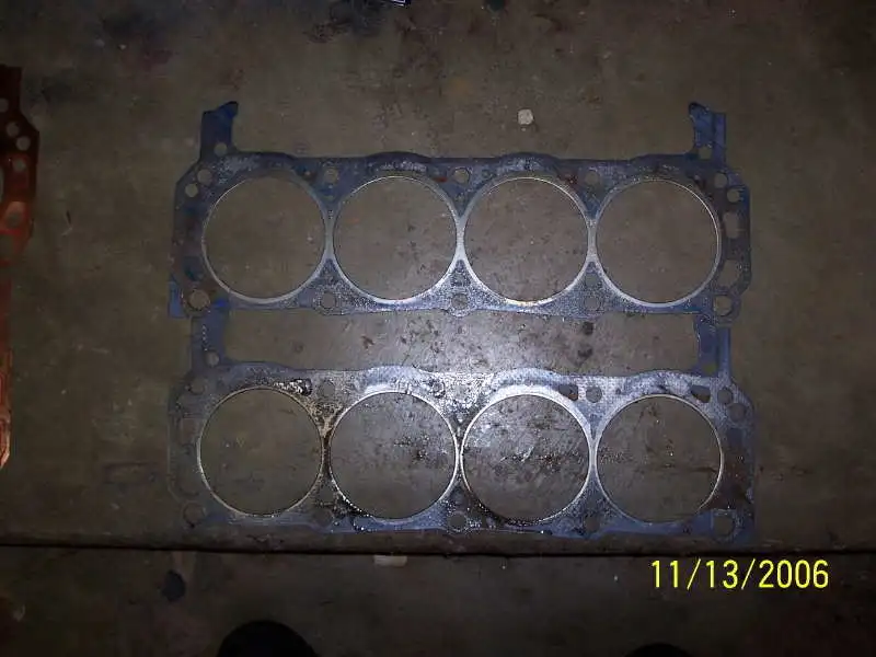

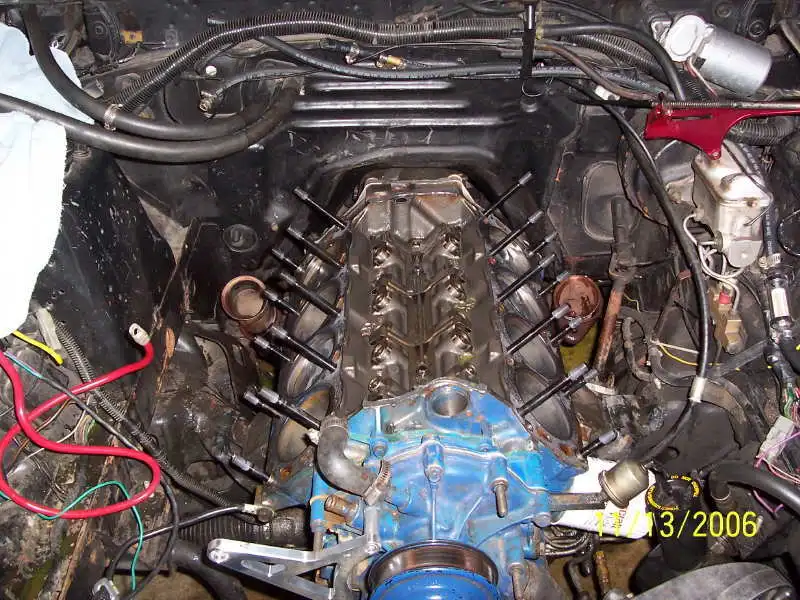

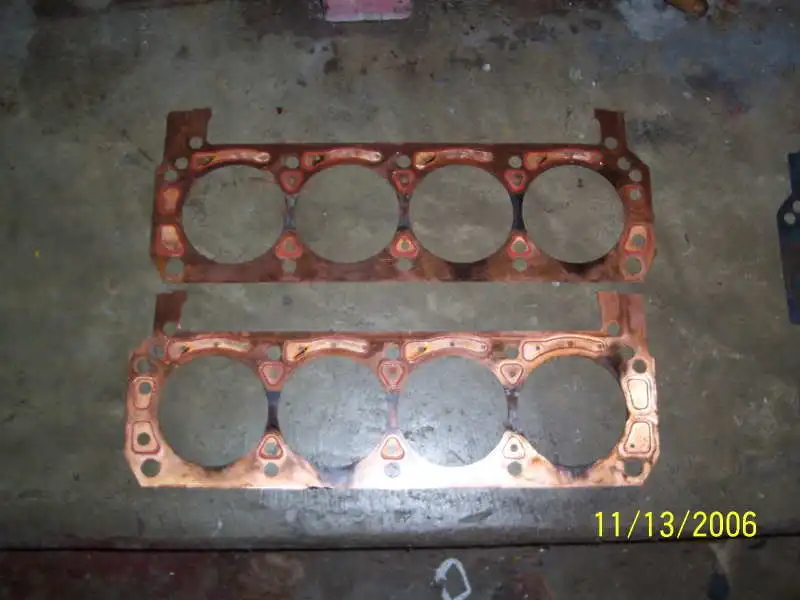

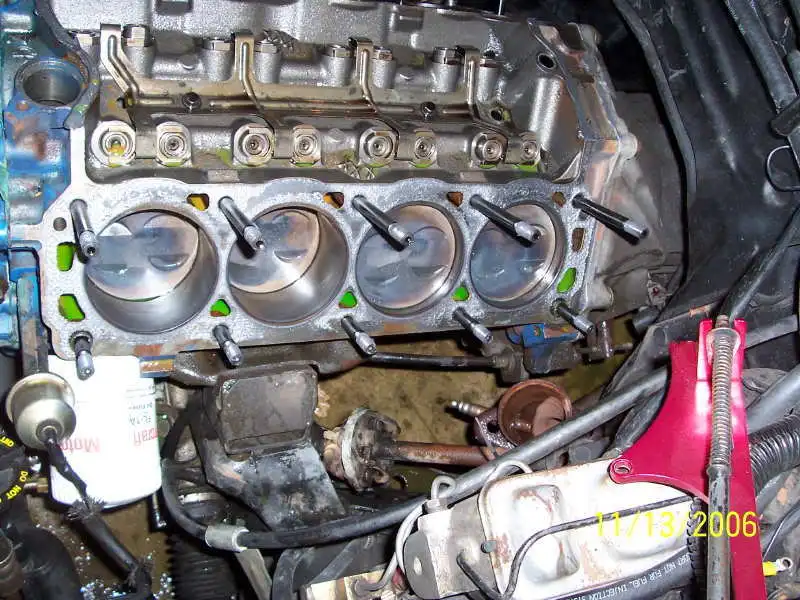

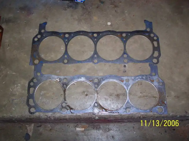

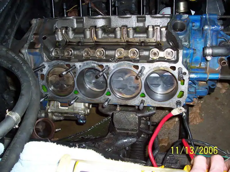

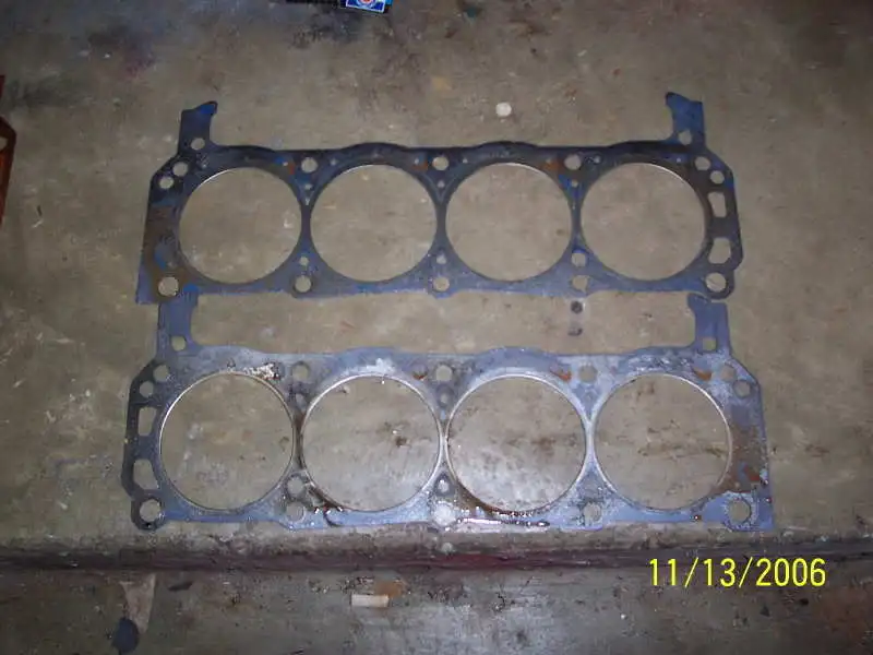

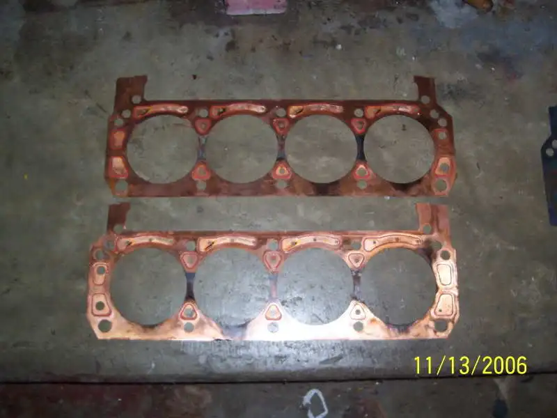

well tore it apart today (only took me 2 hours,dam im gettin quick at this:rlaugh:) the #4 cylinder is the only one to go, and the 4 nuts around that cylinder were loose, well not LOOSE i still had to put a prybar on the end of a 3/4'' rachet to get em loose. but they were easier to break loose than the others.
and my copper gasket failure.waste of $100:nonono:

to much compression? stock there 9.5 i believe. i think if you picked up a set of twisted wedge heads the combo would work well together.
twisted wedge heads i think the compression is 8.5 then.
just my 2 cents
or if you don't have money for new heads... take your old heads to a machine shop and have them mill .005 of of the bottom. also check the surface of your block while the heads are off.
