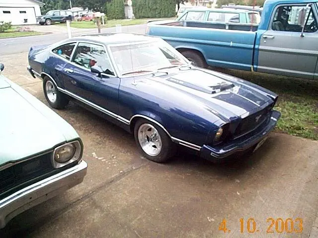

I replaced my front opening Cobra II scoop with a small 2" high rear opening cowl scoop and lowered the engine compartment heat by 30 degrees as tested for a week in 70 degree temps. I like the outcome but not the looks.
I saw this bolt on scoop with hidden flange on this site and like it's looks much better, does anyone know who makes it?. I really don't want to glass and bondo a cowl on because my paint is perfect. I presently have a 14" hole cut in the hood under the scoop to vent hot air out. With 115 degree days right around the corner I really want to run cooler this summer.
Due to it's small opening 1' x 16" the factory scoop reversed just doesn't flow enough air to lower temps in Vegas summer. I will just have to keep looking for the one above.
I'm sure you've already purchased something for your car, but you may want to look at the scoop used on the 79-82 Mustangs. Not the front opening scoop but the one on the 79 - 80 Cobras specifically I think it's as wide as the high point on the II's hood and creates a nice cowl rise on the car. You may have to google for some stangs to see the scoop but I've seen em in posted pics here in stangnet awhile back on II's they look good
That SC-124 is the exact scoop used by the gentleman with the white/gold stripe car, so you did good detective work! I'm doing the exact same thing with my KC. If my memory serves, the scoop on the white/gold car was shortened 7".
Cowl is done and installed I like it and apparently so does everyone who commented on the car last night as I was cruising around. Underhood temp has dropped a full 60 degrees and has not exceeded 120 even in Vegas bumper to bumper traffic.
Don't quote me on it but I believe the cowl was meant for a 69 Camaro and he shaved a bit off to make it shorter.
Actually it's universal to any curved hood as long as you cut the length to fit. I removed 7" and shortened the amount of overhang so it would not hit the header vent when hood is raised. Mine is mounted a little forward to cover the hole in hood left by the factory hood ornament base and worked out well to mount front mounting center stud.
