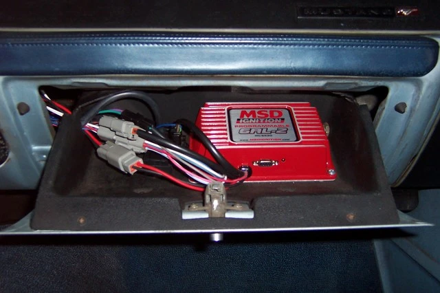

Mine is a little smaller, but fits nicely. It is hard to see the sensor. It is behind all the plugs.
