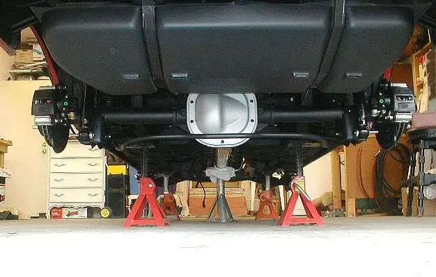

I am now getting into taking parts off the 88 TurboCoupe to put on the vert. Will the TurboCoupe 8.8" rear end work in the 92 stang? same width as the stock 92 stang rear? Also, I just need to figure out the wiring issues.
Yes! (I always like to answer a question with a pic)
I'm swapping everything from an '87 TC to an '89 convert. Click on 'Thunderstang' in my sig to see the buildup.
The best wiring site I've found is www.flemworld.com. Stinger has a good site also - http://projecthp.ford23.com.
Yep! Just pull the TC axles and slide in the 'Stang axles. TC axles are 3/4" longer than 'Stang axles (due to the ABS ring). Both axle housings are exactly the same width.
The only problem is (and there always seems to be one), you'll need offset caliper brackets to make the TC disc brakes work. They can be acquired through www.northracecars.com. A little pricey at $150 but a very simple bolt-on! You may be able to make your own but you'd pretty much need access to a full machine shop!
