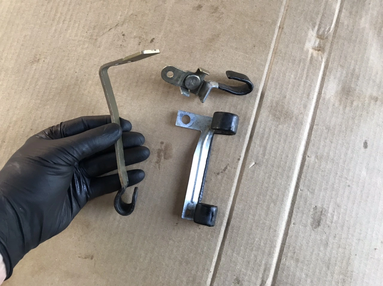

I don’t know if I’ve ever posted but I need some help figuring out where to place the brackets that hold the starter cable away from the engine as it passes around and under the front of the motor. Unfortunately it’s been 12 years since I disassembled the engine and I don’t recall where they go exactly. I’ve attached a picture of the brackets (looms?) in question.
Thanks for any help in advance!

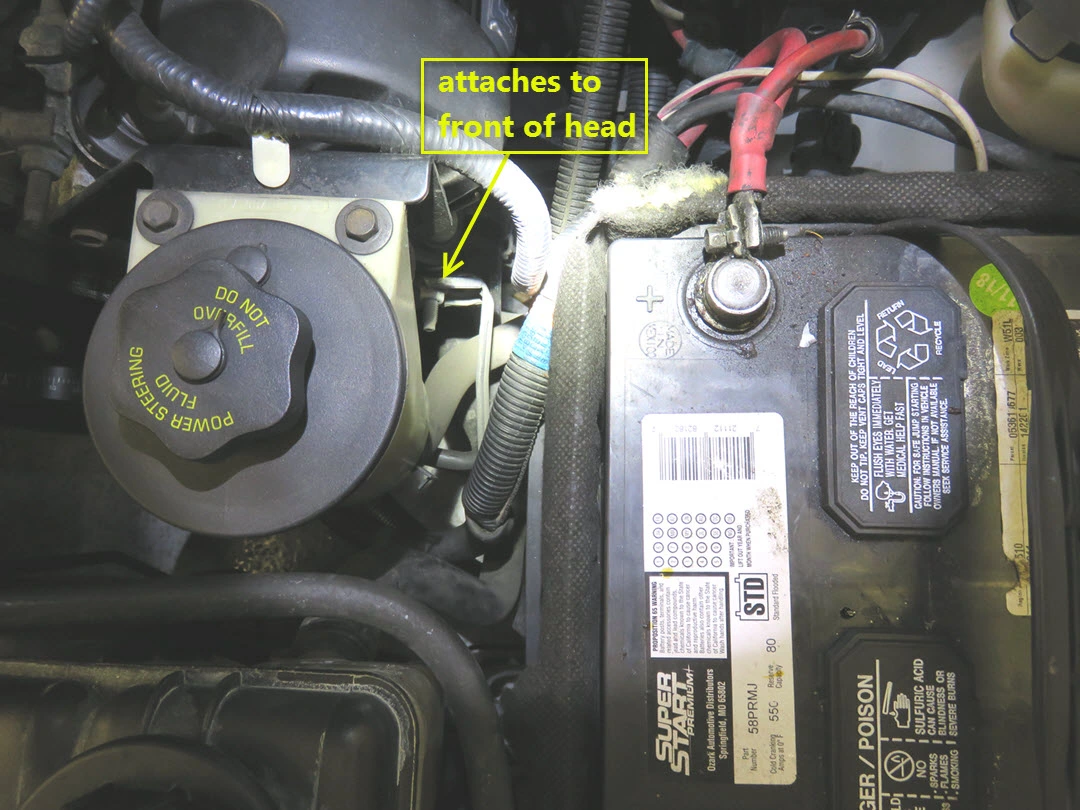

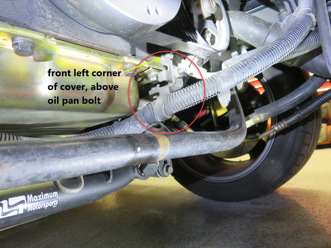

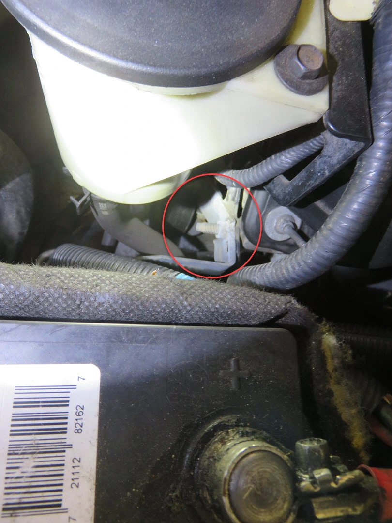

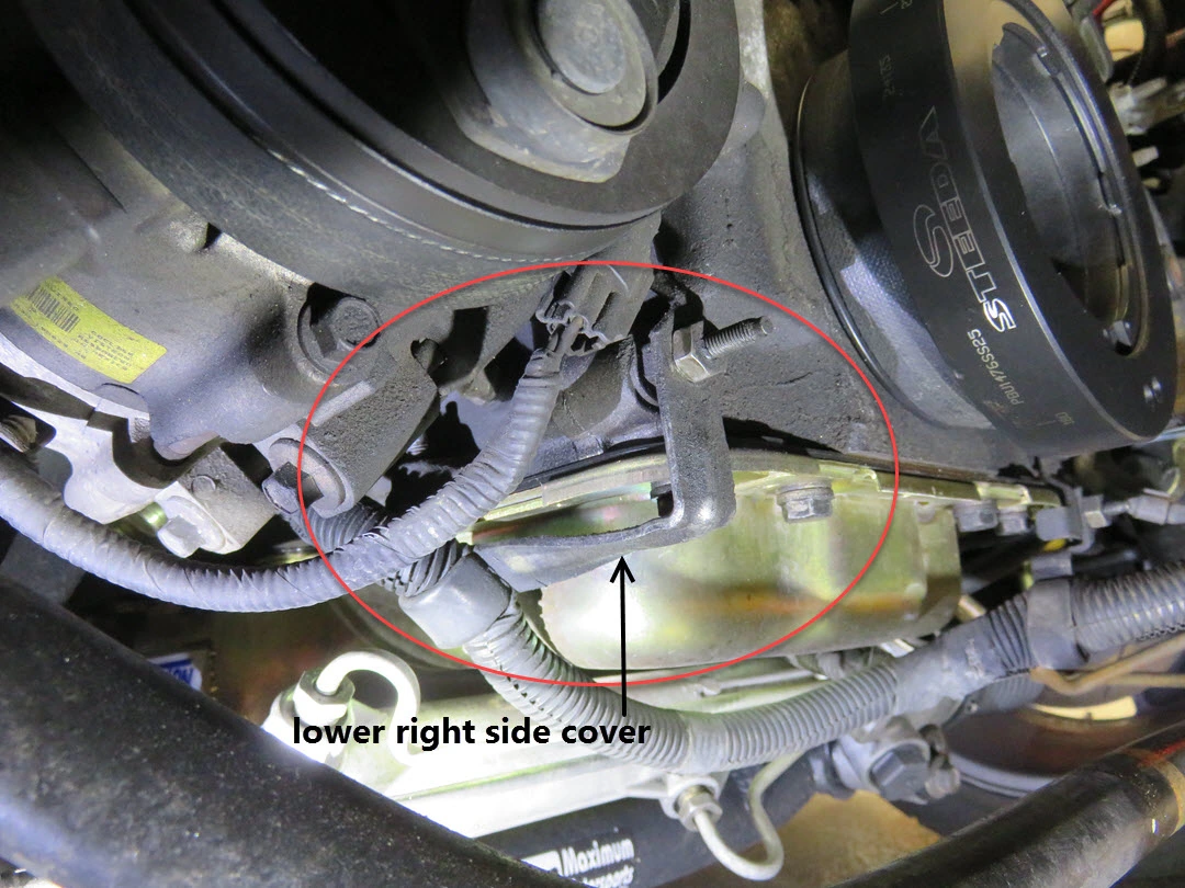

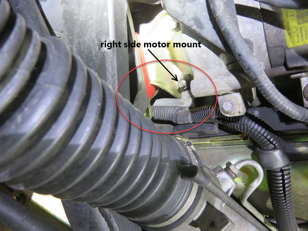

I have a 2002 GT and this is what I have on mine. Seems I have one extra but think you can get by with what you have. If you don't/can't see the photos or need better shots, let me know. I think the one in your hand goes by the power steering pump (b1 and b1a) or under at b4 (but it has a slight twist).
