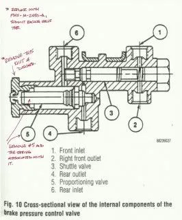

Just to clarify you do not completely gut the stock combination valve when installing rear disc brakes. You "gut" the proportioning side of the combination valve and leave the shuttle side.
You will need a new cap as the stock one has a hole in it that will leak when it is gutted.

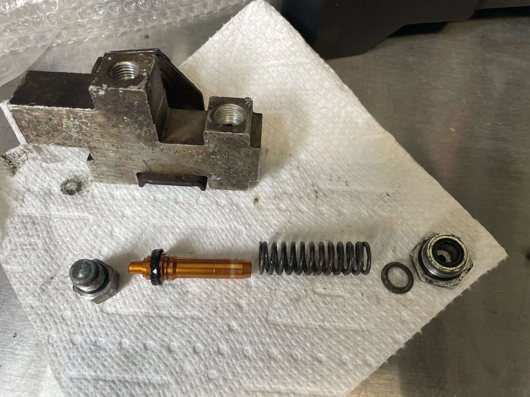

Thank you, what a great offer. I think mine is fine, though. The rubber plunger came off the shuttle valve when I removed it , but is whole and pliable. There was nothing inside other than brake fluid, so I put it back together and moved on. I’ll definitely reach out if something goes south! Thanks again. One SSP to another!
Reactions: Mstng93SSP
I might need to take you up on your offer after all, Mstng93SSP. My proportioning valve is gone, so I guess the government mechanic fixing the patrol cars felt it was unnecessary! No proportioning valve added anywhere else, either. At least they put a plug on the side for the rears so it didn’t leak. Why would they do that, and what effect has this been having on my braking? Here’s a pic of the entire thing, disassembled.
