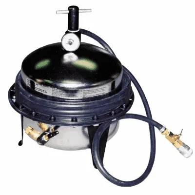

The only correct way to bleed brakes is with a pressure bleeder - period!

BTW: Since I bleed my brakes once a year, and I have 3+ cars, I bit the bullet and bought:

BTW: I do at least 3 brake bleed per year. I've had zero problems bleeding brakes since I started using a pressure bleeder. :)
