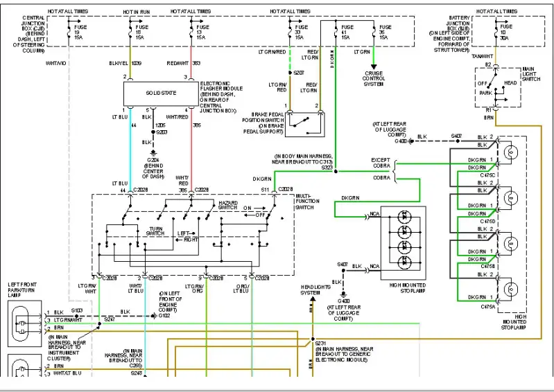

For safety reasons, there are two brake switches, and either should deactivate the cruise control. Both are mounted on the brake pedal assembly. One senses the position of the pedal lever and the wire colors are Green/Red-stripe and Red/Green-stripe. This switch also turns on the brake lights and (after a fuse) operates the shift interlock (which explains why you have trouble shifting out of Park).
The second switch senses pressure in the linkage that operates the master cylinder.
Wire colors are Green/Red-stripe and Orange. This switch is normally closed, so if a wire falls off, the cruise control will not engage. If your cruise control will not turn off with brake application, either you are not pressing the pedal hard enough, the pressure switch has failed, or someone has jumped it.
I agree with the brake position switch diagnosis. What color is the wire you thought was disconnected? How did you attempt to reconnect it?

Has anyone checked the fuse #33 (15A) for that circuit?
