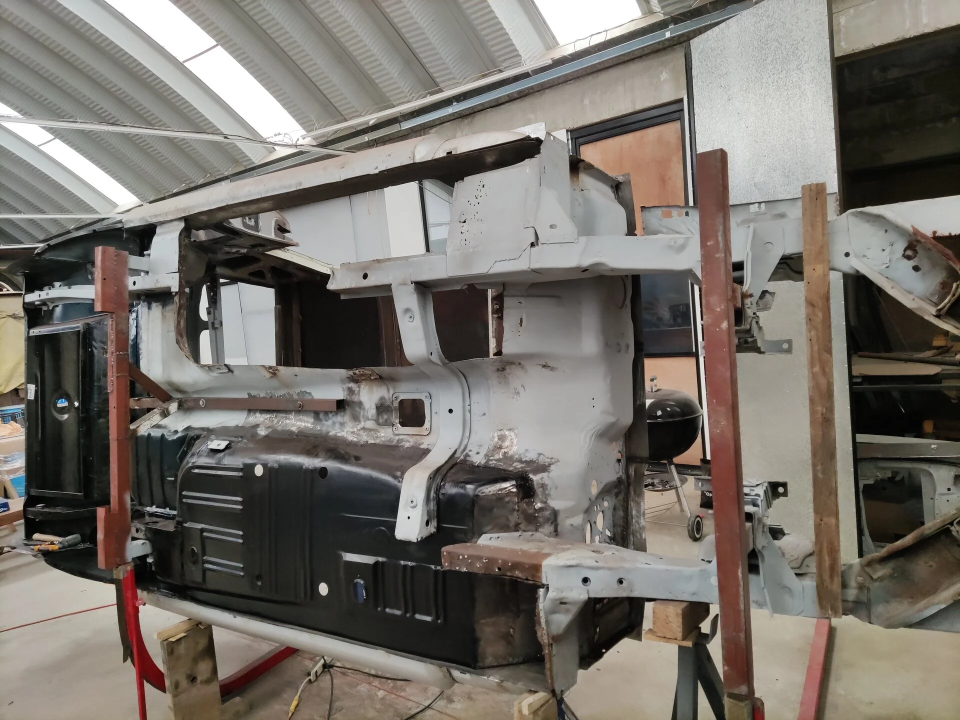

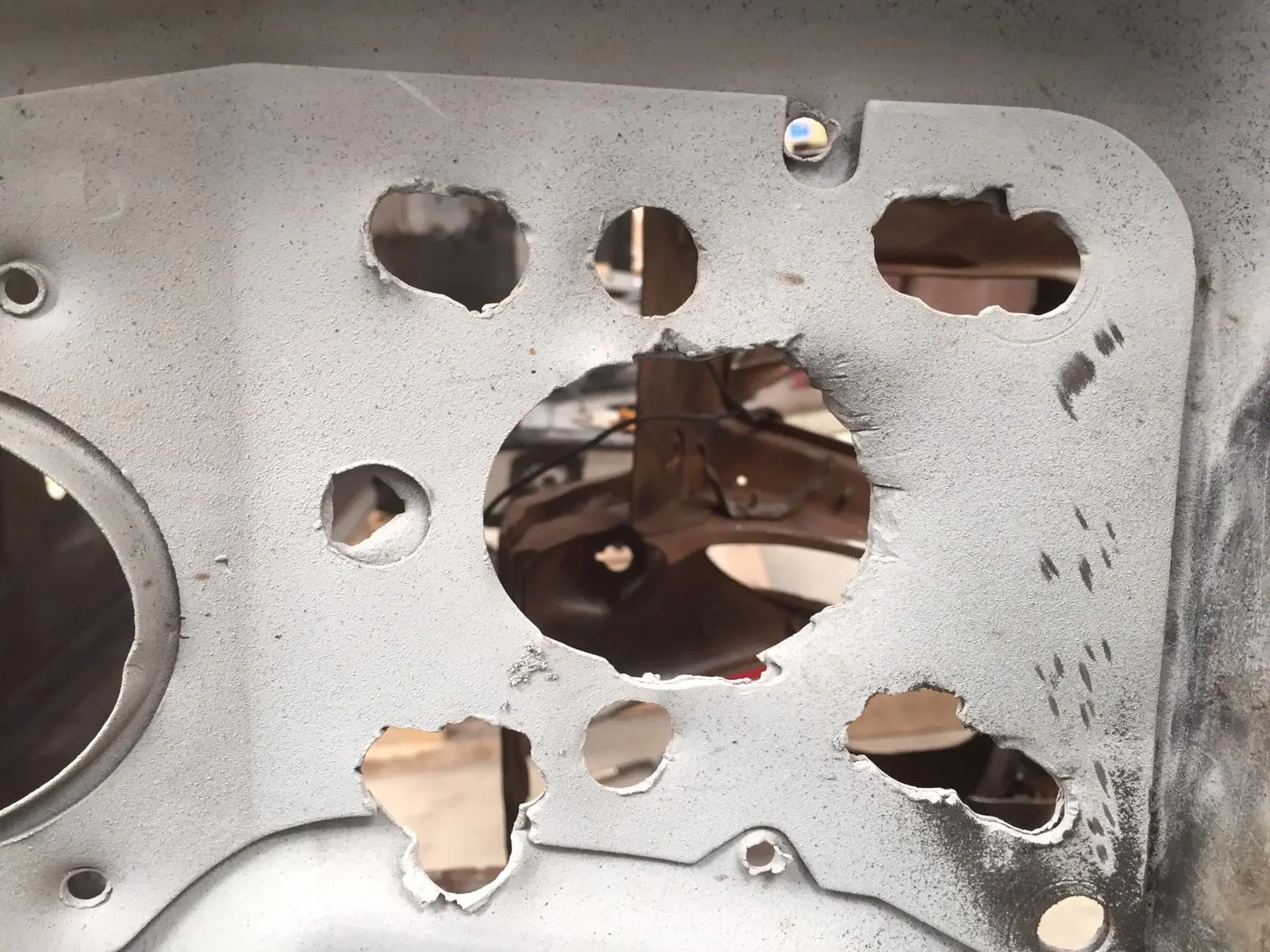

Is a '68 actually in the body workshop for the restaoration process, in the firewall I need to know wich are the original size holes for the booster and brake pump. Because I think that my Mustang had another brake system, like you can see in this picture.
I see these rotisseries and I'm so damn jealous. Makes me want to build another one.
The 15" rims will definitely be a significant factor. The good news is that for your intended purpose, factory discs, or a low end aftermarket kit should be plenty. I would encourage braided flex lines and good quality rotors and pads, but there's no real reason to go for a high end aftermarket kit. Your street warrior won't see the heat cycles to justify the performance of bigger brakes, and Cragars don't show enough to justify the bling of aftermarket calipers (and wouldn't fit a BBK anyway). A stock MC should be fine. No idea what those measurements are to fix your firewall.
