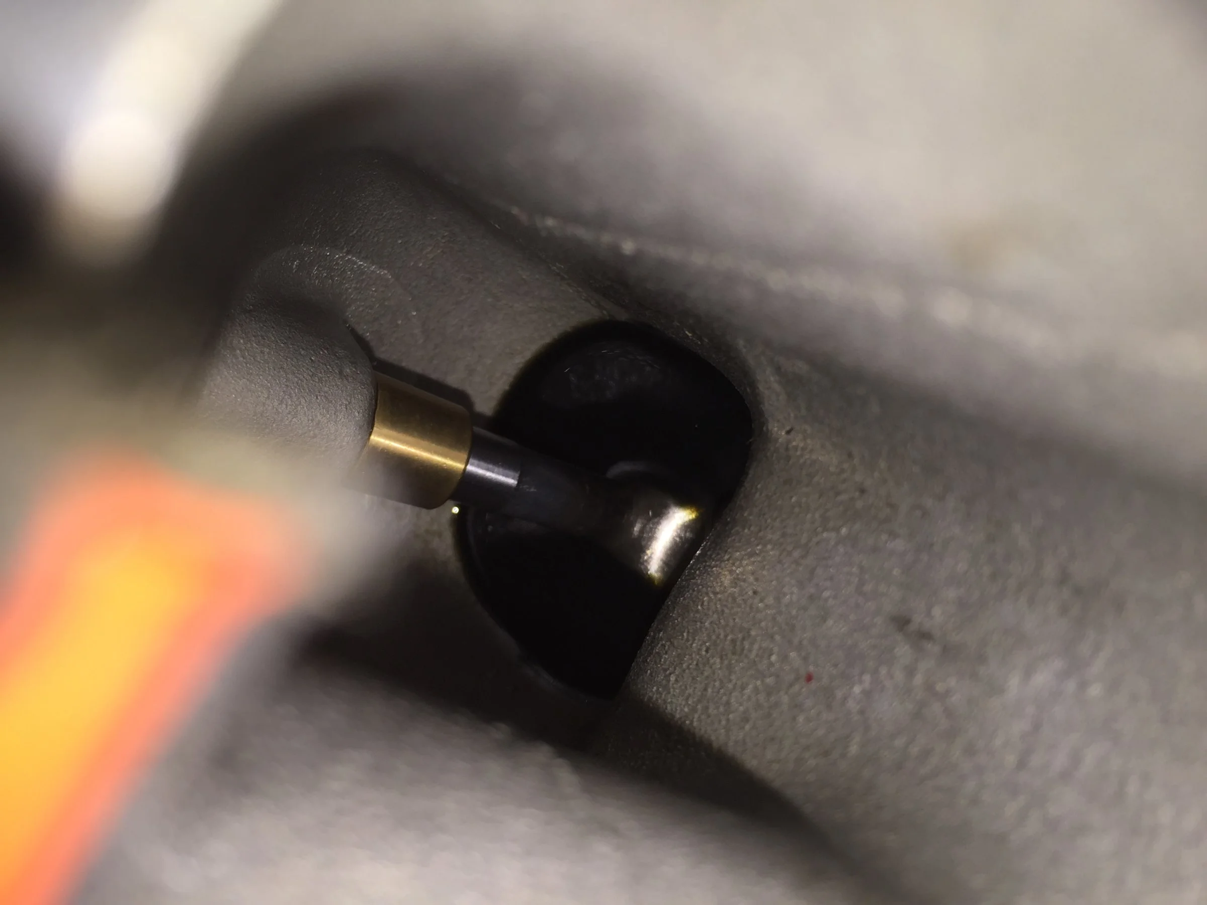

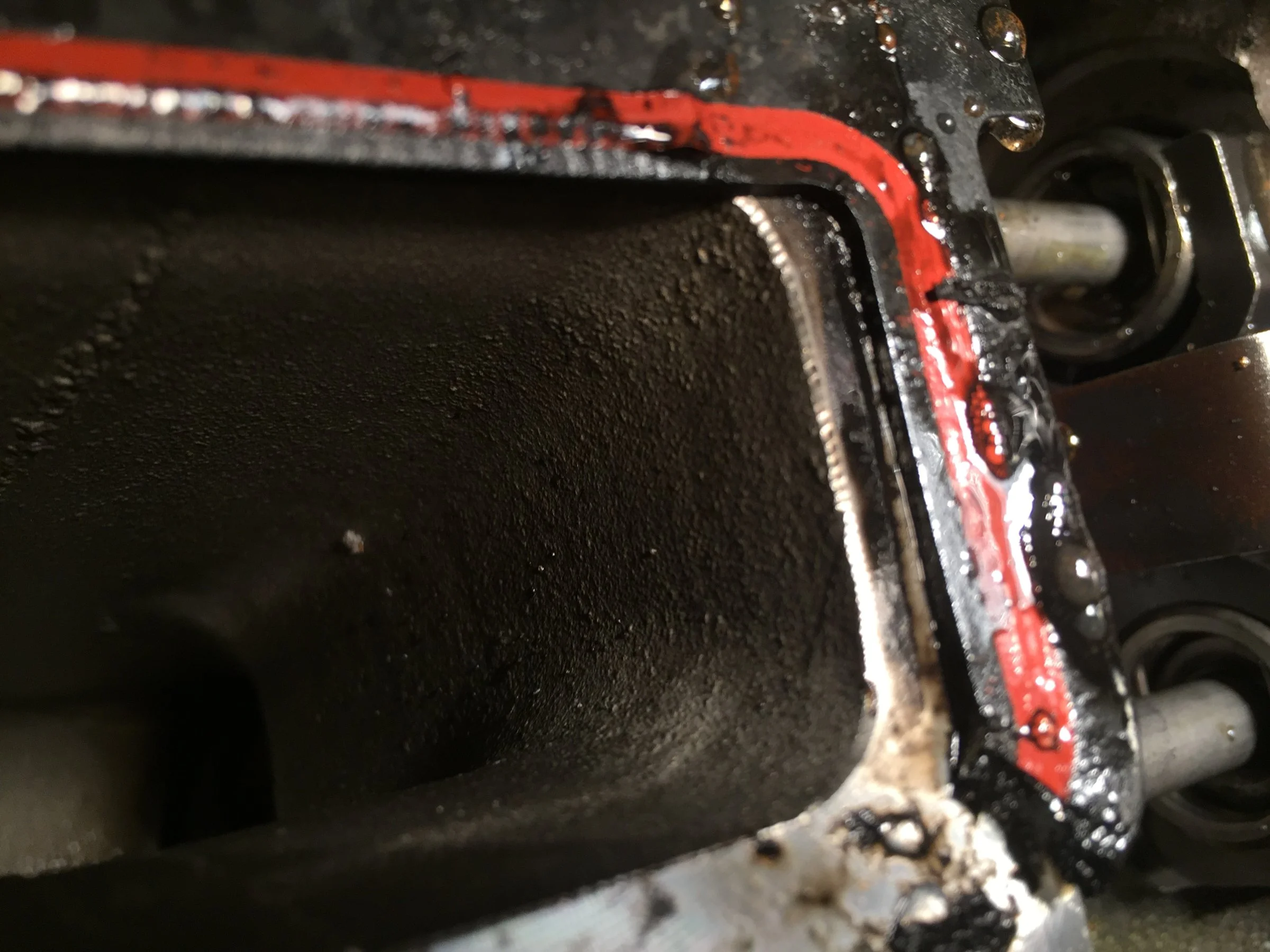

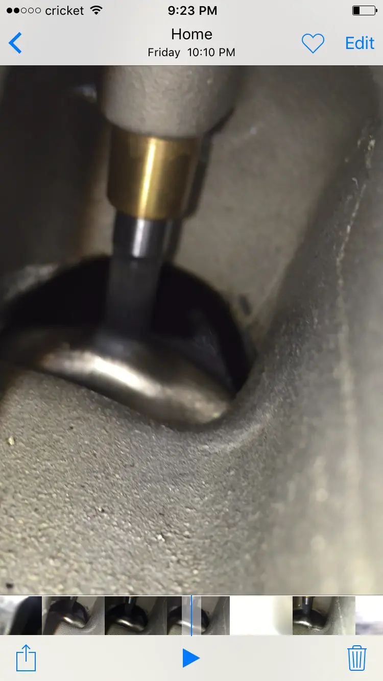

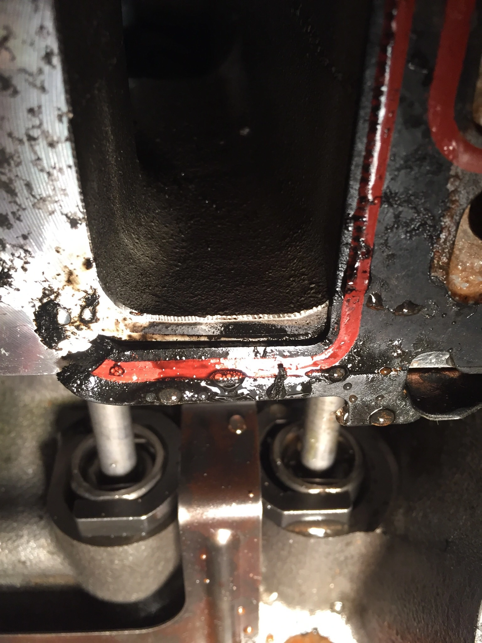

Hello ,
I finally got to take the intake off , I notice that there was oil all over the intake ports and inside of the head , the valves were full of oil .Can this b the intake gasket that were not torque down right ? Or a intake gasket ? Or can it b the heads ?
The gasket has shifted and the engine is sucking oil out of the lifter valley...
Vacuum leak due to slipped lower intake manifold gasket...

Thank you so much for all the guidance and taking your time to write everything for me step by step . I was terrified when I sow so much oil , I could not believe it was the gasket , and certainly did not want it to happens again . You guys all have been a blessing thanks again .

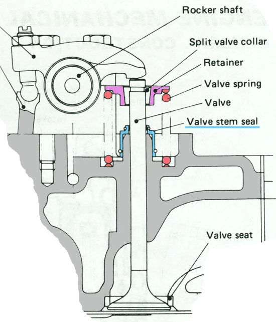

What about valve seals? I've seen heads assembled where the valve seals were not installed. That can suck a fair amount of oil into the combustion chamber. Look on the inside of the valve springs and make sure the valve seals are there.
Reactions: jrichker
I had a 428CJ where the machine shop assembled the heads using the wrong valve seals. It smoked like a freight train when I started it as well. When trying to find the problem, I looked at the springs there were no visible umbrella seals sitting on the guide bosses,......they were all up at the bottom of the retainers instead.
But I don't think that's the problem here as oil is at the entrance to the intake port as well.
I'm saying intake gasket movement/improper installation.

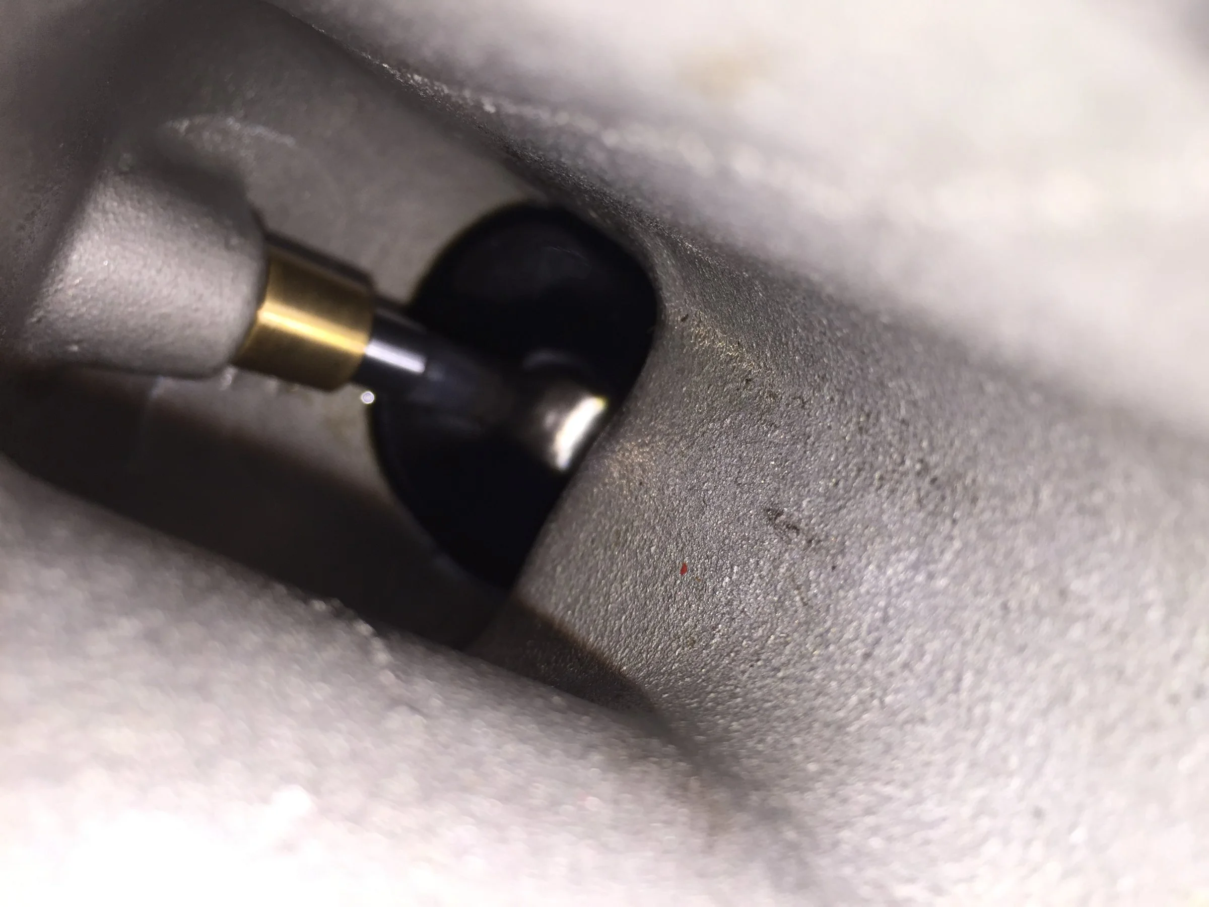

I think it's the gasket also but again I have lil experience with building motor this is actually my first built . I'm just waiting on some Arp studs that I have orders to get everything back together . I think I do see the valve seats on there . Are they gold ?
That's a guide. A valve seal is visible through the spring coil sitting on top of the guide boss.
