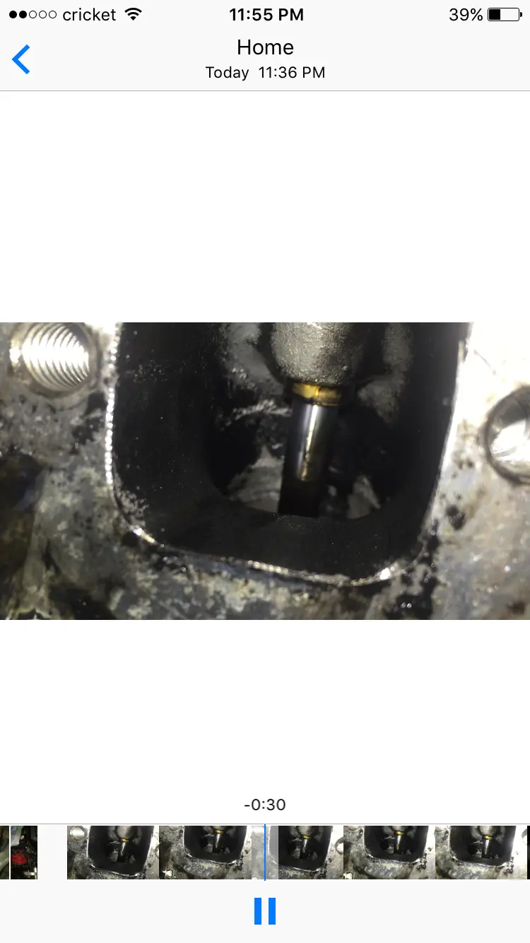

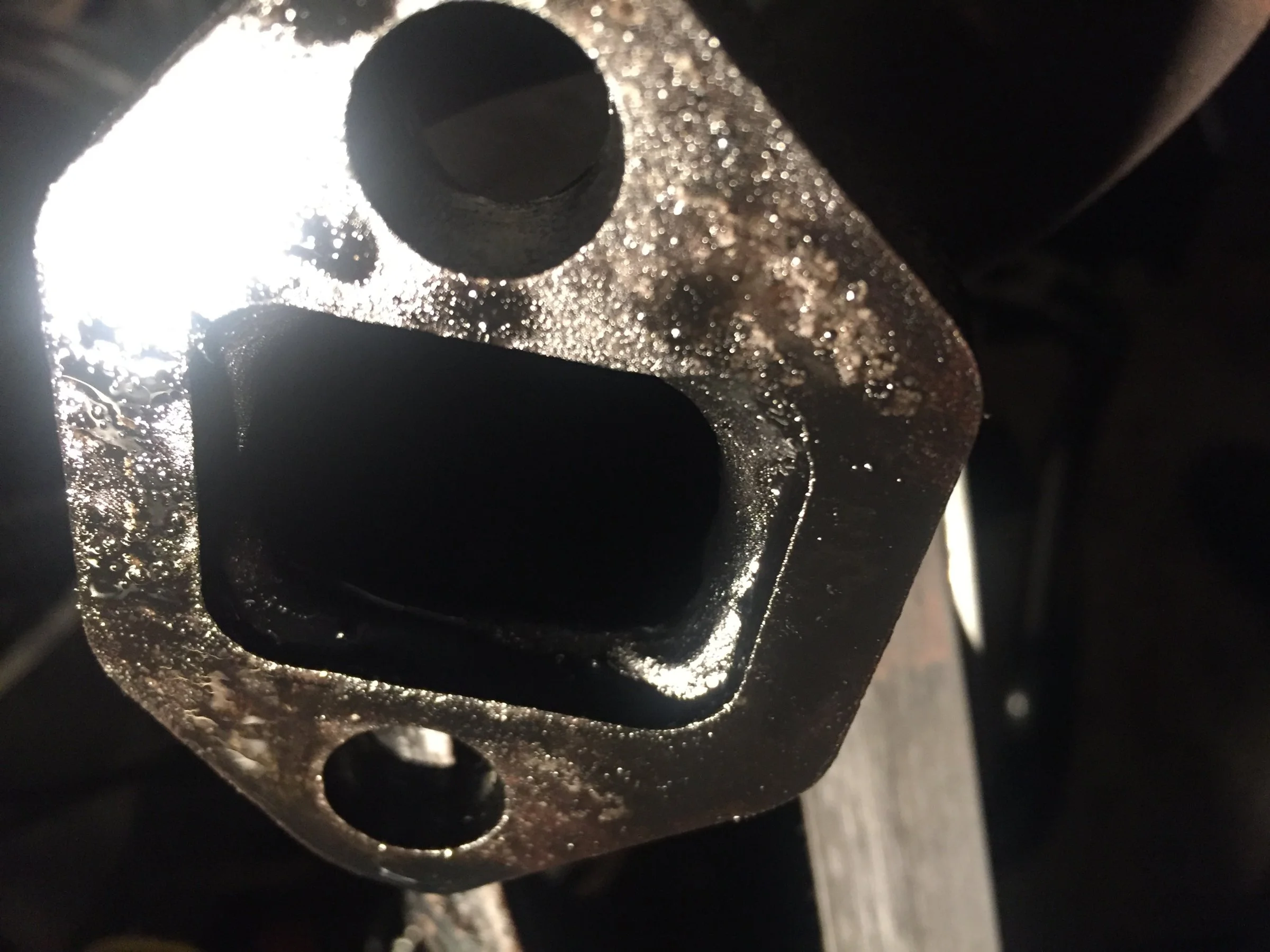

Ok , I pulled my vc off but did not find anything , I did how ever take the exhaust headers off and found oil in cylinder #8 that's why I'm leaning towards the heads now .
The only thing that I don't have is the mesh filter that goes behind the pvc valve , but would this cause it to smoke so much and cause idle problems ? Thanks for the help guys this car is getting me to frustrated .
Wow you need that breather filter because without it you are sucking oil into the intake causing it to smoke and fouling the spark plugs.
Ok , I thought that this would not make such a difference I pulled the heads off and on the driver side of the block it was full of oil , but the passage side was clean . You think this can b the reason why oil is getting into the heads ? Why isn't oil on both side of the heads and on the block ?
Thanks for the help
