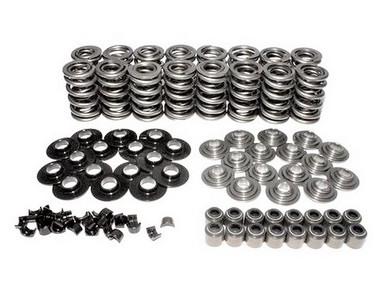

I couldn’t find a recommendation anywhere from Comp for that cam. I was thinking comp cams springs 26925. Seat pressure is 141 and open pressure is 413. I was hoping someone would say the springs I had were fine and I wouldn’t have to take the heads off but I don’t think that’s going to happen!
Did the cam grinder recommend new springs?
When I got my custom grind from FTI there was a couple spring recommendations in terms of seat pressure. I did end up changing out the springs on my TFS170 heads to what was recommended.
I'm running the xe274hr in my 347 with standard tw170s... An older set at that... I used the springs that came on the heads from TFS. Now I don't know if they are similar rates to the ones on your Edelbrock heads but I had no signs of valve float on the Dyno this past fall
I'd have the heads reworked and let the shop that does the work decide what springs to use based on the cam.
You are pulling apart the engine already, might as well get some power of out all this time and money.
Based on your part numbers they are edelbrock performer rpms, which were pretty good back in the day for a 302, but they would be undersized for a 347.
You already have the performer RPMII intake, so might as well make the best of it.
All heads should goto the machine shop when an engine is rebuilt for at least a valve job.
