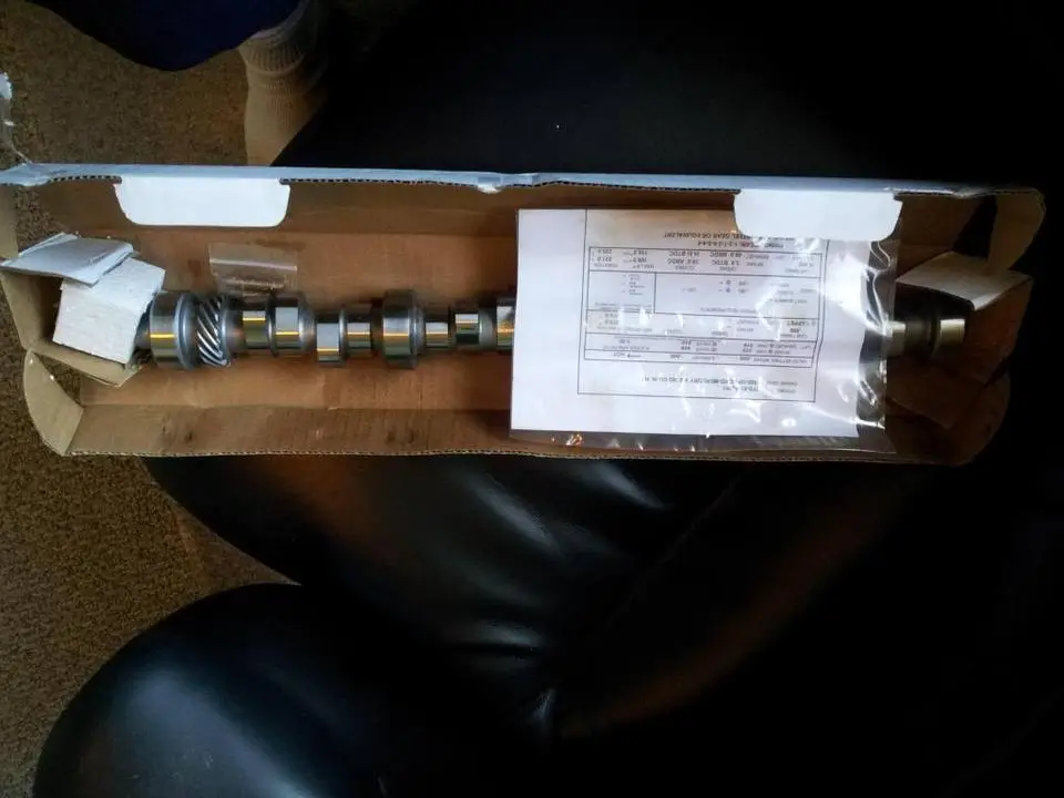

TFS1 cam

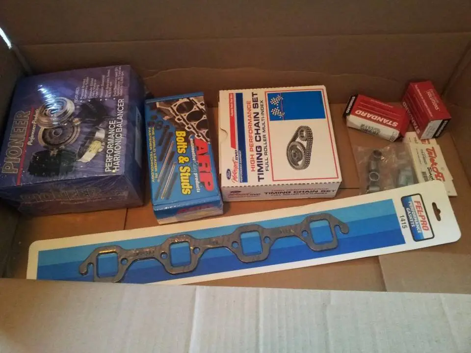

Pioneer Balancer, Arp head bolts, Felpro Exhaust gaskets. FMS timing chain and gears, TFS head dowels, new injector O rings

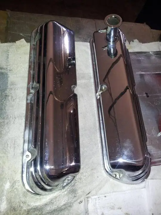

scored these on Ebay for $20

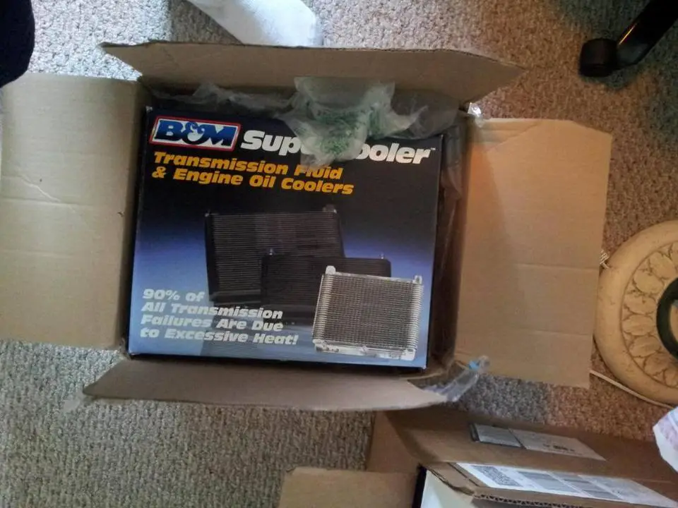

B&M Trans Cooler

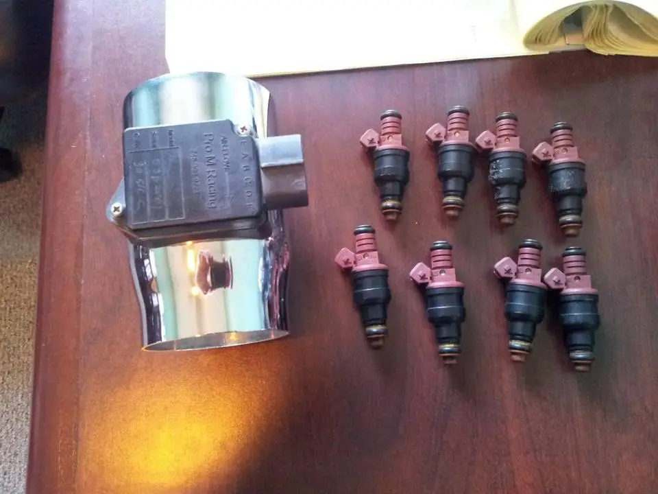

Pro M 75 MM and SVO 30lb injectors

Love it when the big brown truck comes. He's scheduled to come see me tomorrow with some goodies as a matter of fact.
You are gonna love the beautiful sound of the idle with that TFS1 cam.
Some times I start mine up and just stand behind it and smile. LOL

Good score on those valve covers! Are they chrome or polished? Look awesome.
Yeah they are the OEM chromed ones, not cheap chinese made ones. I have polished ones on there now.

Aren't svo injectors the wrong impedance?
Nah. They are fine. All EEC IV injectors are 11-18 ohms. mine are F1se-e9a 4 hole squirters EV1 style.
Ford 30lb injectors (high impedence) #s: E9SE, F1SE, F1SE-E1A (3.8SC and SuperCoupes)
M-9593-C302*19 lbs./hr.EV111-18 ohmsLJetronic/Minitimer
M-9593-M23*23 lbs./hr.EV611-18 ohmsLUSCAR
M-9593-A302*24 lbs./hr.EV111-18 ohmsLJetronic/Minitimer
M-9593-B302*30 lbs./hr.EV111-18 ohmsLJetronic/Minitimer

Please educate me on this high/low impedence. Whats high and whats low and which one is the right one??
Basically injectors are classified into two categories.
1. High impedance/resistance (saturated) 11-18 Ohms. Most modern late model cars
2. Low impedance/resistance (peak & hold) 1-6 Ohms.
Saturated injectors require roughly 1-1.5 amps to open the injector. Peak & hold injectors initially needs about 4-6 amps, and once open drops to roughly 2-3 amps to keep it open. The ECU design will dictate the use of one or the other. Most late model cars including Fox Body Mustangs use saturated injectors. You can measure the ohms by putting a test lead on both electrical connectors.
