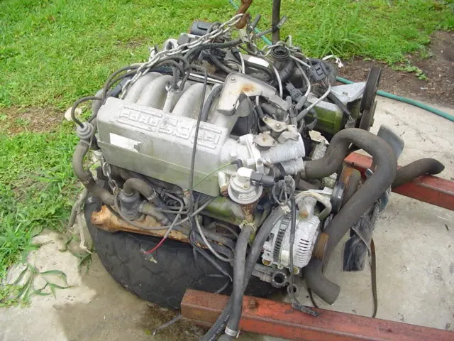

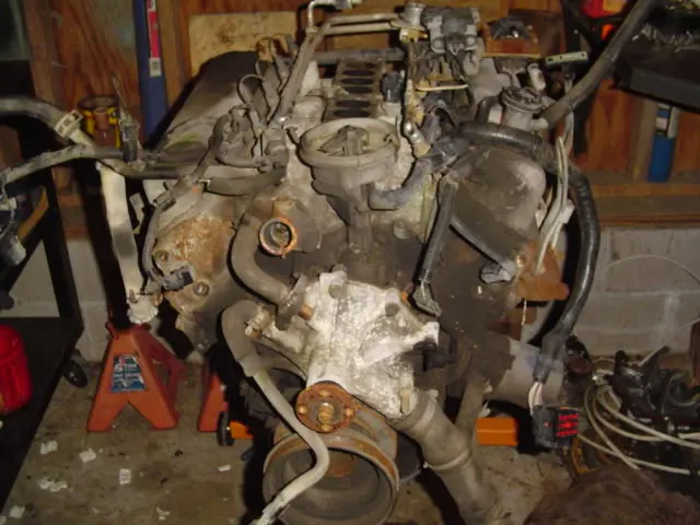

Here's a couple pics of what I'm working with. This 351W came out of a 1994 F150, it has F4 stamped on it, which makes it a hydraulic roller lifter engine. It is really filthy right now, but I'll clean it up and paint it when I get it stripped down.

I guess because it's been out of the truck for a little while. I found no water sitting inside the intake ports so it didn't take on any water that I can see. It spins nice and easy so it's not locked up or anything. I'll see everything once the heads come off. Can I reuse the head bolts? I think I hear you can use them up to 3 times before they lose their torque ability, is that correct?

it looks like the 351 came with an intake ... can you reuse it and save the money for the typhoon?

That truck intake is def. not going to work. I'll be ordering the Typhoon intake today from Blue Oval Industries, they seem to have them really cheap (329.00) for the satin.
