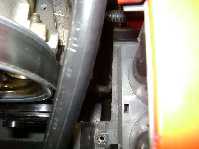

As a side note I personally kept the 351 timing cover and water pump style. They are what was used on the pre 94 mustangs. I plan on putting the truck brackets on my 383 soon for 2 reasons.
1. They use the 3 Bolt Alternator that you can find 250 to 300 amp ambulance versions of.
2. The 94/95 A/C Bolts right up.
Only drawback is that now your pulleys may interfere with your electric fan. What i did was got a 3 pound mallet and "massaged" the inside of the radiator support to push the top of the radiator forwards.
Also since i don't have the brackets set so wide and pushed back like in the 94/95 cars it makes changing things like spark plugs a breeze.

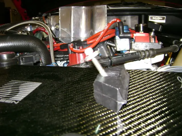

Heres a pic of the battery tray mod. Also a pic of a hold down that works perfect for a Optima battery I think it will work with stock also ...it's from I think a 90's Corvette. I will find out the year for sure.
Hope this helps
Tom
