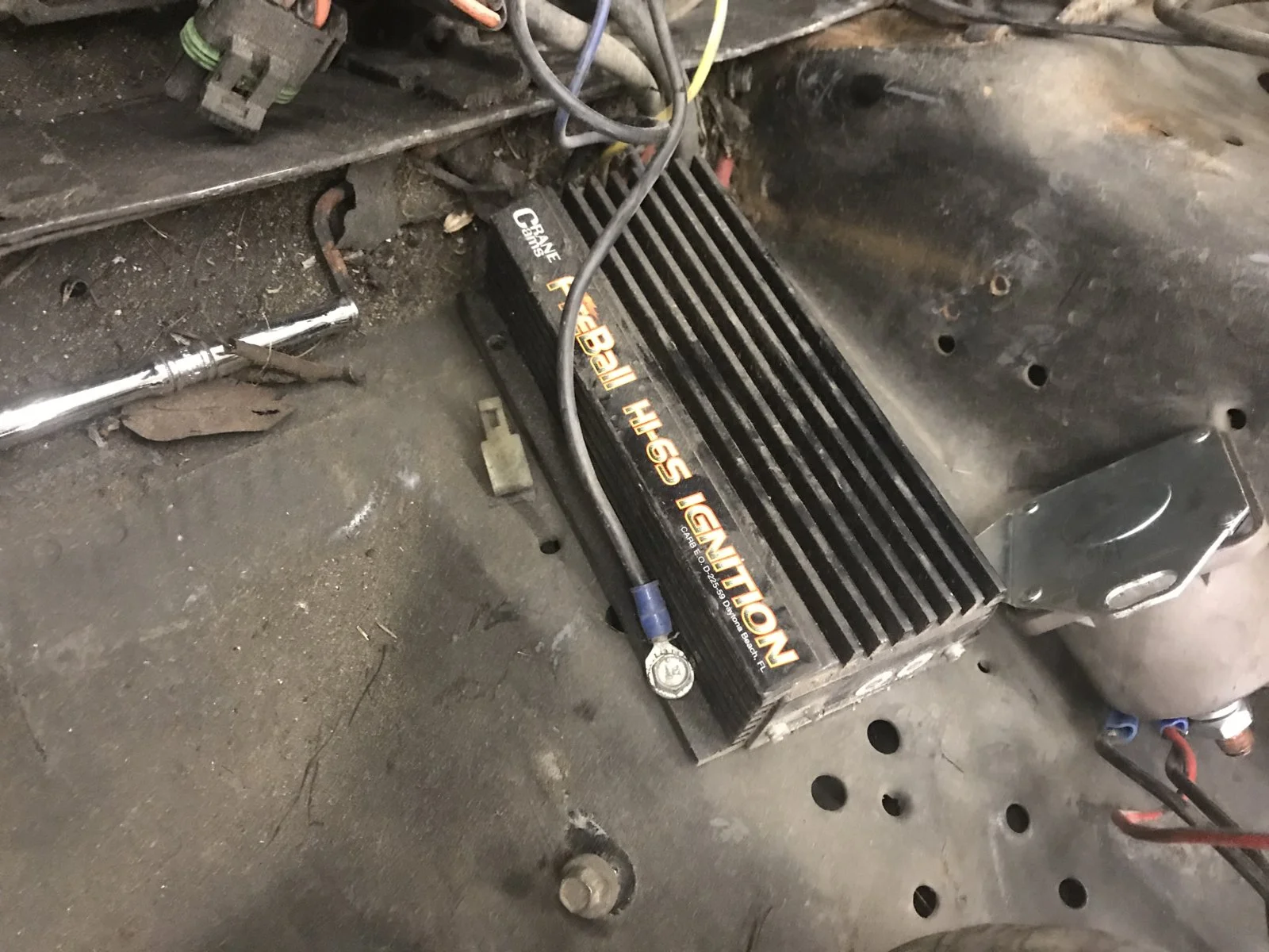

You wont need that, ford ignition is plenty hot as it is.
To Steve's point, don't bother buying an aftermarket distributor or coil either if you already have Ford ones.
Thinking "they must be better than the stock ones, right?" I bought an MSD billet distributor and Screamin Demon coil and ended up reverting back to stock because I was having issues with RPM hesitation when accelerating under WOT. Once I reverted back, the car pepped up considerably and my hesitation was gone.

I gotcha. this was already in it. they had a street fire coil as well. stock dizzy with a msd cap. ill take it out. looks like it just plugs into the coil really

That box could sell easily on CL or FB. I just got rid of my MSD 7al2 and 6al. I don't have any issues with spark. I also have an msd billet distributor and msd cap and rotor. I like the design of the cap but I have to use gm hei wire boots so I can utilize the hold down feature correctly. That stuff stays hidden under a stock distributor boot.

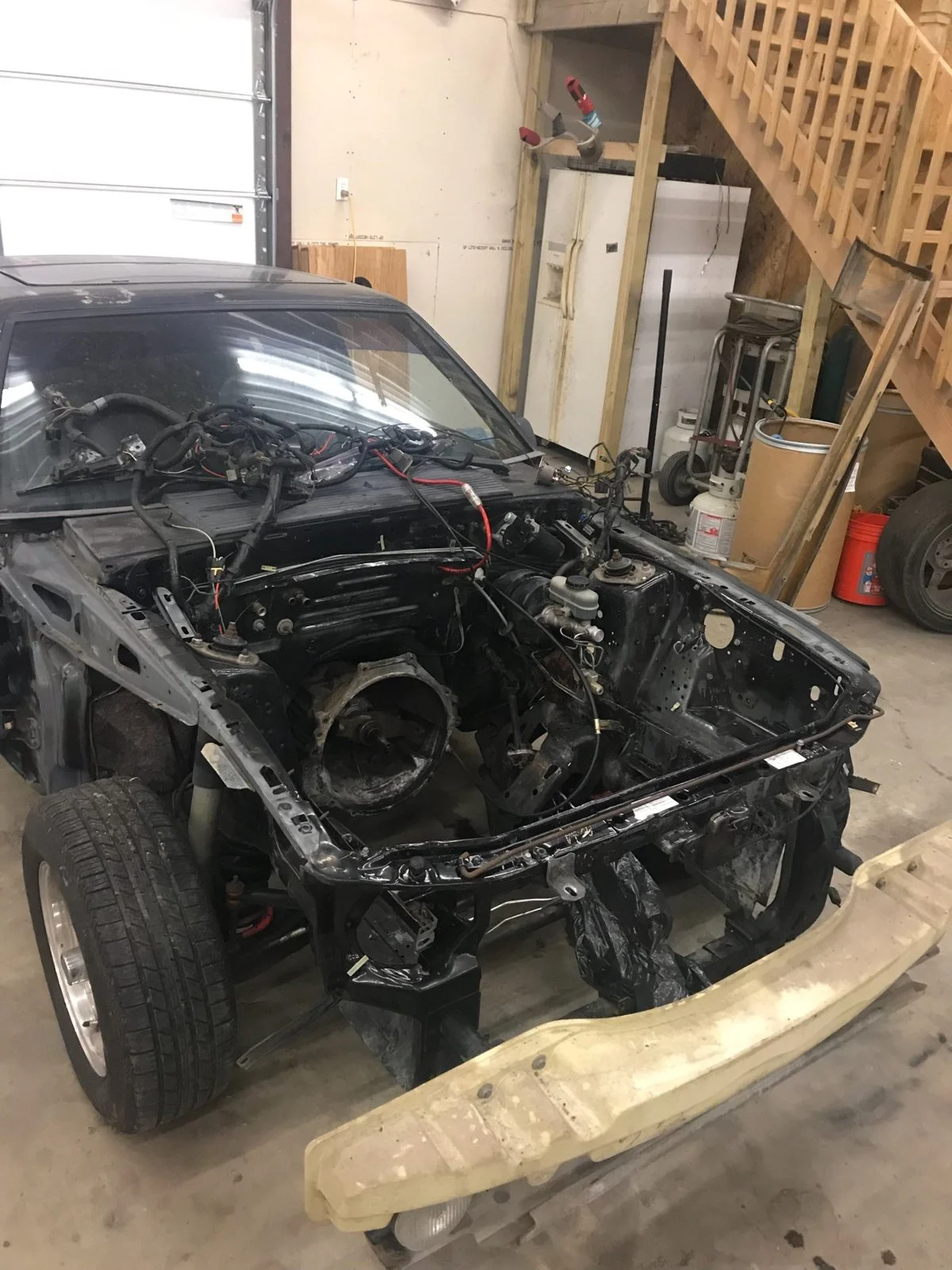

Got the engine bay power washed last night. gonna do some fab work on the fender aprons and fix the run on the drivers side shock tower. its a little worse than i thought but its fixable. just sucks the brake lines are in the way

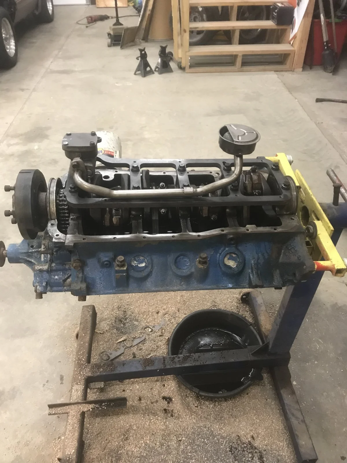

Is it a double sump pan...did you fit it with the gasket on ?
Anti_Hero0932
Jan 29, 2012
230
121
53
28
LaGrange, MO
#56
Yeah double sump pan. I posted about it on Facebook and come to find out my buddy had the same problem.
90sickfox
I didn't really have an issue with the stink...
SN Certified Technician
Mar 2, 2015
4,230
3,493
183
41
#58
You can dimple the pan down a little. A pan gasket will help a little too
Anti_Hero0932
Jan 29, 2012
230
121
53
28
LaGrange, MO
#59
thats exactly what i did. i heated it a little bit to make it easier and hit it the a hammer a few ties the grinded a little of the corner of the oil pump down. fits. not to start on the upper end. i need to get some new alignment dowels from ford then i can put the heads on.

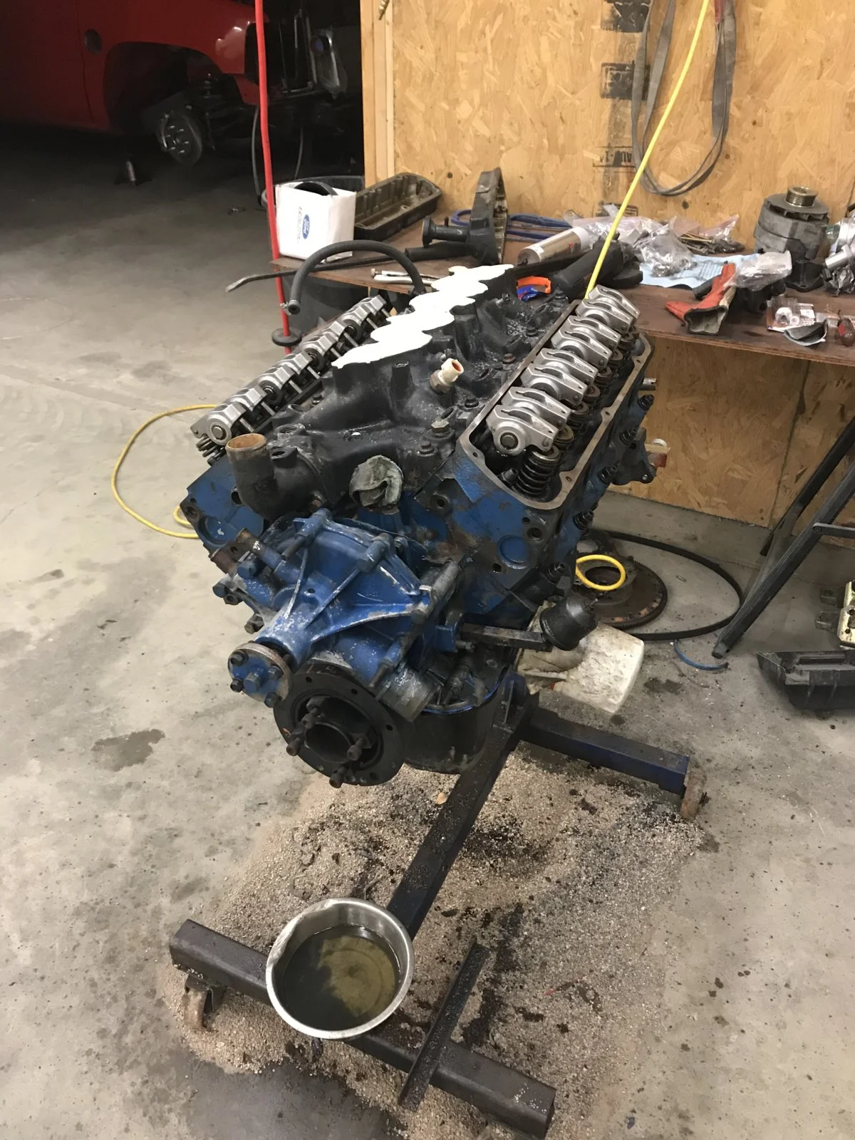

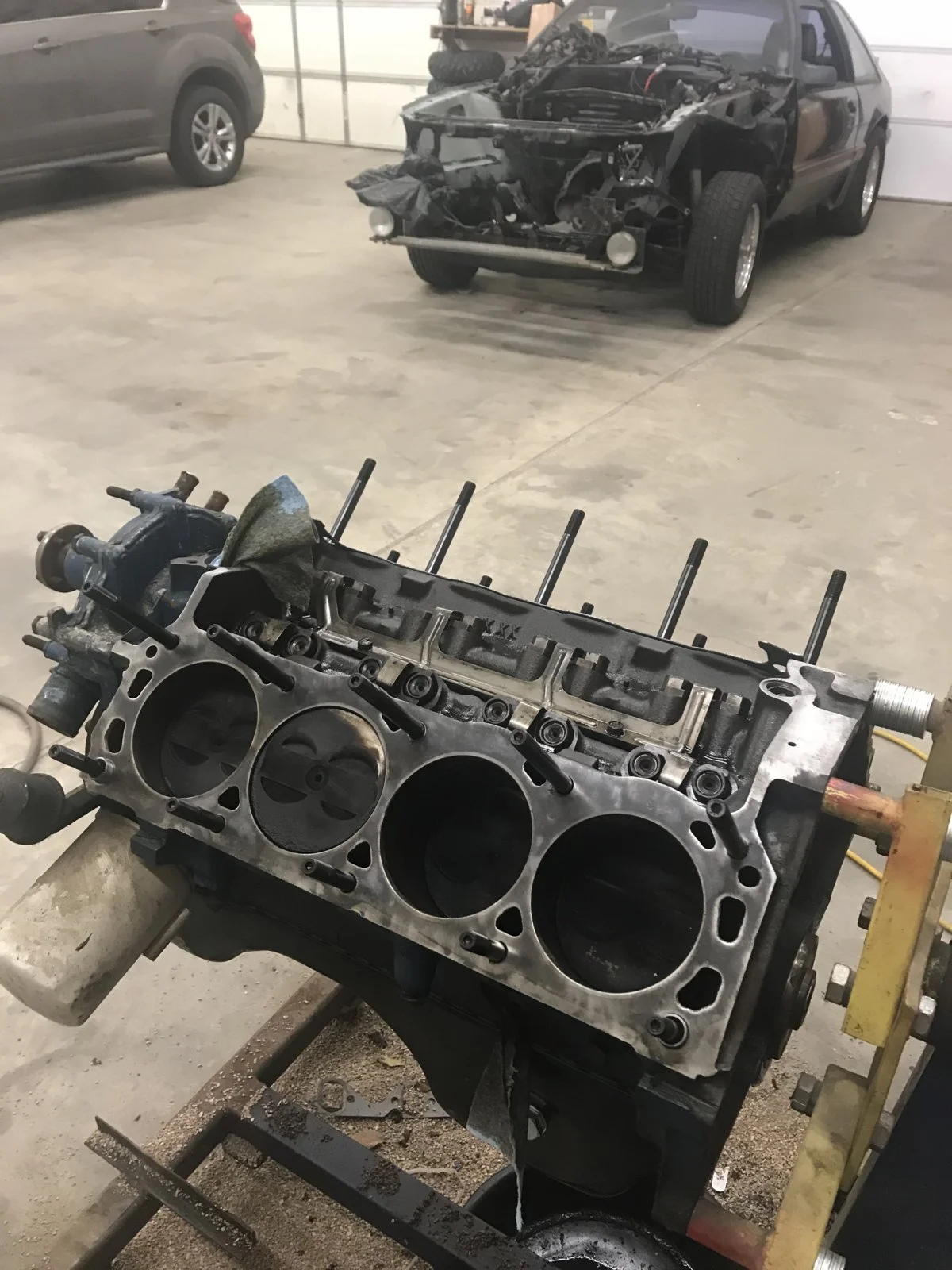

Got the heads on. Trying to get everything clean enough to paint. Using purple power and gasoline. Got some of the rust issues fixed in the strut towers and got some fender apron work done. Things are starting to come together. My microsquirt came in the mail too
