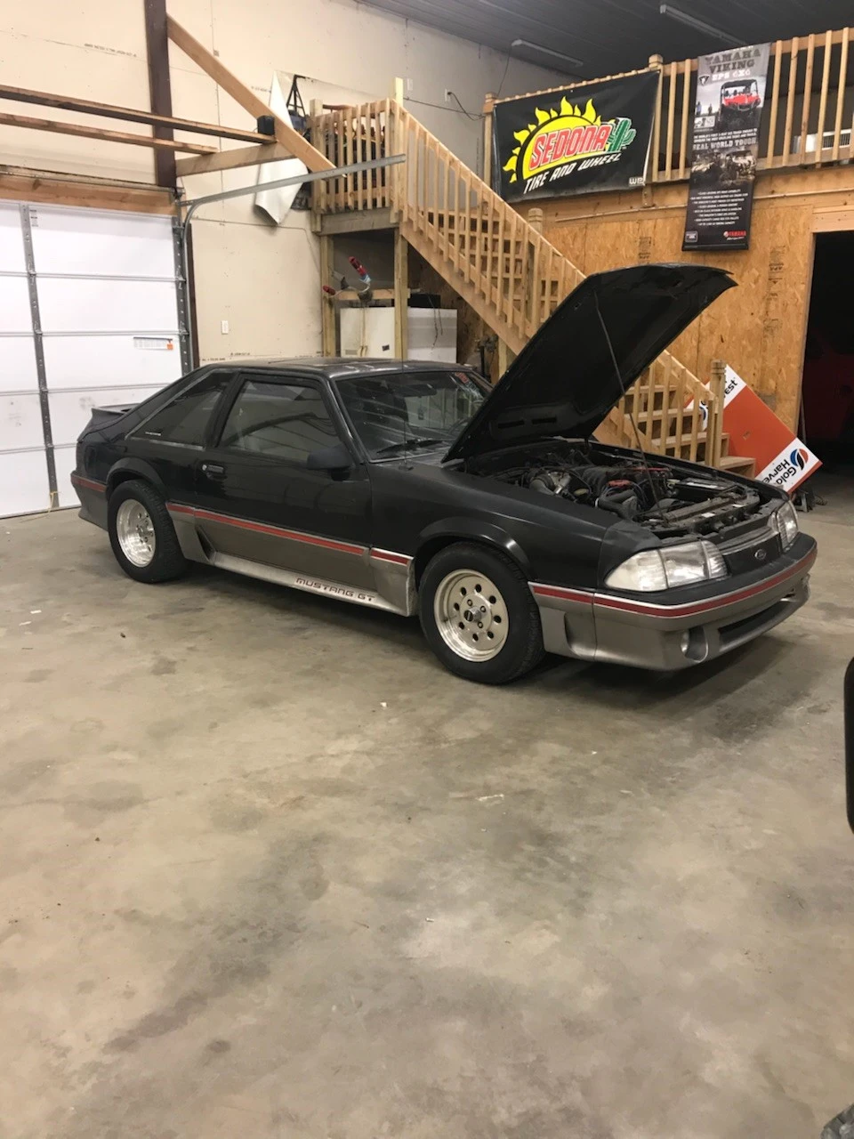

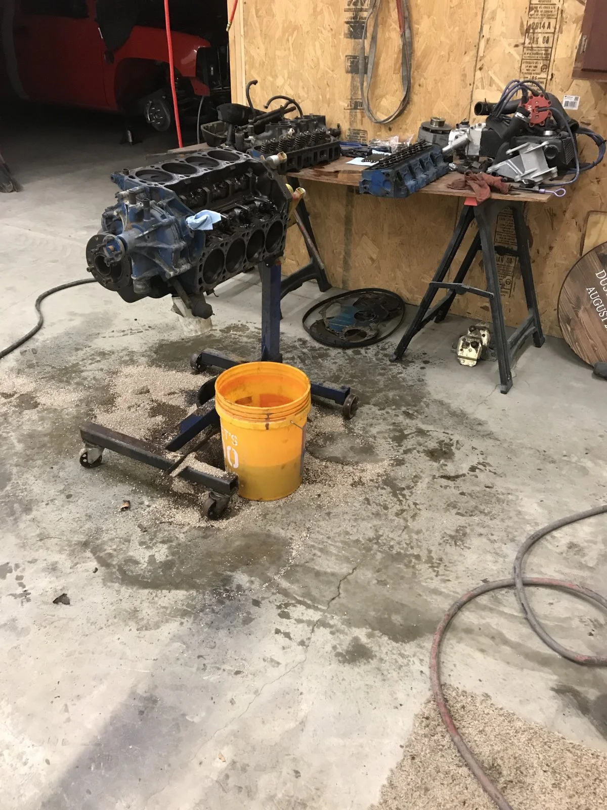

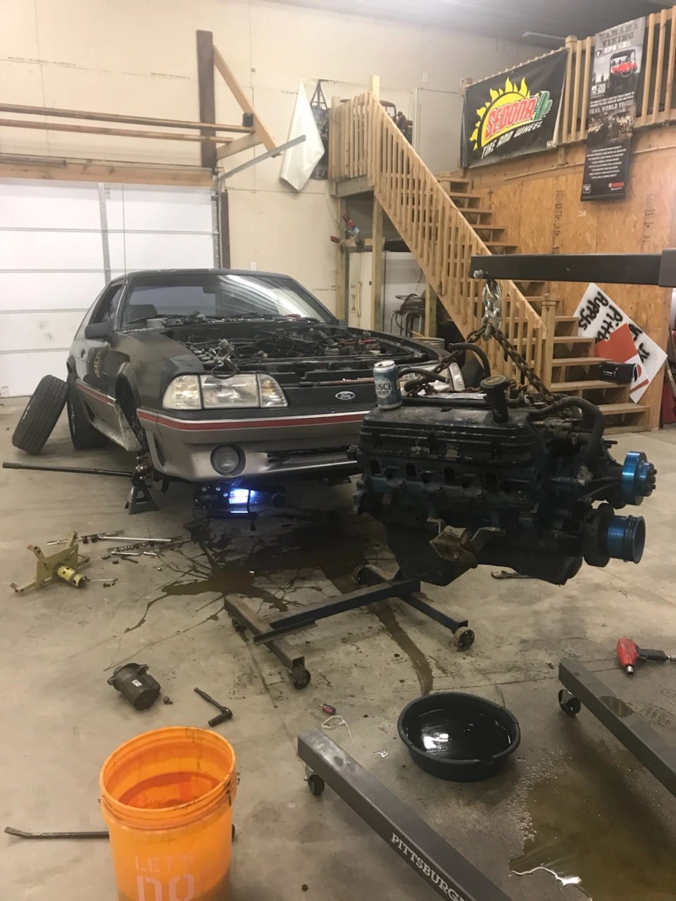

I figured i may as well start a thread to track my progress. went and got this car last monday. took it to the state inspection place yesterday at 2. got home at 530 and had the enigine out by 845. ready to start cleaning and disassembling. glad to have some of the people here giving me some much needed and helpful info. wanting to do a few things to this block and run a ON3 kit on it.

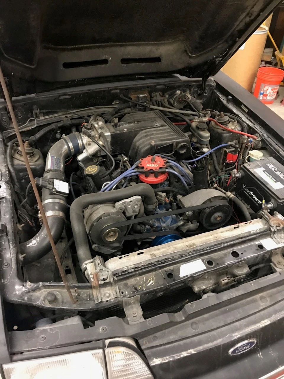

That's a good project. With going turbo I'd t take the blue underdrive pulleys off and source factory ones . There's more heat associated with a turbo engine and turning the water pump slower wouldn't be a great idea.

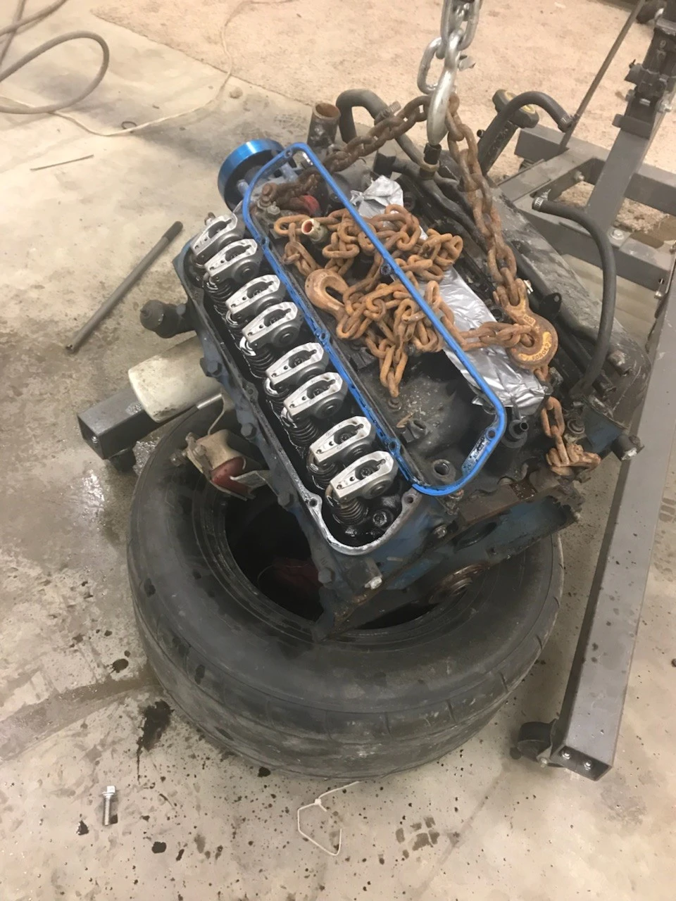

Looks like comp cam roller rockers ?

yeah i already did that. my buddy had a stock set laying around. i hate under drives. im gonna clean the enigine bay up. thinking of head studding it and maybe a main girdle. im glad i took it apart. it only had three bell housing botls in the thing.

I girdles mine... the only thing it might do is save the housing assembly if the block cracks. The block usually starts cracking above the cam in the valley.
Even a valley girdle may fail at over 500hp. If I did it again I'd get a dart block...or 351. Good 351 blocks are hard to find. They get cracks in the cam bores. Never seen one split all the way though. The 351 will hold 700hp which is more than we can put down on the street.

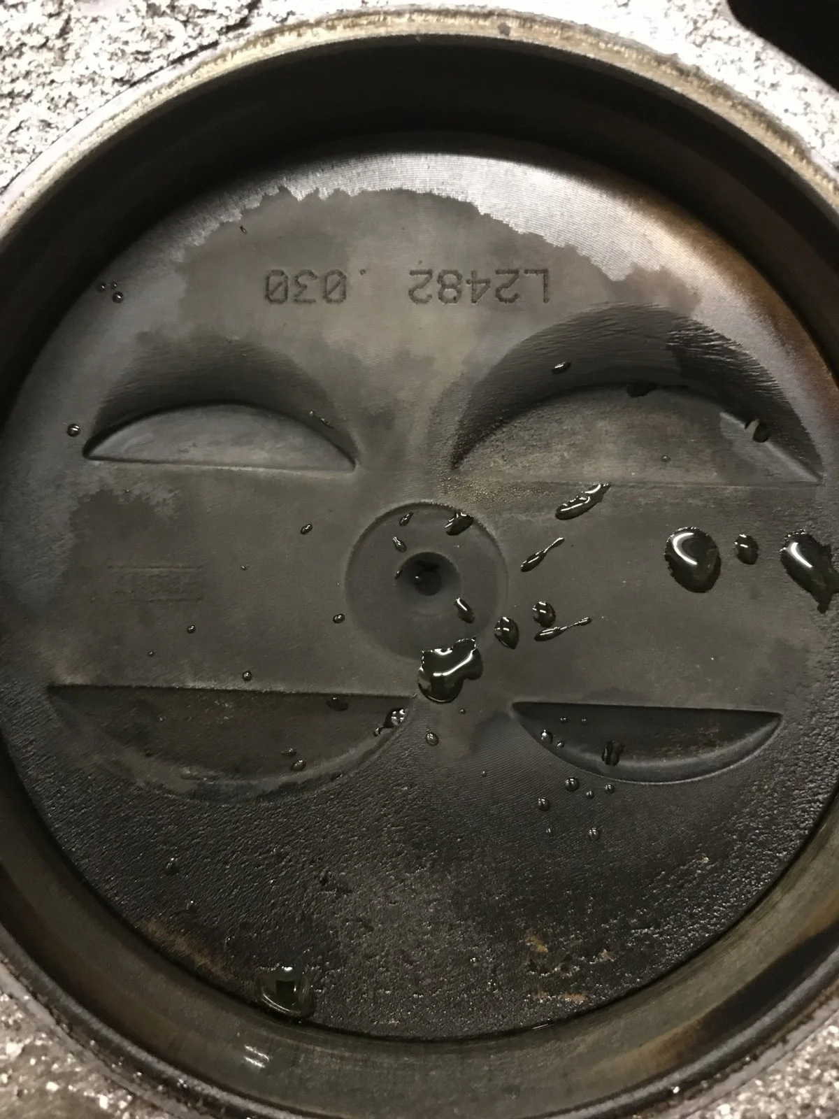

If it were me, I'd stop right there. The engine has already been rebuilt. It has TRW ( now Speed Pro) forged pistons in it already.
It's been bored .030 as indicated by the piston.

#20
