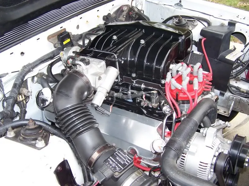

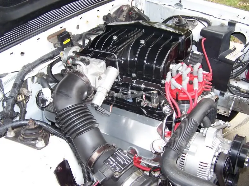

Let me echo everyone else in saying that your welding skills truly rock! If you want to know what they will look like powdercoated clear then here you go.
I bought a set of ProComp Electronics sheetmetal valve covers from a local vendor at WFC 9 in St. Louis and had them powdercoated clear. I had heard that earlier clear powdercoatings yellowed after a while. My friend that coated them in St. Louis (RNMHRD on STL Mustangs if anyone in the area needs powdercoating...he is awesome) assured me that advances in powdercoating had eliminated that problem. Well as you can see they came out great. They were bare and unpolished prior to the coating and they still look the same way over a year later. All I do is run a clean wet rag over them to get the dust off.

i used the engine enamel clear coat. i hope it works good i will put a couple coats on it.
silvrbulithed that engine looks good. i outa paint my typhoon black before i put it back on.
