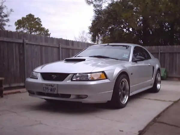

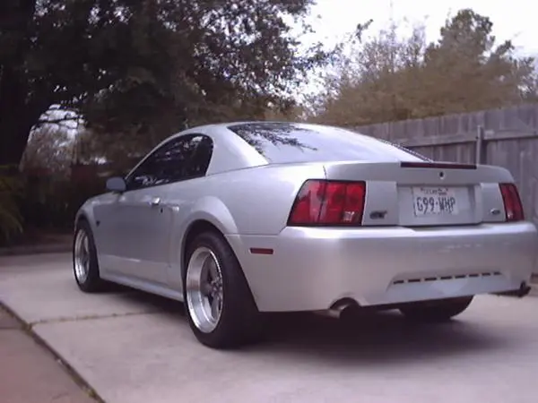

I have Wheel Replicas 17x9,17x10.5 with sumitomos 275 and 315's with Motorsport springs and a Flowmaster cat back. They have never rubbed on anything. I purchased the whole set from WR for $629.
