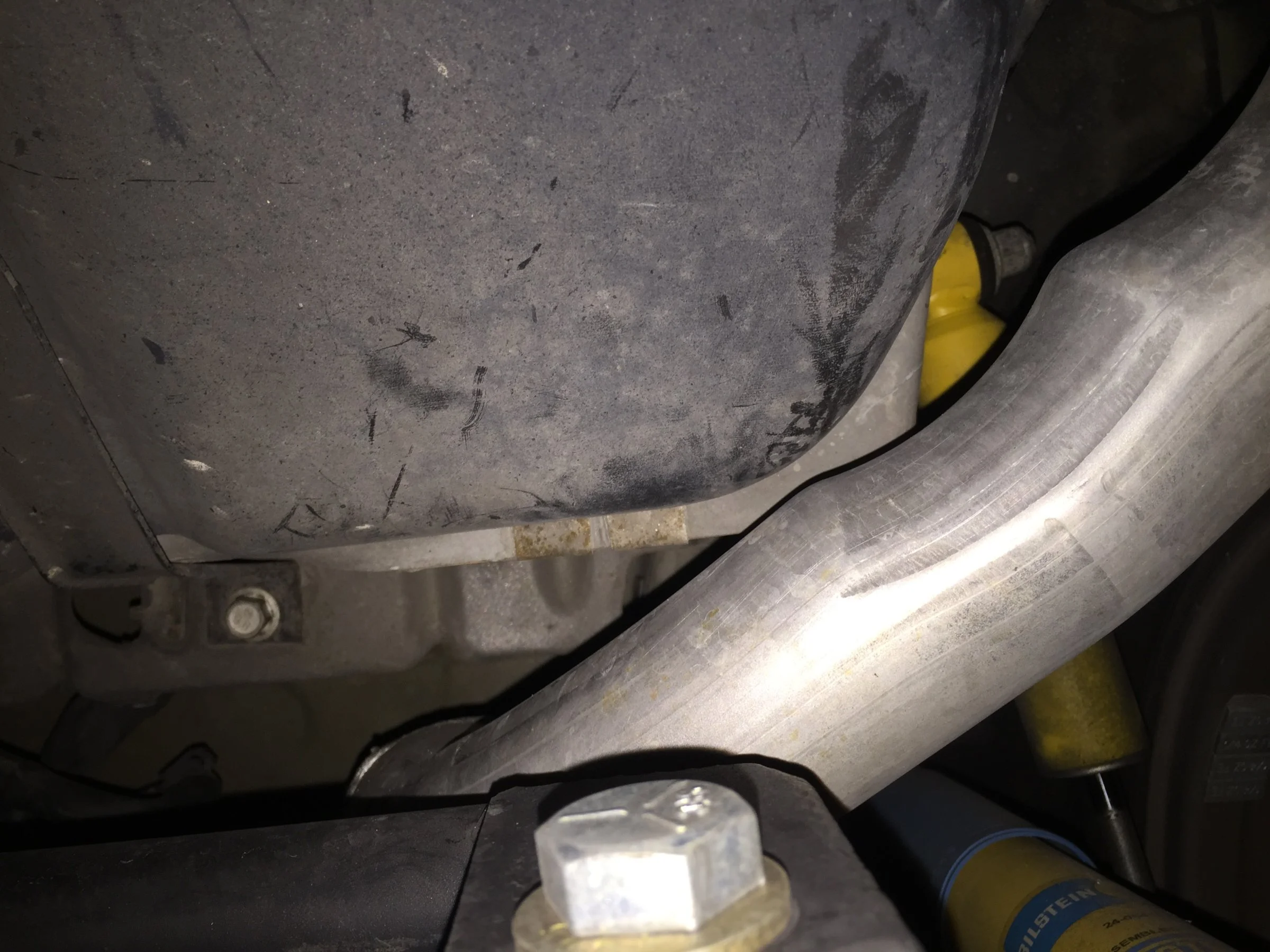

Without seeing the rest of the exhaust I can only suggest a muffler shop to shorten the distance between the over axel hoop and the bend for the tailpipe, it also may need the bend for the tailpipe tweeked a little.
Or you could do it yourself.
My borla catback is a good 6” away from the rear sway bar. See if you by adjusting the pipes going over the axel to see if a minor change in angle can make some space. Worst case a muffler shop can re-route them.

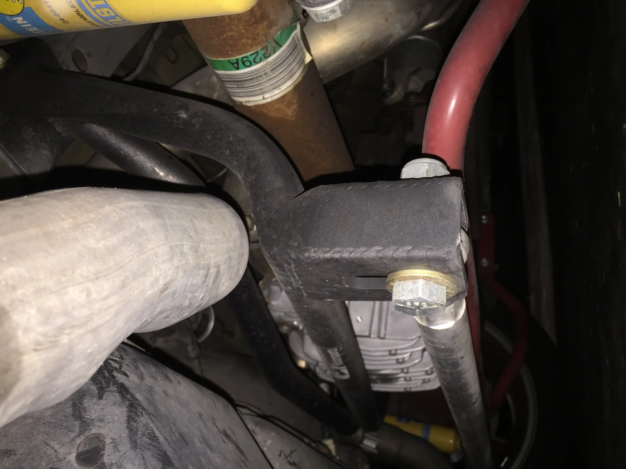

I checked and its all tach welded. its only on the passenger side. my stock sway bar did not hit. The new one is bigger OD.
Maybe you could bend a hanger downward to lift the pipe and muffler upward. I the hopes it would clear it over the bar. I had the stinger cat back on my old 04 gt with eibach bars. Never had a problem. Thers probably some adjustment somewhere in there.
@Dark04GT what cat back exhaust do you have with that phb? I've been told there are clearance issues. Otherwise I'd put one in the mach.
Borla stinger. Had the PHB installed - driver side cat back went back on just fine with plenty of clearance.
Passenger side....... had to drive straight to a muffler shop. Right after the “over the axle” loop the exhaust directed exactly where the PHB goes. The muffler guys laughed but then they were able to custom bend the pipes on the passenger side to put the tail pipe back on. Works perfect.

I still need to get the rear situated. Sway bar hitting the exhaust.

Perfect thanks. As for the exhaust hitting the sway bar. What about slotting the bolt holes on the sway bar 1/2 inch so it would move the sway bar away from the exhaust? it would move the bar forward towards the front.
I would redo the exhaust piping before I would make any changes to the sway bar. Any good muffler shop should be able to do it with no more then 1-2 hours of labor. The other option is to get a different brand of sway bar.

Another thought about your exhaust / sway bar issue. The flange that bolts the catback to the mid pipe has a slip fit connection after it. You should be able to loosen the rear tail pipes from the front pipe/muffler assemblies, loosen the band clamp that is behind the mid pipe connection flange and slide the whole muffler assembly forward, toward the front of the car. Then tighten the front band clamp up, readjust the rear tail pipes to fit correctly and tighten everything down again.
I had the same cat back and oversized Eibach sway bars on my 04 GT. There must be a simple answer for this.
I even blew up the picture of the catback to double check that its a slip fit after the flange, on Americanmuscles website. If you look close you can see the grooved end of the front pipe /muffler assembly, where it slides over the flange pipes that bolt to the mid pipe. I don't know how long your pipes have been installed so it may take a little persuasion to get the pipes to shift around but wd40 and mallet ought to do the trick.
