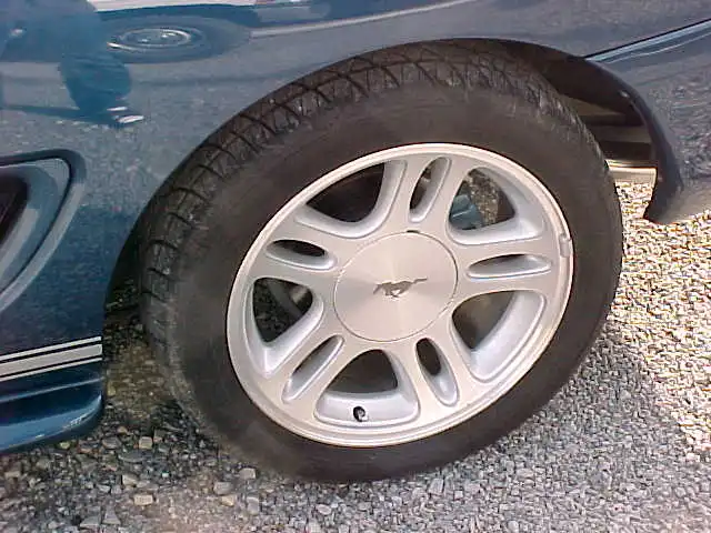

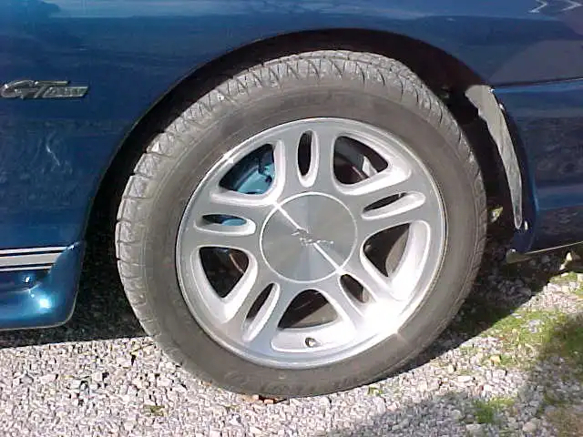

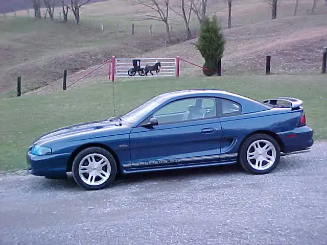

Here are a few pics of my ride with the Bullitt set-up:
The bottom two pics were taken just before Thanksgiving, and the 1st one was taken in early Spring.

stangit yor car looks like the bullitt system droped your car pretty well.
~1" drop all around. I have used this set-up since Oct. '02. Like others have mentioned, the drop is more substantial on pre-'99 cars. I would like an extra .5" in the front; however, you can definitely tell it is lowered when you pull up beside a stock GT. IMO, the ride is much stiffer than stock (I have a few interior rattles, now), but I have been in only 1 other lowered stang (it was equipped with progressive rate springs).
